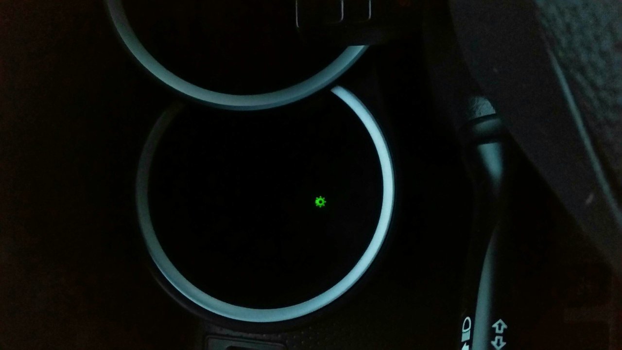

    So my abs, ebrake and traction control lights come on and stay on for awhile and then randomly go off and come back on. Any ideas? So now the weird part since this started happening tonight my headlight indicator light is on all the time is dim when the head lights are off but it's still lit up any ideas on this?

    The headlight indicator light has to be a wiring issue if I unplug my headlighys the light is still on it I pull the replay then the indicator light goes off any suggestions on where to start?
    The abs ebrake and traction control light is probably a wheels speed sensor is there a way to find out which one is bad without replacing them all?

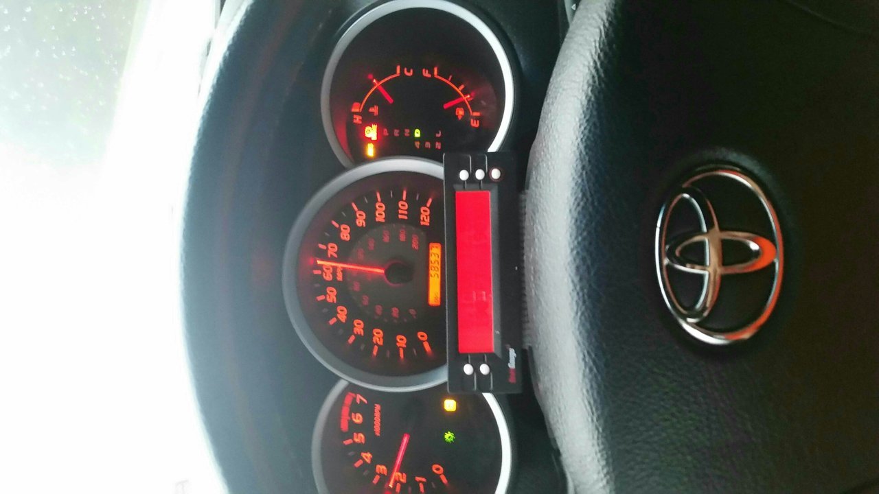

    So the lights all came back on. So this is what I think I know all the lights coming on are related I don't think the sensors are bad for the abs. What causes the lights to come one is water
    The last time they came on it was raining. They have been off for over a week but last night I drove the truck and it was raining and they started to come back on. Anyone have any ideas now? Gonna pull out my led headlights tonight and put back in the factory and also run an grab a new headlight fuse. Any other suggestions

    Not an expert here just my thought's but from what you are describing I really don't think that the actual entire headlight assembly and or fuse for that matter is the problem.
    It appears as though each time it rains (does it also happen after you wash your truck?) there seems to be a build up of either moister or condensation somewhere along the wiring, connectors, relay's, etc. that is (effecting the circuit) causing this to suddenly occur?
    That is where I would start. This is why I asked you on my first post if you recently had done any type of electrical work on your truck, doesn't matter if it was weeks or months ago if it's going to happen, it will and it appears to be the case.
    Like I said I maybe incorrect about this but this problem has been known to happen in electronics, even to the point, over a period of time, of causing the electrical system to short out.
    Maybe think about using some of this on connectors, wiring, relays, etc.?
