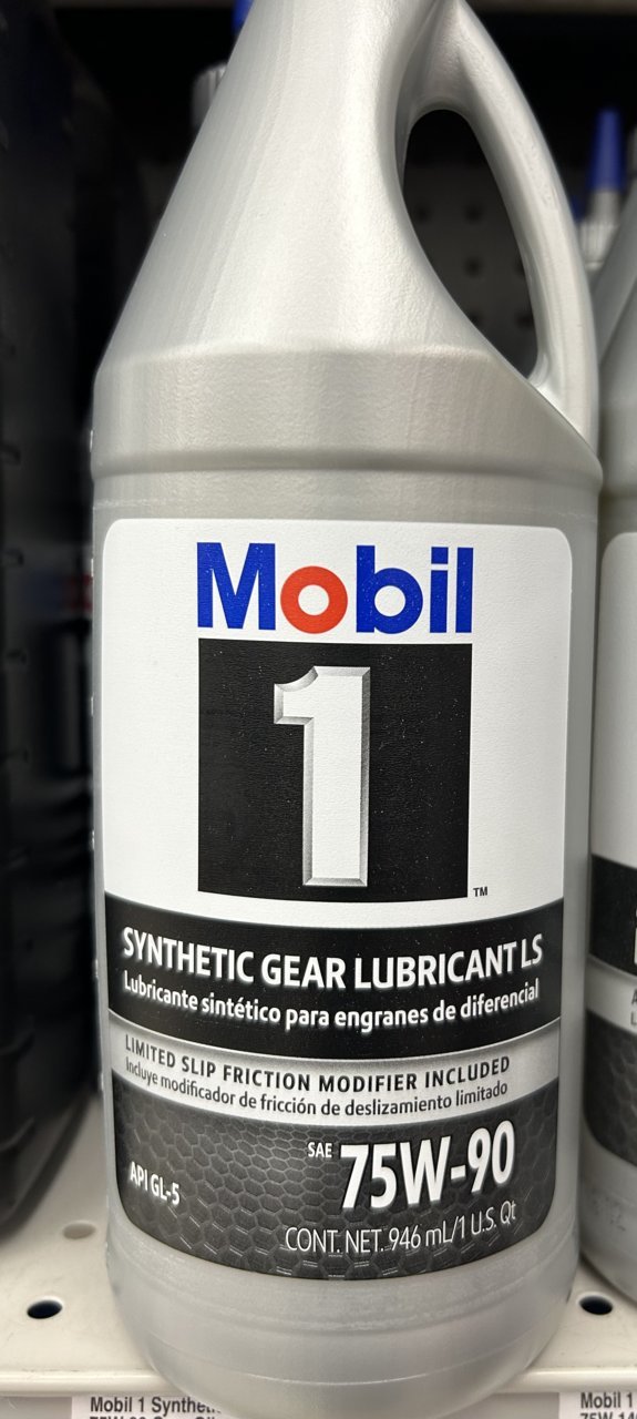

    Hello guys,
    I’m planning to change my differential fluid for my 2007 Tacoma PreRunner. I called the nearby Toyota dealer and they told me my truck doesn’t have limited-slip differential.
    After looking at the user manual, I see the recommended oil to use from manufacture is hypoid gear oil API GL-5 SAE 75w90 but I couldn’t find any at nearby AutoZone or online. Most of them will come with limited slip friction included.
    My question is, is this the right one? Thank you

    Yes, that gear fluid will work fine. It’s what I first put in my 07 many years ago. I now put Valvoline synthetic cause it comes in a squishy bag and is very convenient to use as you don't need a funnel or pump.

    That is fine but I would recommend you buy the squeeze bag 1qt from Valvoline as it will make it easy to pour.

    Doesn't hurt to have the LSD additive if your diff doesn't need it, although you are in a way paying for something you are never going to use.
    Another option is to see if any big truck shops in your area carry Mobil Delvac 75W90 which comes in more economical gallon size jugs and does not have LSD additive in it.

    I just bought some of that mobil 1 gear oil along with this hand pump.
    Slippery Pete Fluid Pump for QUART BOTTLES - Transfer Gear Oil, Transmission and Differential Fluid With This 5cc Hand Pump (NOT FOR Red Line Quarts!) (1) https://a.co/d/0bYDj23
