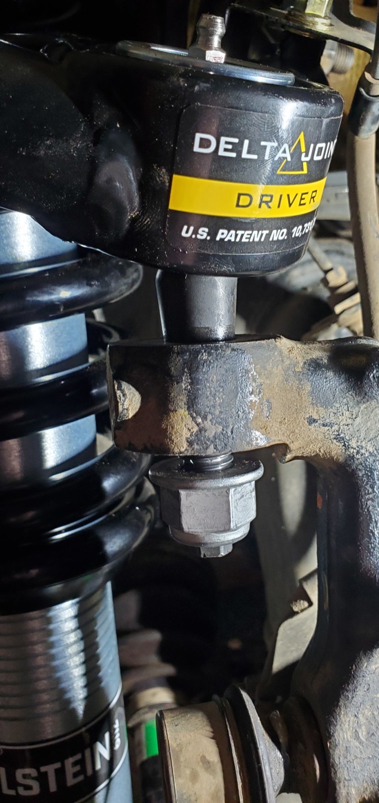

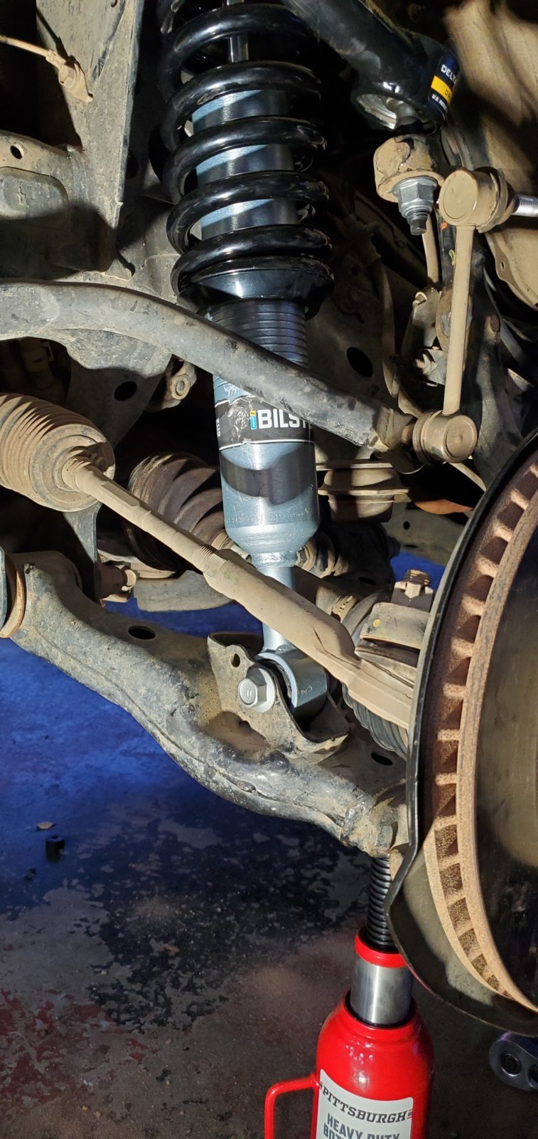

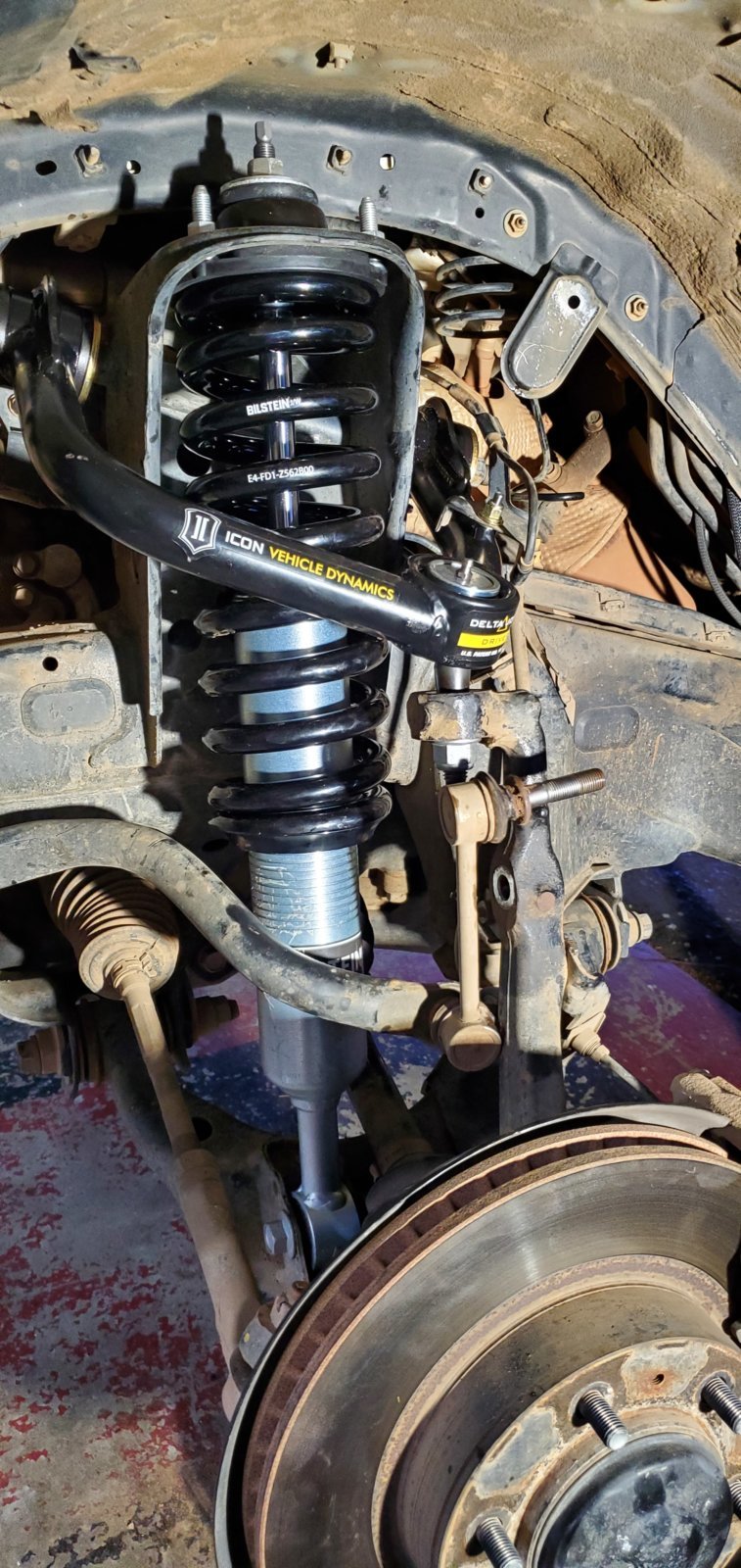

    I need some help. It has been a while since I was on TW and I hope this is the correct forum to be using for this (please let me know if it is not). So, this morning I started trying to install some Bilstein 6112 front coil overs and some Icon Tubular UCA, during this whole process I have been having trouble getting the Lower Control Arm to move very much, and now it seems to be completely locked up. If I put a jack under the LCA it just starts to lift the whole front corner of the truck. I have loosened the bolts and nuts that connect the LCA to the frame (the ones that effect the alignment cams). Any help would be greatly appreciated. Here are some pics of what I have going on. Thanks in advance for any assistance.Front Suspension.jpg LCA.jpg

    Could it be that the coil adjustment is set to highest setting? At least, that’s what it looks like, plus new coils. Also, no UCA BJ boot?

    Yes, it is at the highest setting. Yes also new coils, heavier ones because of the added weight in the front. I have no idea what a UCA BJ boot is, lol.

    Sorry, I guess I am still not following. My primary problem is that the LCA will only move about 1/2" to 1", even with a jack under it starting to lift the whole corner of the truck into the air. As far as I can tell, the UCA is as low as it can go. Both the UCA and LCA are connected, but nothing is fully torqued down yet. The Spindle bolt from the UCA is not tightened down to the steering knuckle all the way either. Also the sway bar is not connected because it will not line up (this might be fixed if I jack up the other side to even out everything.

    Does the lower arm move freely with the coilover unbolted?
  10. Apr 13, 2024 at 9:20 PM
    Lobo84
    Lobo84 [OP] Member
    Apr 2, 2022
    #394090
    14
    Jeff
    Southern Washington
    2019 TRD OR DCSB
    Bilstein 6112 Coilovers, Icon UCAs, Bilstein 5160 Rear Shocks, Icon RXT Leaf pack, 265/75 R16 BFG KO2s, Tepui RTT, KB Voodoo Bed Rack, Custom Rack for 4 Plano Sportsmans Trunks, SPOD Switch system, Genesis Off Road dual battery system, Dual Odyssey group 34 batteries, Dometic Fridge, Goose Gear rear seat delete, Yaesu FTM300 Ham Radio, ARB Twin air compressor, and Gaia GPS on an Ipad so I can figure out how to get all this crap home safe.
    No, LCA did not move freely, and I think this is the sorce of my problems

    Well, maybe that is not totally correct. I loosened a bunch of stuff, and I got more movement in the LCA then I thought I was getting. Everything seems to be more or less in place except that the UCA spindle is not engaging the steering knuckle as much as I think it should (see pic) but maybe I just need to keep tightening that nut down. Also I cant reattach the sway bar bracket to the frame, but I think that is because I have only one side of the truck jacked up. I guess I am going to tighten everything back down (not torqued) put the wheel back on, then torque everything to spec (probably tomorrow). Thanks for listening to my problems everyone. I am willing to bet I will have other questions before this project is done.

    I may be reading this wrong, Did you remove the two bolts on the steering knuckle?Also, did you lose the UCA ball joint boot?

    Delta joint doesn't have a boot

    The ball joint boot. In your post, #11, that exposed portion of the BJ normally has a boot on an oem setup. Maybe this kit don't require one.

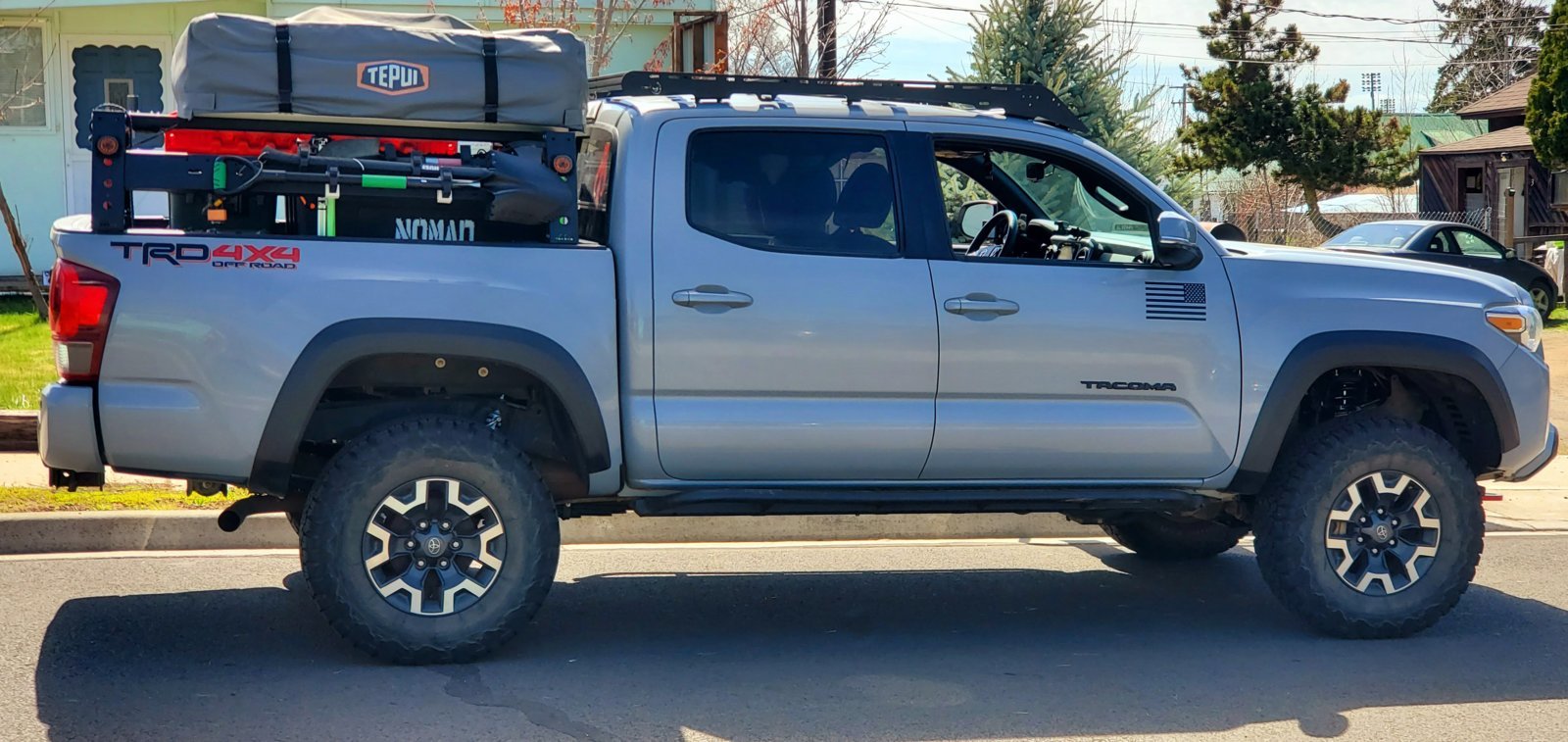

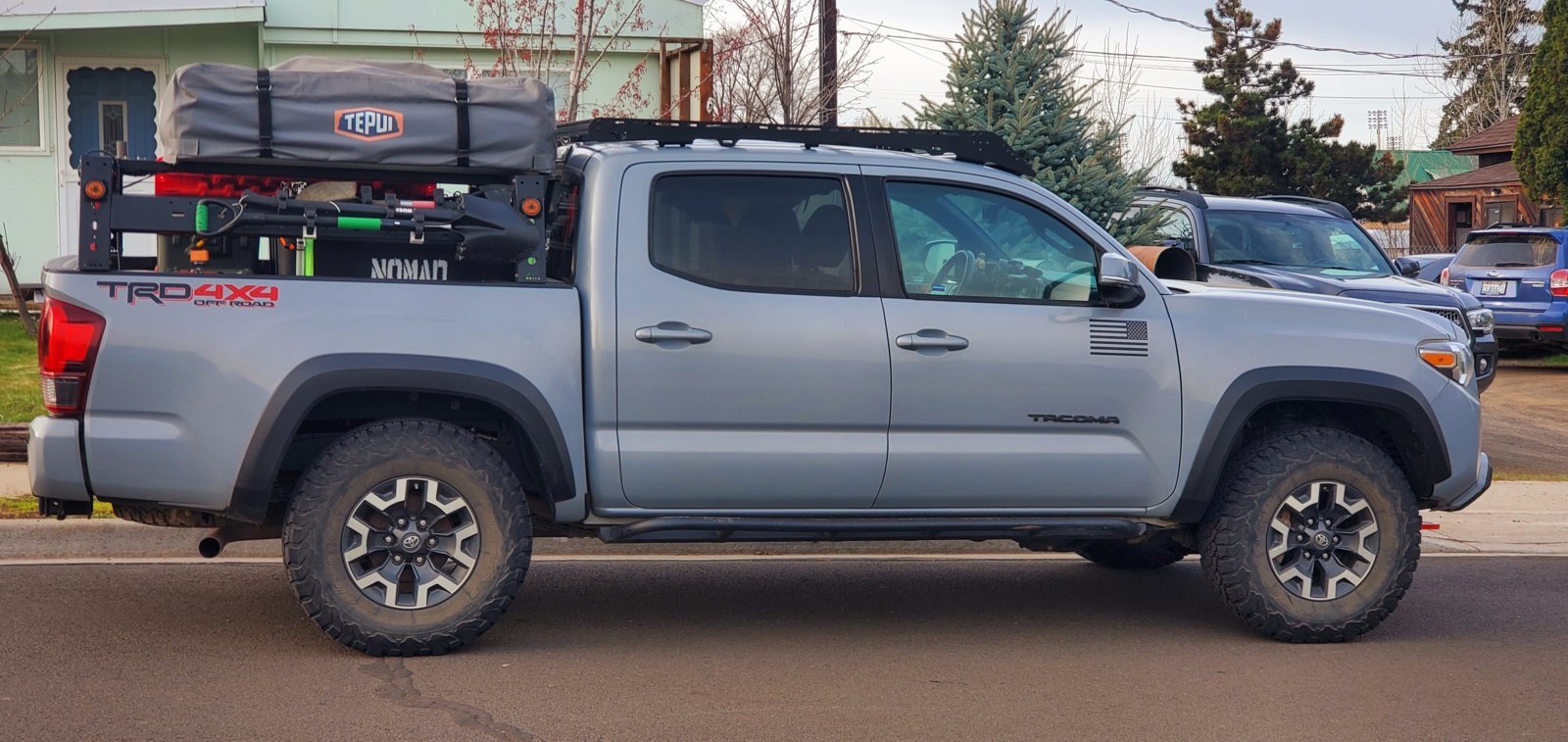

    Well, everything is back together! Truck is driving around, engaging 4x4, etc. Getting an alignment tomorrow, then I can really take it out for a test drive. Right now the truck is sitting pretty level, which is how I wanted it. I am going to get some miles on it and let the springs settle, then decide if I want to make further adjustments. I am really trying to not have to use a spring compressor to adjust the collar, but we will see. Just wanted to say thanks to everyone who offered advice on solving my problem. Looking back now, I don't think I ever really had a problem to begin with, it just seemed that those damn LCAs should have been able to go up further, but I'm new to suspension stuff so I think it was just a problem with how I was looking at it. Here are some pics.
    Before
    After
    ricco333 and Chew like this.
  20. Apr 14, 2024 at 5:20 PM
    #20
    Chew
    Chew Not so well known user
    Mar 6, 2019
    #285575
    8,388
    Chewy
    Midwest
    19 TRD OR
    Amazon dog poo bed mat mod
    You got rid of that saggy rear. looks great!
