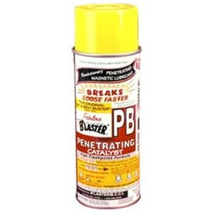

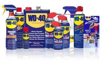

    And this

    or this..

    bunch of goons, anyways they arent greased from the factory so they seize up and they do not come apart no matter how much hitting or pb plaster. When I pulled mine I had to cut them out and replace them with new ones. Its really common to do so

    mine were seized pretty good as well durung my LT swap..nothing that some WD-40, a 3lb hammer, and a brass drift couldn't handle. no need to cut anything, only goons resort to cutting stuff off lol
