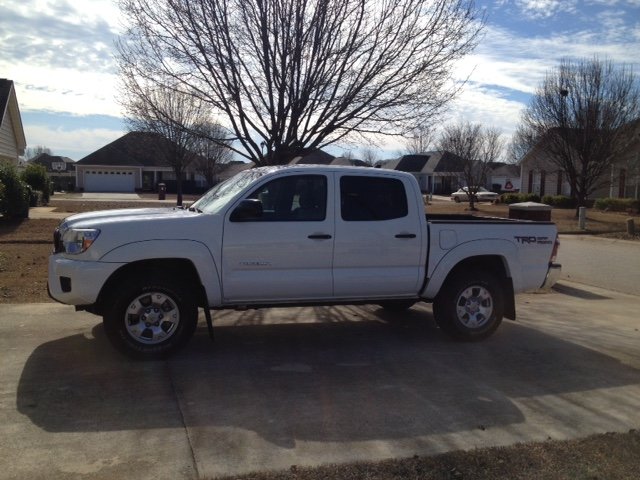

    I have a stock 2014 TRD OR Prerunner. Its about time to replace the tires so I'm thinking about doing a lift, wheels and tires together. I don't do any wheeling. I'm 98% highway driving. I do go to mountains for hiking every year so for a week or two I might be driving fire roads, mountain roads or river access roads. Also I drive a lot for work about 25K miles/year.
    I was originally thinking of doing a small 2"-2.5" lift, like 5100's at 0 w/884's and AAL, w 265/70/17's. I don't want to have to replace UCA's and going with the 265's shouldn't affect mpg's much if at all.
    Then I noticed the Maxtrax Spindle lift. Looks nice, suppose to maintain factory geometry and ride, and I think it could fit 285's.
    I need help picking which lift or if I should even lift it at all. My DCSB has handled everything with ease in stock form, but I like the lifted look. I dont mind a stiffer ride but dont want to deal with vibrations,parts wearing out, or the truck wandering while driving.
    I drive mostly highways at 80mph. Am I going to have any issues with wandering at that speed with either of these lifts?
    Which of these 2 lifts would you recommend for me?
    If I go Maxtrac, Ive readI would need wheels spacers for the rear, are there any other hidden costs that I should know about ie: longer brake lines, new shocks, etc.?
    Will the maxtrac allow for 285s without a CMC?
    Are there any negatives about the OME 884's w/5100s?
    thanks for any help.
