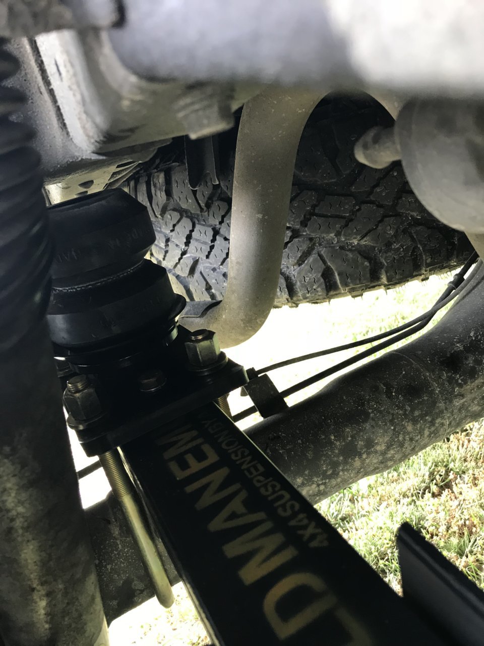

    I put 5100’s in front, set to 3rd notch and kept the OEM coils on. In back, I added 5100’s and a single leaf Deaver and kept the OEM overload leaf in to strengthen the rear springs. Overall, I gained 1.5-inches in lift, and have little to no sagging with my heavy platform, camping gear, RTT and camper shell. I also have Mobtown steel skids, Shmellmopwho‘s steel sliders and a Curt front receiver hitch. I still have OEM bumpers, and will not change those unless going to a upgraded coil in front. I also occasionally tow a 21’ travel trailer and load up 17 extra gallons of fuel in the bed for the truck sometimes for extended range while towing and it does fine. Unloaded ride both on and off-road is good too. @HeadStrong Off-Road recommended my setup for my low budget and it was a great choice. Call them- they are very helpful and have good service!
    Oh yeah, and did I say that my gas mileage sucks? :)

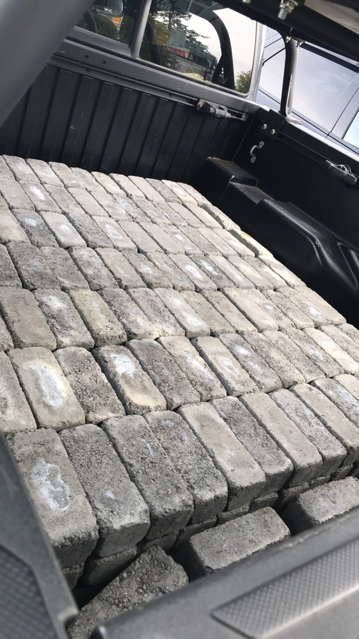

    It's very easy to hit capacity.
    Just yesterday, I took a load of scrap metal to the yard for my parents. I have a 4cyl 4x4 access cab, which is one of the lighter configurations available. Between the hitch, bed mat, front recovery point and gear in the truck, there is probably 120lbs added at all times.
    Me, my dad, the scrap and the truck was 5060lbs on the scale on the way in. The scrap ended up being 380lbs, so even without anything in the bed with 2 people we were almost 4700lbs.
    Shit if you have a loaded DCLB and add full armor, big tires etc you could conceivably hit max payload just by filling up the gas tank and sitting in it
    hiPSI[QUOTED] likes this.
