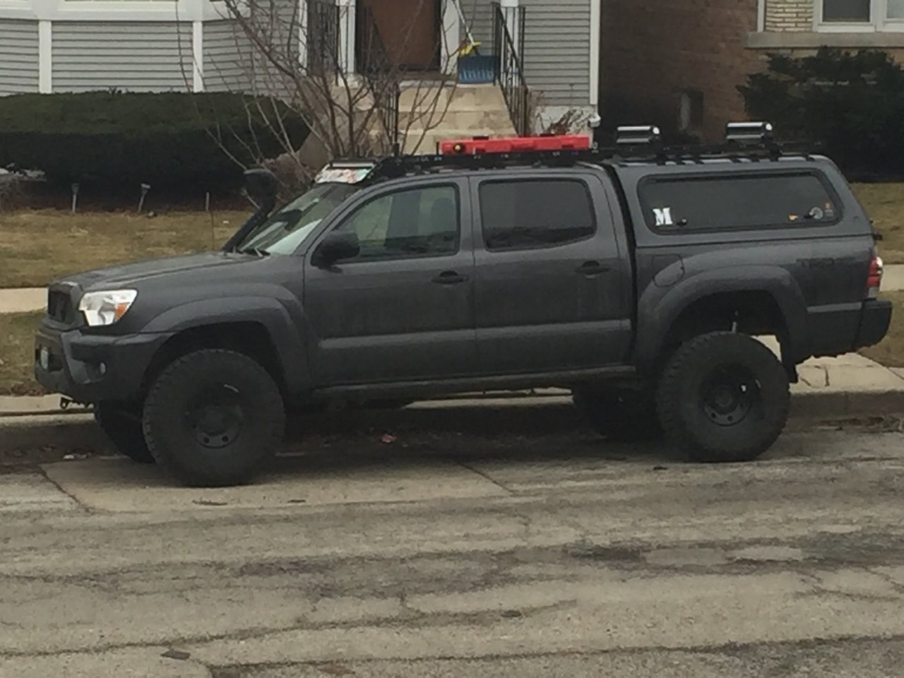

    Rake/stinkbug look is in :wink:
    It also allows for flexing:
