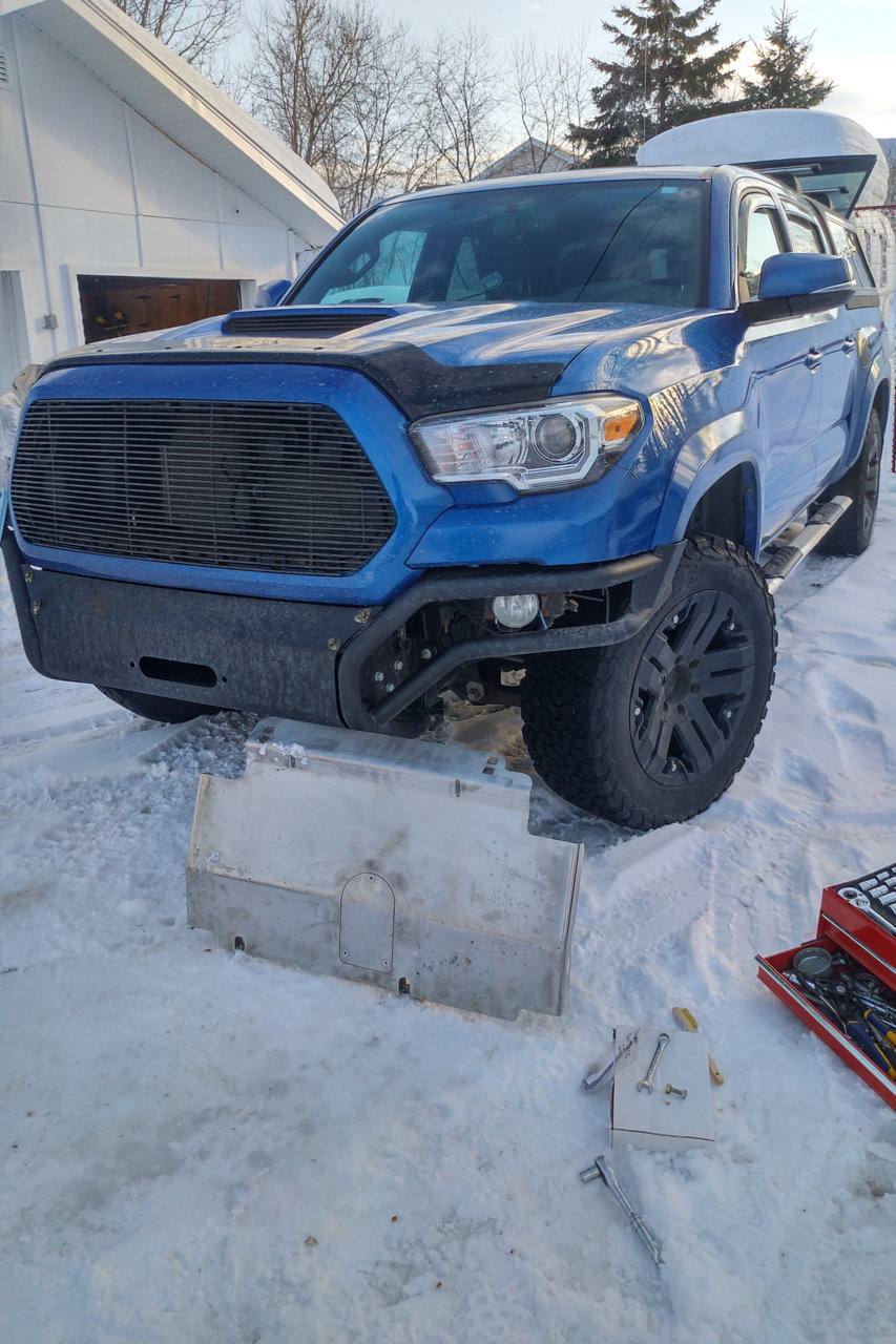

    My only contribution to your decision is to consider the way you intend to use the skidplate.
    If you're running high-speed it might be better to get one made of a softer material which can crush, rather than transfer energy into your frame. I tend to go faster (45-55mph) when i'm on those access roads and hitting a whoop wrong will smash that skid into the ground. I run an RCI plate in aluminum and the vertical mounting support was too rigid even with the aluminum, and crushed in part of my frame (thankfully only minor damage, not enough to cause issues). I cross drilled holes in the verticals of the replacement skid to ensure it would crumple as intended.
    For lower speed stuff, crawling and the sort, a stiffer material will do ya better as it will be used more for sliding over obstacles. It's a tradeoff.
