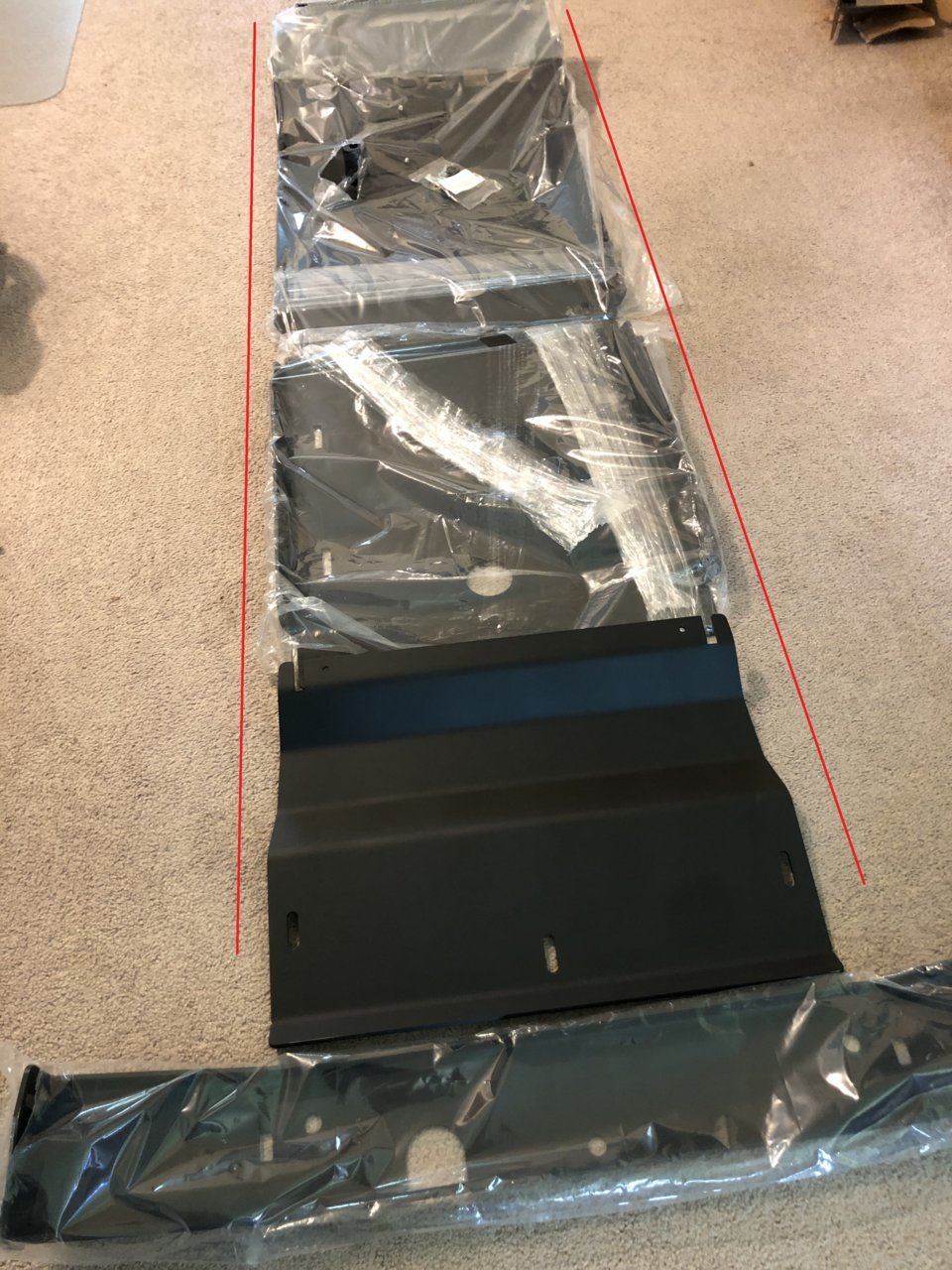

    I just bought a full skid package from RCI (and a fuel tank skid).
    No weird angles, no god awful logos, just a plain skid plate.

    Looks great!! Glad to see everything arrived to you safely! If you have any questions/comments/concerns, let us know.

    When are you releasing an extension plate for the transmission skid so it fits a 4 cylinder? ;) Hint, hint. Nudge, nudge.

    I have another question.
    What's the small access panel on the front skid for?

    I think that's for getting to the oil filter. Not sure which engine(s) have an undermounted one.

    I think the third gen.
