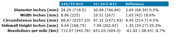

    Both the tires you linked too are sized 225/75r15. That's a pretty small tire (~28''). You should have an easier time finding tires in the 235/75r15 size, and it will look better if you are lifting the truck a little.
    The largest size you can fit without issues is 265/75, but naturally the larger you go the more power you lose. Your odo and spedometer will also read slower than you are actually going.

    For looks I would go with a 31'' tire (31x10.5r15)which is roughly the same as 265/75r15. For slightly better fuel economy, a 30'' tire would work.
    from the online tire size calculator
