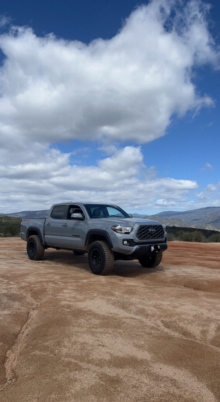

    Fedup13
    Fedup13 Well-Known Member
    Jun 3, 2017
    #220627
    504
    San Diego
    2021 OR DCSB 4x4
    I did the 6112’s and 5160’s in the rear, got me 2 inches up front. I’ve read that they have new 6112’s with a lot more settings so I’m not sure what you would gain from what settings. I’m also running 265 70 17 Wildpeaks on SCS wheels with a -10 offset. Rides great IMO
  3. May 3, 2022 at 10:18 AM
    #23
    BIGW0RM
    BIGW0RM [OP] Well-Known Member
    Sep 11, 2021
    #376793
    169
    So you just have the 6112 and 5160? No ALL lift in rear? Is this your truck and the wheels you mentioned?
  4. May 3, 2022 at 10:27 AM
    #24
    Fedup13
    Jun 3, 2017
    #220627
    504
    San Diego
    2021 OR DCSB 4x4
    Yes it is, correct no AAL. Considering an Icon leaf pack in the future.
  5. May 3, 2022 at 10:35 AM
    #25
    BIGW0RM
    Sep 11, 2021
    #376793
    169
    That looks level to me. Why get a ALL if its level? Doesnt the ALL make the rear higher? You stance looks perfect to me.

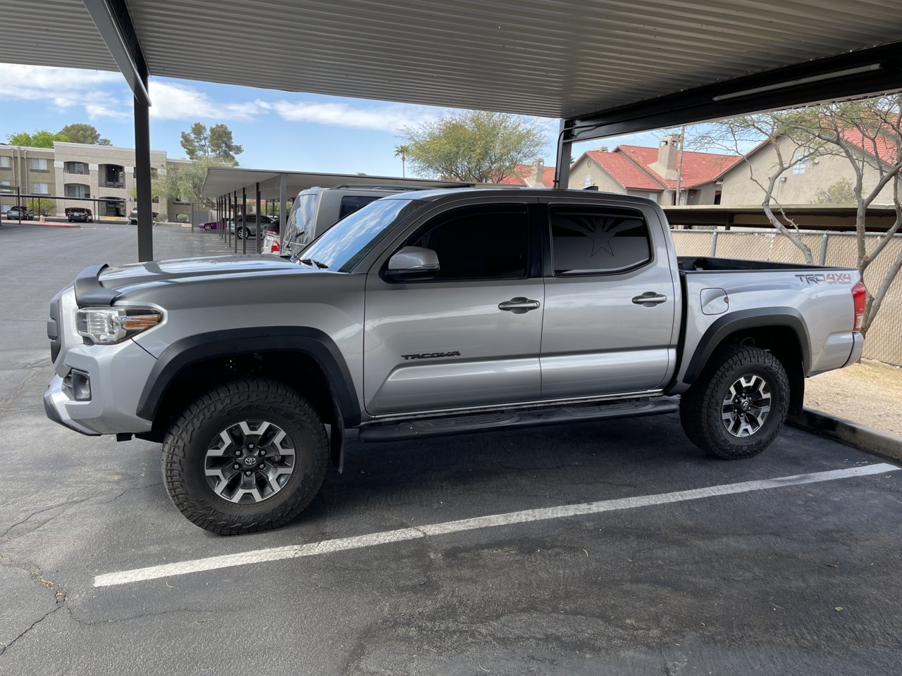

    AzChino520
    AzChino520 Well-Known Member
    Apr 13, 2022
    #394984
    112
    2017 TRD Off-road Silver Sky
    6112 Bilstein’s, 5160 Bilstein’s
    I'm on 5/4 perch w/ only 5160's on the rear and leveled front and back also on 265/75/16
    Fedup13 and BIGW0RM[QUOTED][OP] like this.
