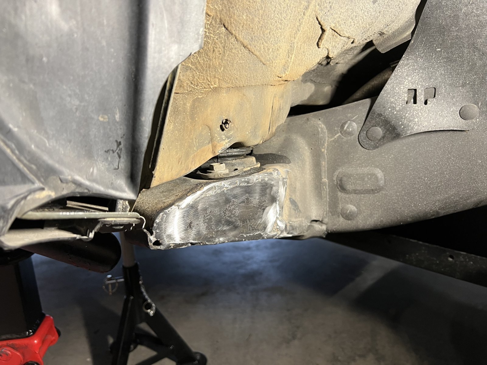

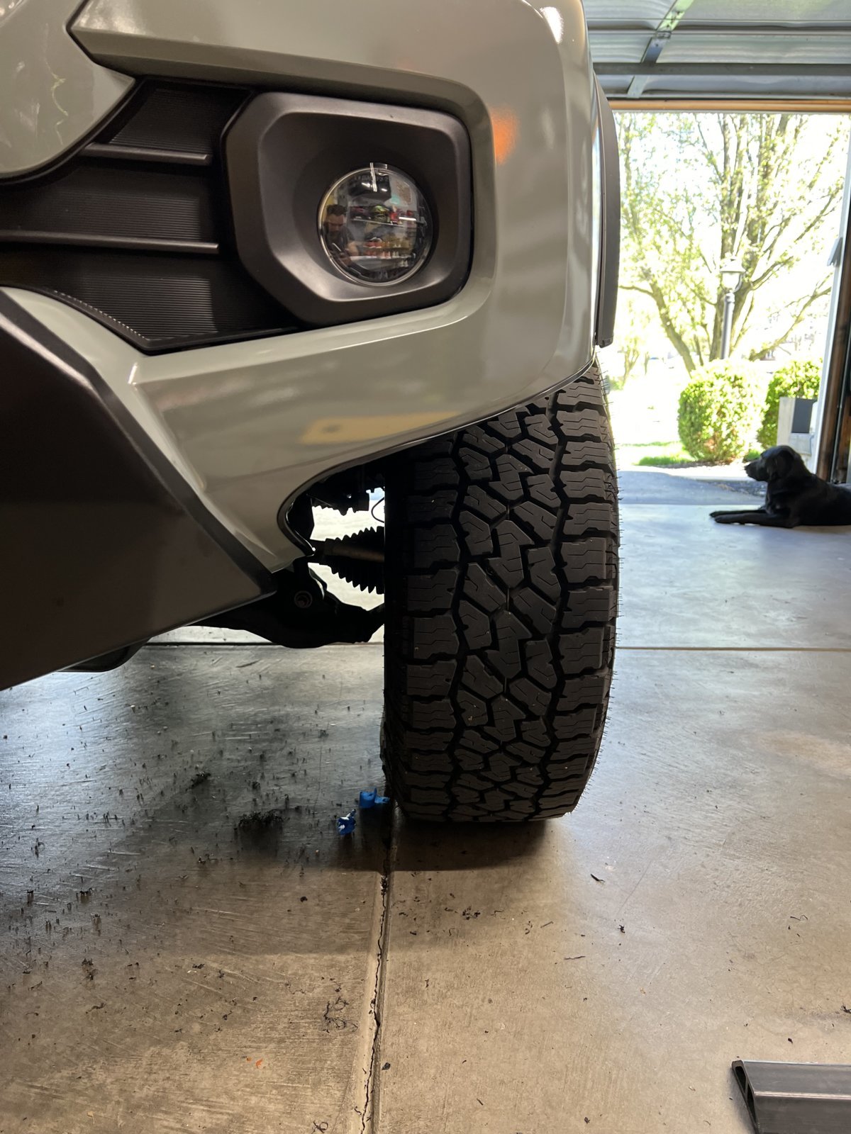

    Whatever you do, do not put a 275/70/17 and a 8.5 +0 wheel on a stock suspension Tacoma if you don't want to cut anything, ask me how I know....
    All jokes aside, I'm not even running stock suspension, but the eibach stage 2 kit, I'm at like 1.25in of front lift and I do clearance for off-road. Remember you're shoving your wheels out almost 43mm going from stock 16x7 +25 to 17x8.5 +0. So your front wheel arc swing is going to hit a lot more stuff than your stock wheels. You may end up with some tiny rubbing on plastics even with a 265/70/17 on the new wheel setup, nothing major though.

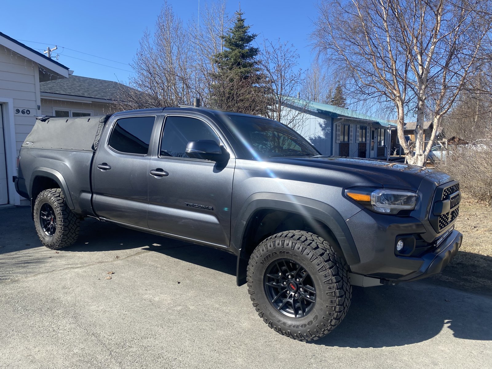

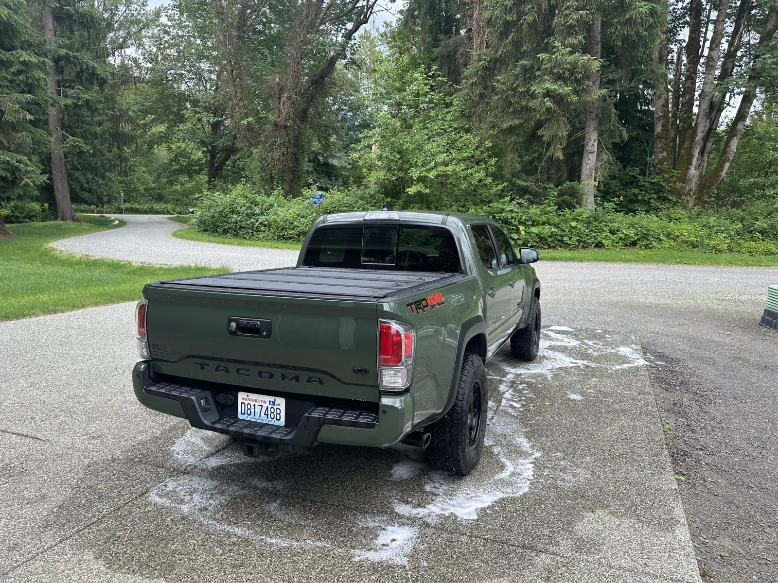

    Bone stock. It rubbed my mud guards slightly at tight turning so I took them off. If I did more off roading I’d lift it and go one size bigger. It’s about as big and wide as I’d go for road driving. Jouncing around on rutted out dirt roads it can rub here and there when turning but I don’t do it that often to warrant a lift

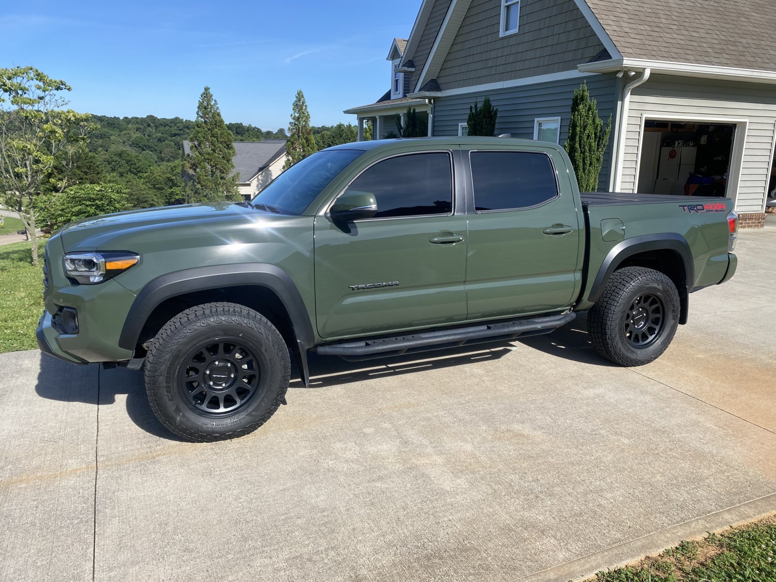

    Just had 17” 0 offset Method 703s installed with Cooper Road+Trail AT tires.

    Dang nice looking truck! What size tires are they? Can't quite see zoomed in.

    Thanks they are 265/70 17.

    Are those Oedros?
    Nice truck

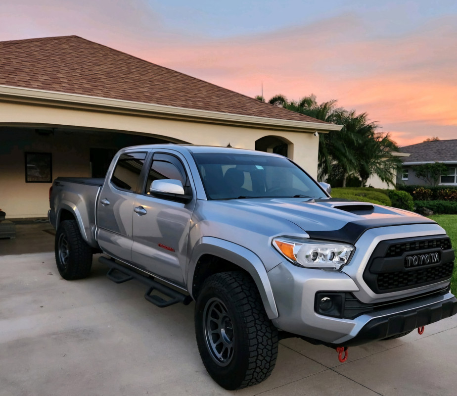

    Work in progress
    I think SCS wheels look amazing on Tacomas. For tires I like Toyo

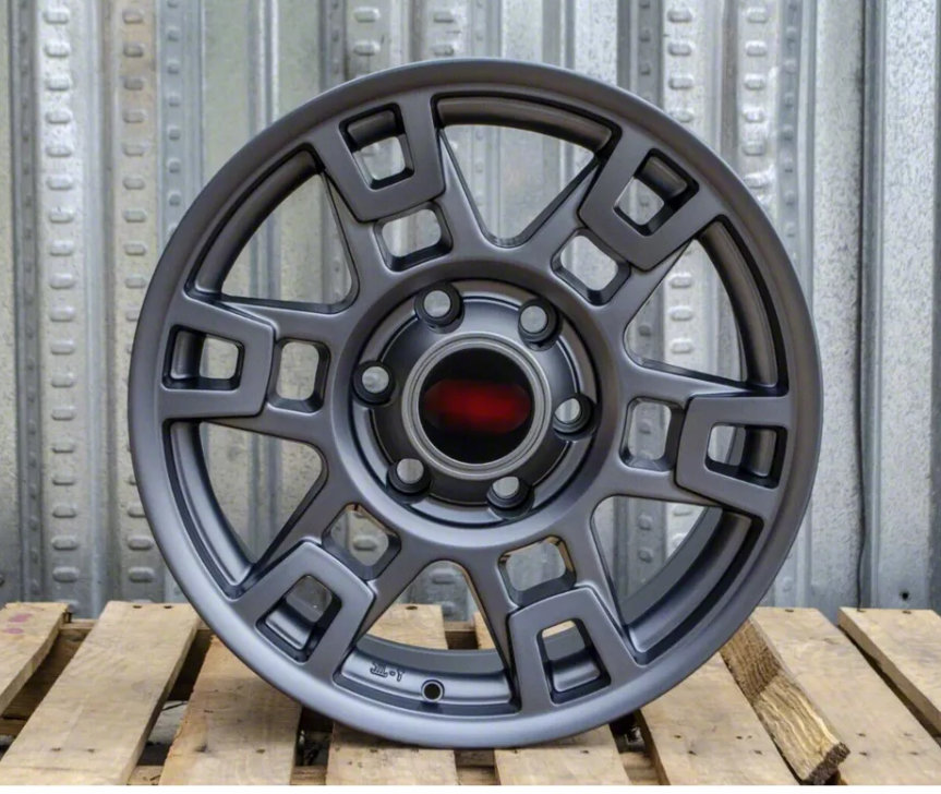

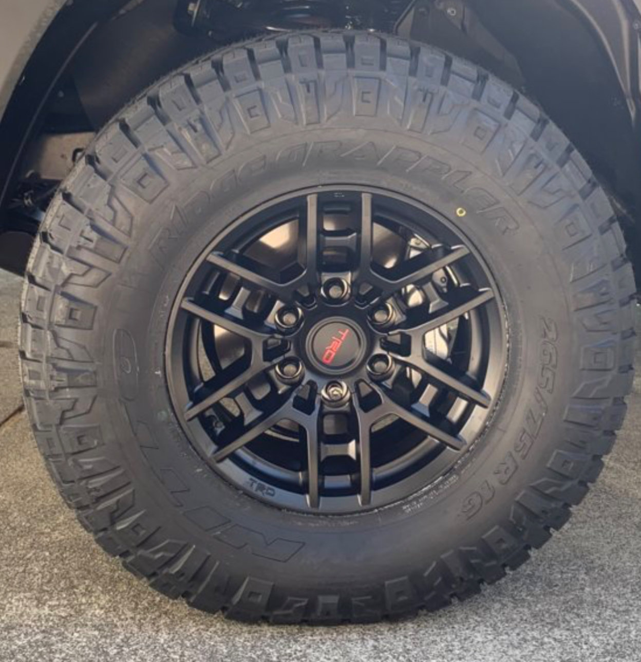

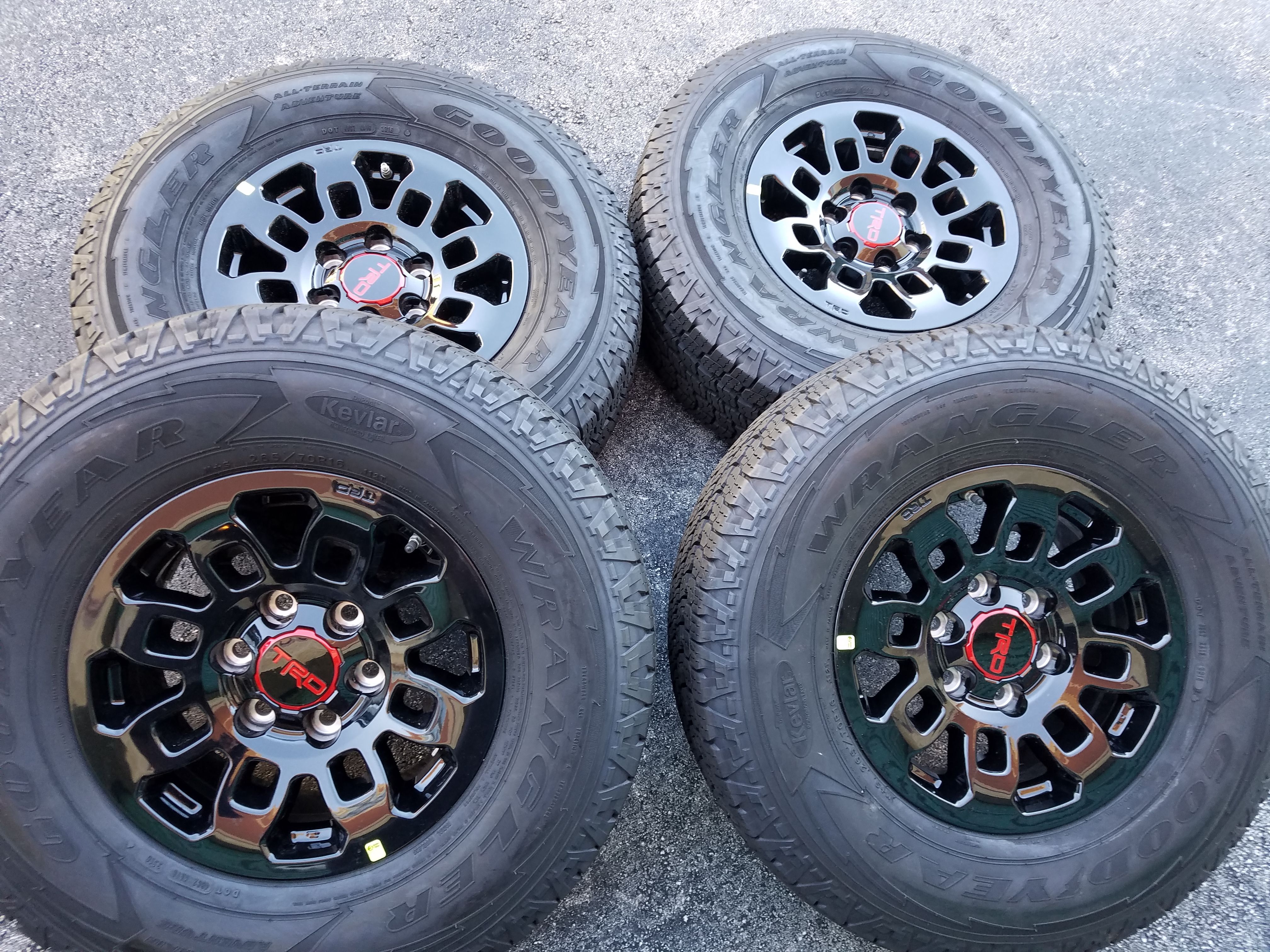

    OK so forgive my ignorance in this. Let me know if I got this right
    Sema wheels
    Pro wheels
    upload_2024-6-24_19-18-53.jpgAfter looking more into it there’s different versions??? Like 17-19 are gloss??
    Btw, a lot of posts that show the first picture of Sema wheels call them pros.
    I like the pros but I’m not a fan of spoke style wheels. I like the blockier style like the old Cragars

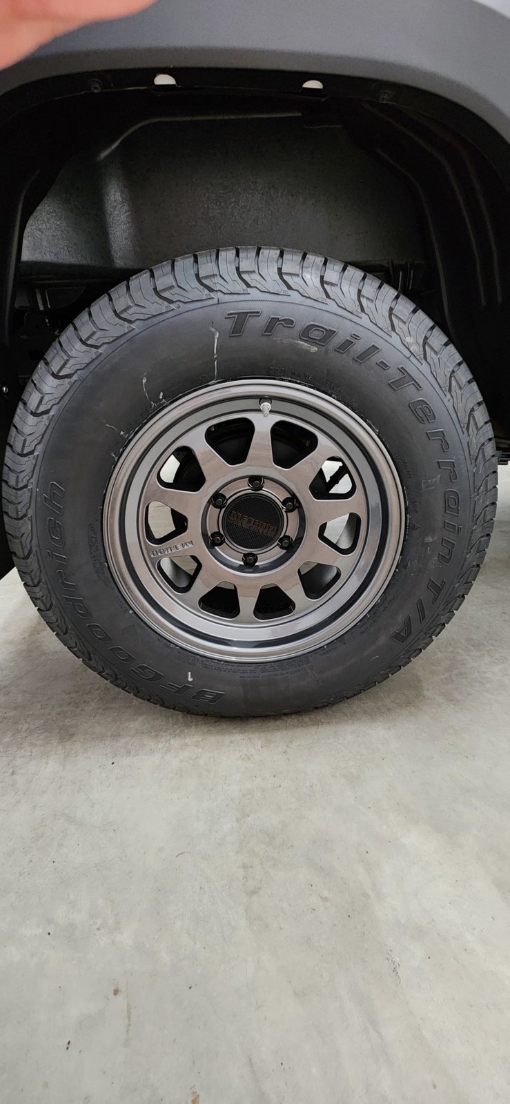

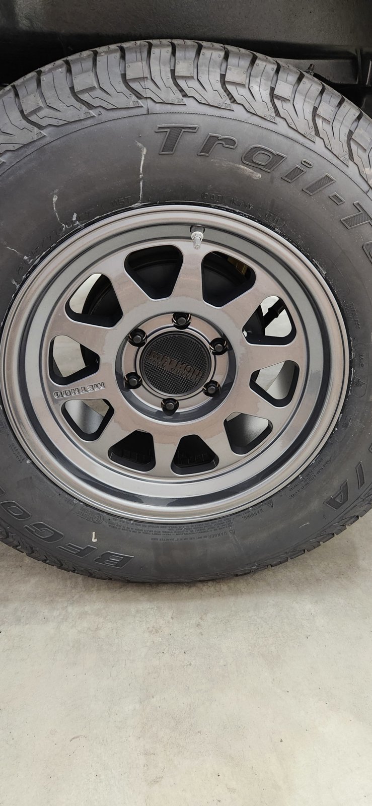

    Method 316s 17x8.5 0 offset gloss titanium. BFG Trail Terrain 265-70R17. Tires are fantastic. Great ride, quiet and no real mpg loss. I'd also look at the Goodyear Ultraterrains, they're a great option aswell. I've had 2 sets of Ultraterrains. Good ride, little bit of noise(not much), but you'll lose about 1-1.5mpg. Stick with 0 offset to avoid trimming and rubbing...

    I do kind of lind the titanium look on white.. Was wondering how it would look. Do you have any photos of it outside by anychance?
