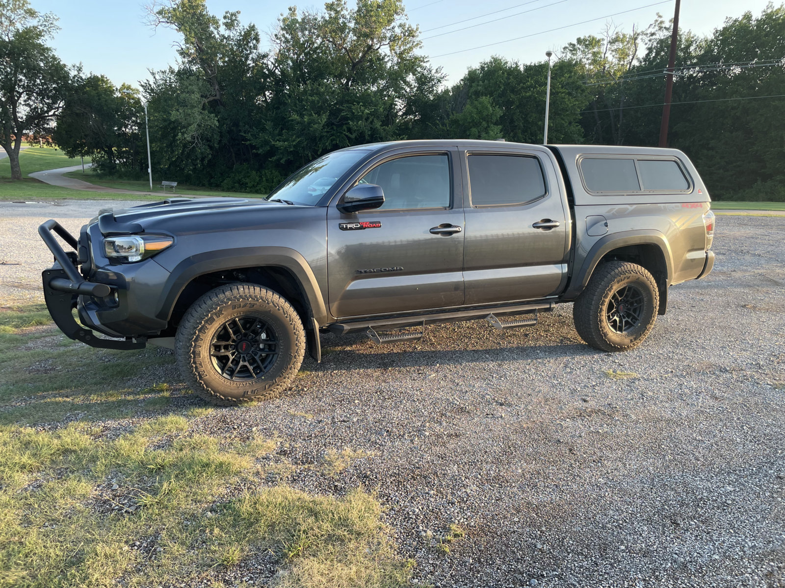

    Those Falkens are hard to beat. They look good. I'm seriously considering a set of the TRD Pro wheels for my next "upgrade."

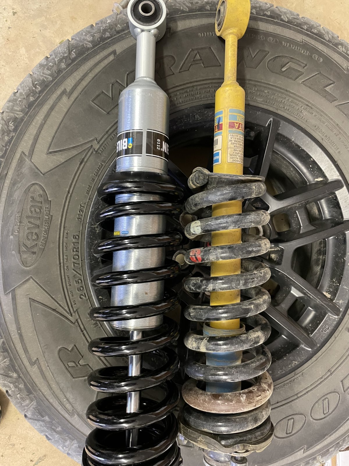

    Fantastic shocks. Over and over, outfits selling much higher end shocks would say "best bang for your buck - the Bilstein 6112 / 5160's". I've been 100% pleased and what a difference over stock OR's shocks. Guys who ride w/ me who have stock shocks say the same.
    The wrinkle is I have no lift on them, ordered assembled and installed myself. Tires are Falken Rubitreks (another great buy) 265/75/16. No need for lift and zero desire for one, too many negatives.

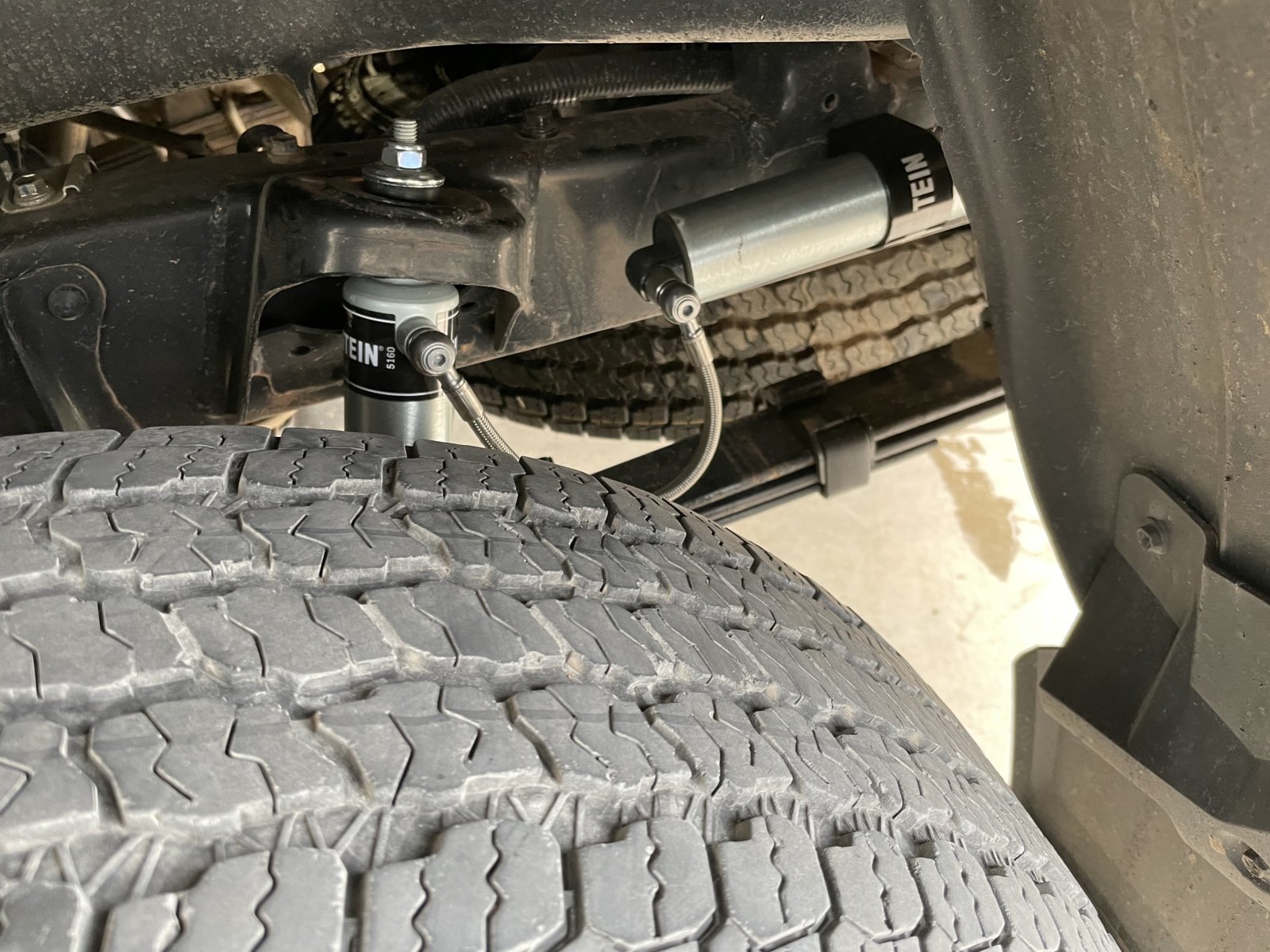

    2017 Tacoma TRD Offroad
    Appreciate the reply - do you have a photo by chance?
    Amorak[QUOTED] likes this.
  10. Jun 27, 2024 at 11:20 AM
    #50
    Amorak
    Amorak Well-Known Member
    Jun 27, 2021
    #369781
    348
    2021 Magnetic Gray Metallic Tacoma TRD OR DCSB Premium

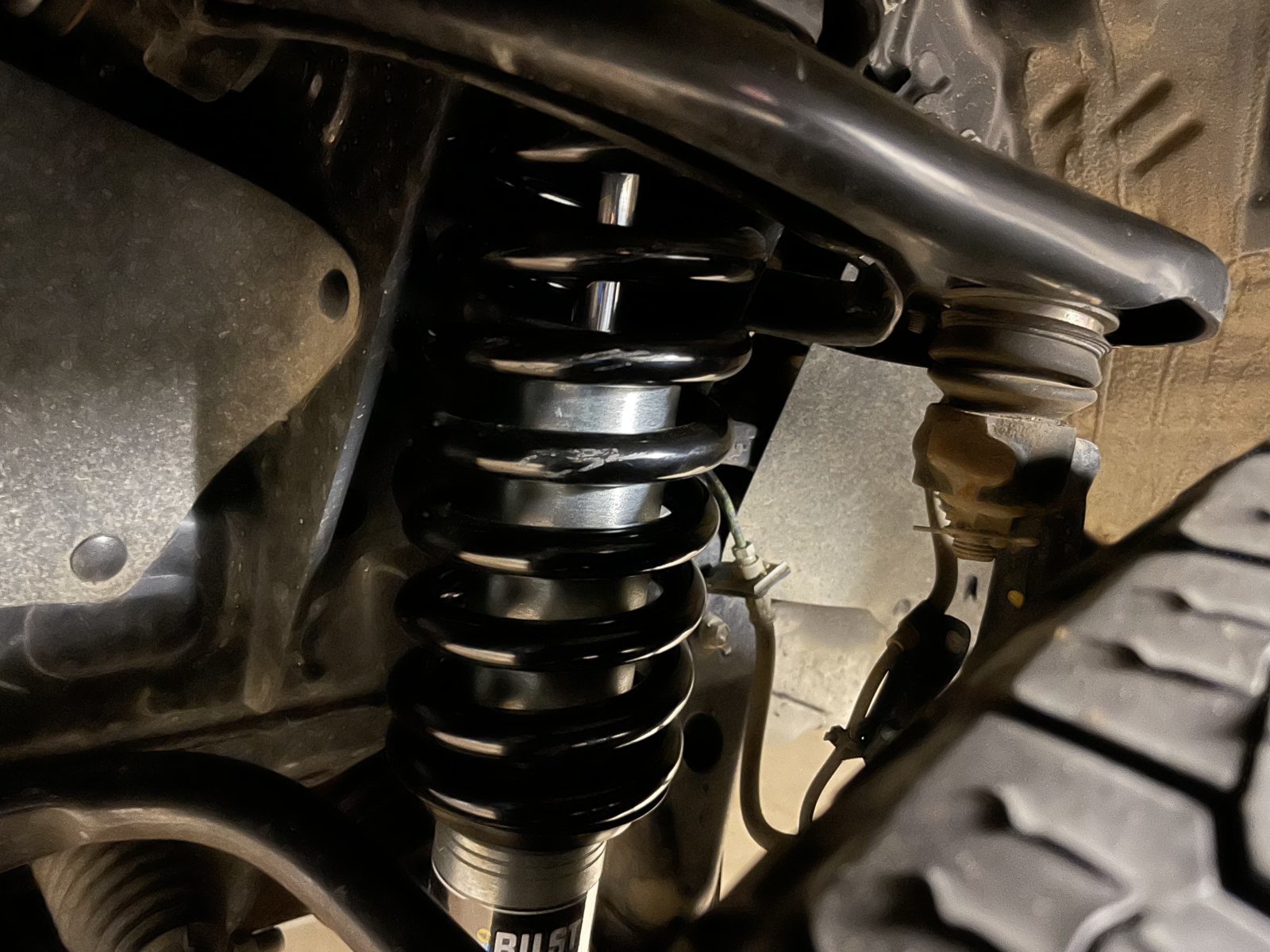

    Close ups have old stock tires..... BTW - Bilstein dealers will raise prices 7/1/24 - saw a note on that

  11. Jun 27, 2024 at 11:24 AM

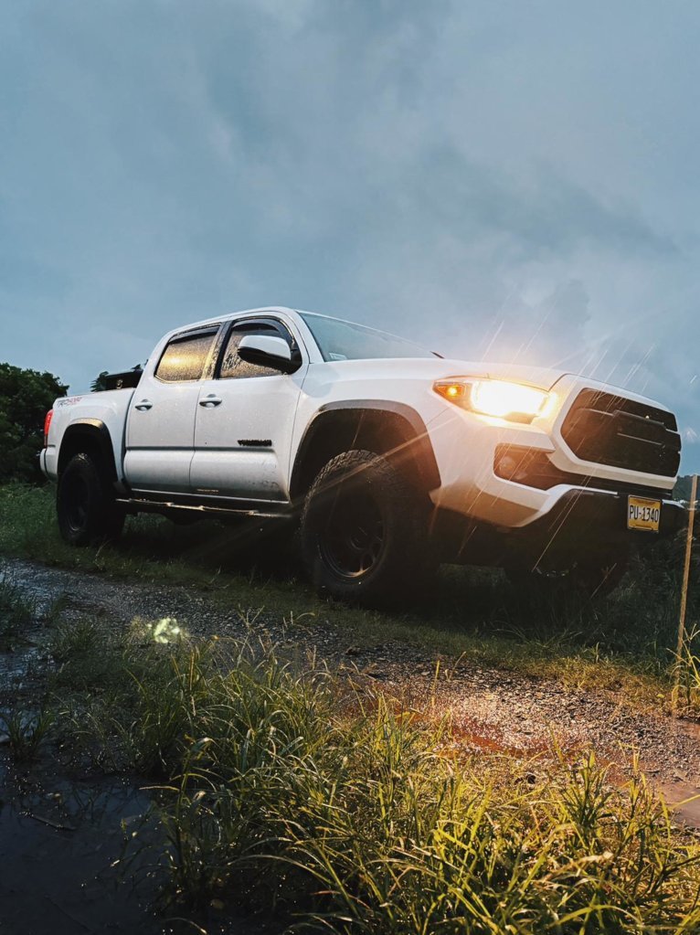

    Finally bit the bullet this morning and ordered the Method 703's 0 offset and some Falken Wildpeak a/t4w 265/70/17's. Figured This was the smart thing to do for now and then can lift in the future if I want to run bigger tires etc. Thanks for all the help / advice!

    Yep - nice wheels and tire setup for stock suspension and no lift

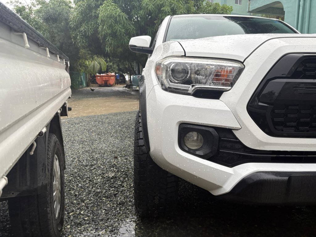

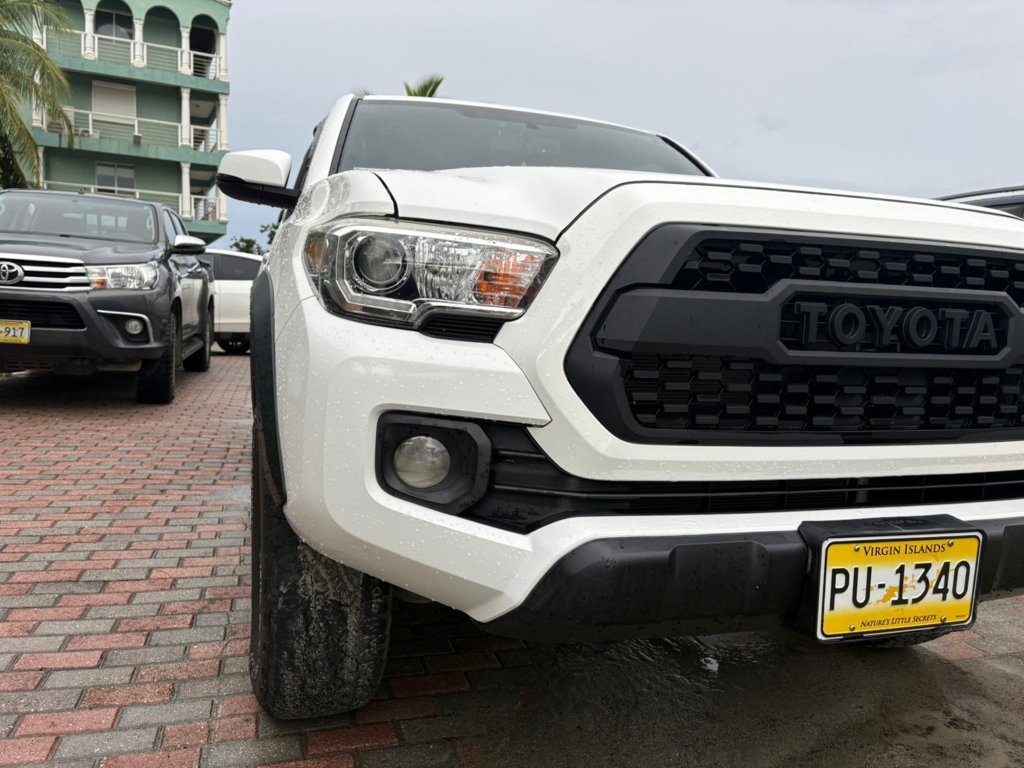

    Wheels and tires finally arrived and put on yesterday. Tiny bit of rubbing on some of the steep corners getting to my house but nothing a little bit of trimming won't help. Super happy with the result. Thanks everyone for their input - couldn't be happier.

    where on the truck are they rubbing ? That shouldn't happen with that set up. Did you get her aligned after you got the new tires?
  20. Nov 7, 2024 at 9:47 AM
    #60
    TolaTaco
    TolaTaco [OP] Member
    Mar 7, 2024
    #445398
    24
    Tortola, BVI
    No I haven't yet. Still trying to find a shop that can actually do it properly here.
