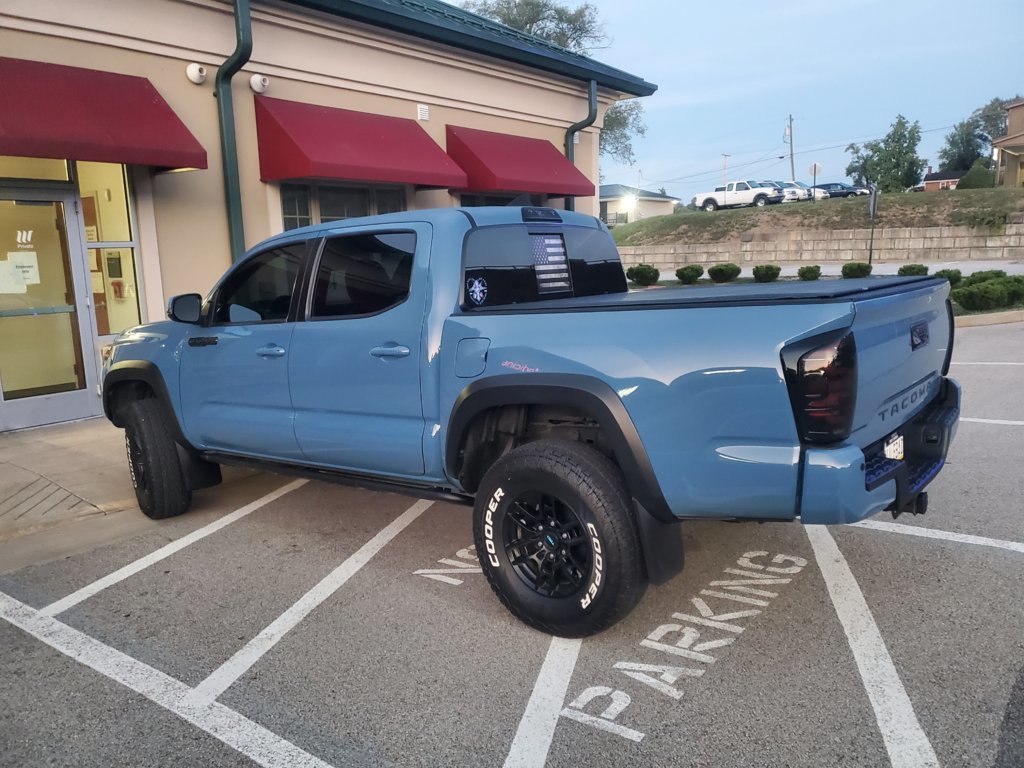

    That sounds like a good price, I paid ~$205 each from discount tire a few weeks ago. There was a $100 mail in rebate through Cooper, but who knows when I'll get that back.
    I've only put about 1500 miles on them, but so far they feel good.

    I do like the white lettering!
