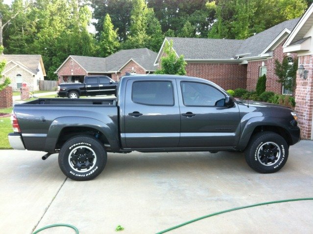

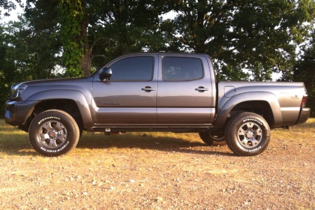

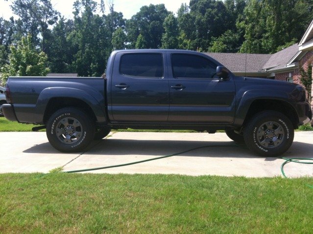

    I installed everything myself. For the Billies and AAL I've spent 400. I'm probably going to end up getting OME 884s when I go up to a 265/75/16 tire so that would be another $180-200.
    Stock
    5100s at 1.75 with non TSB 3 leaf rear
    5100s at 1.75 with 1.5" AAL
