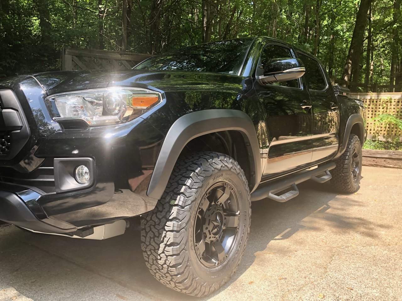

    Just got back from DT. Decided to go with the KO2 in 265/70/17. Wheels are 17x8's. No rubbing whatsoever. I know many people aren't the biggest fan of RS but I love em. Way to many taco's with faux beadlock's around here. Tires are C load... Seem to ride much smoother. Truck feels more planted.

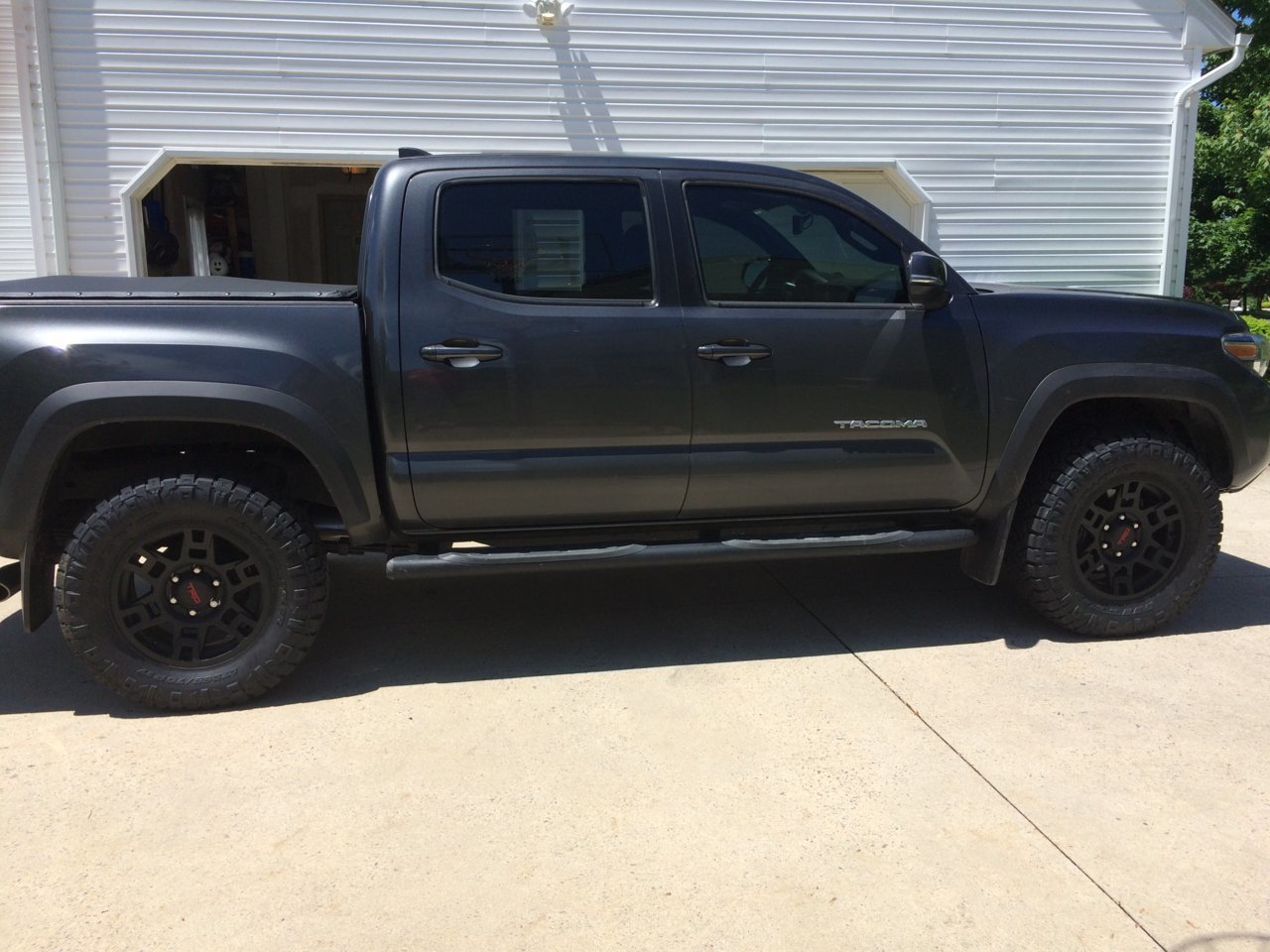

    Just installed the Nitto Ridge Grapplers 265/70/17, no lift, no rubbing and love it! These are 17x7 TRD Pro Rims.IMG_0019.jpg
