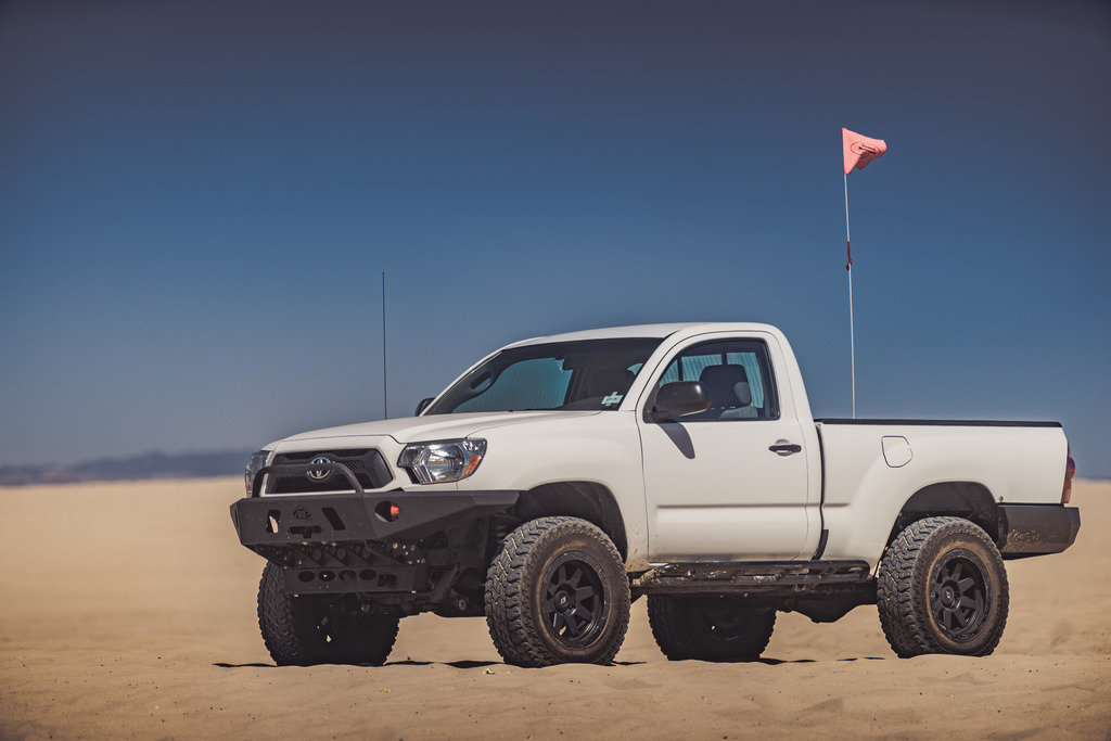

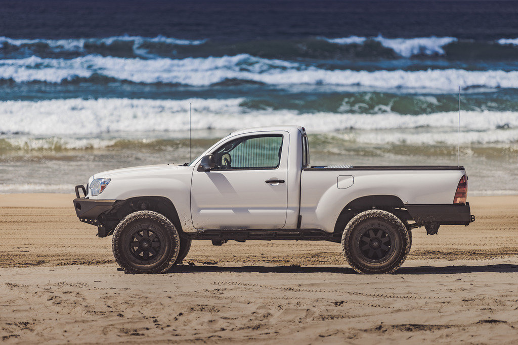

    I had the ST Maxx in 255/80/17 on the 17" SR8. Darn good tires, very tough and durable for off-roading.

    Nice regular cab! Did you regear? Also, off topic, which sliders are those? I’ve been thinking about doing the weld on Brute Force sliders.

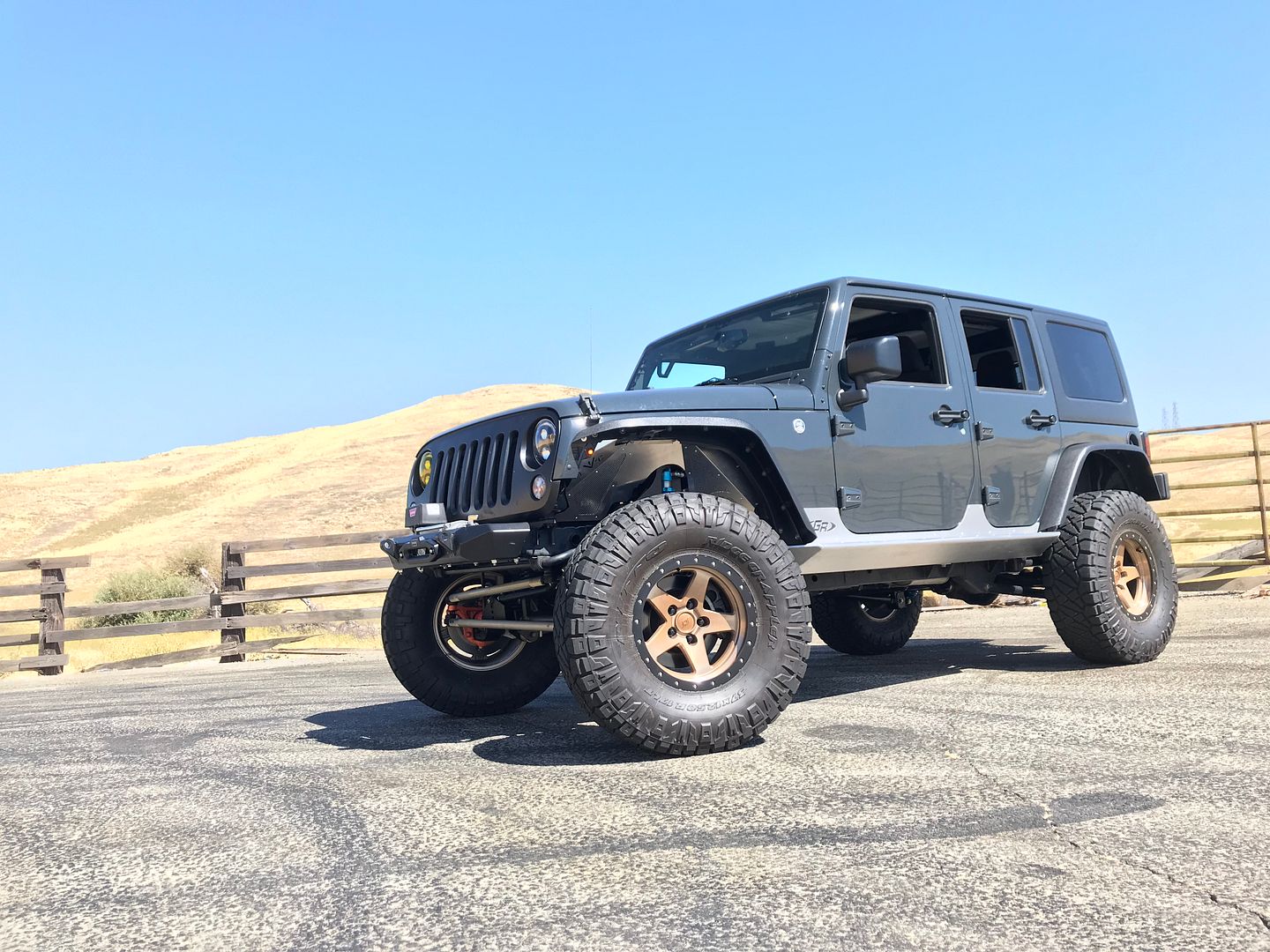

    I was going to regear but sold it before I got a chance to. The slider was from Marlin Crawler, it was a universal slider for the FJ80 that I'd made to work.
    I no longer have this, I do miss it a lot. Got myself a JKU for more room. :notsure:

    Nice JK! I’ve always wanted a wrangler but I want a truck bed. The gladiators are nice but so pricy!
