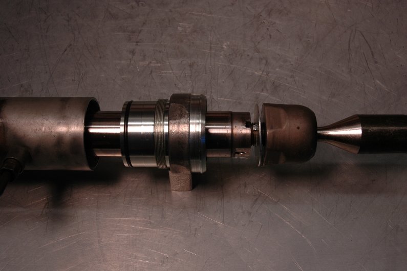

    You have seen the driver side. Here is a shot of the pass side bushing that may or may not contribute to the problem. It can also be changed along with the pass side "rack end seal" on the truck in short order. Edit, just the bushing not the seal.

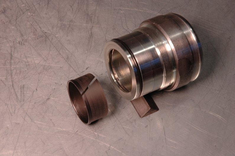

    Pass side seal/bushing carrier, called the "rack end stopper" by Toyota.

    I was going to suggest starting with the guide and cap if there are no other issues, it's the primary offender. It's certainly one way to go and a route many take. In the end it's going to be your call based on the big picture for your situation.
    Just the guide will dramatically reduce the play. The bushing on the pass side can be replaced on the truck. Remove the ITR and unscrew the "end stopper". The bushing just pops in/out of the stopper. See the 2 pics in post #23. The only issue is the bushing is only available as part of the complete seal kit and Toyota wants $100 for it. I have twice used an after market seal kit, "Gates" brand, $35-$40. I couldn't tell any difference from the OEM.
    Error in post #23, just the pass side bushing not the seal can be changed on the truck.
