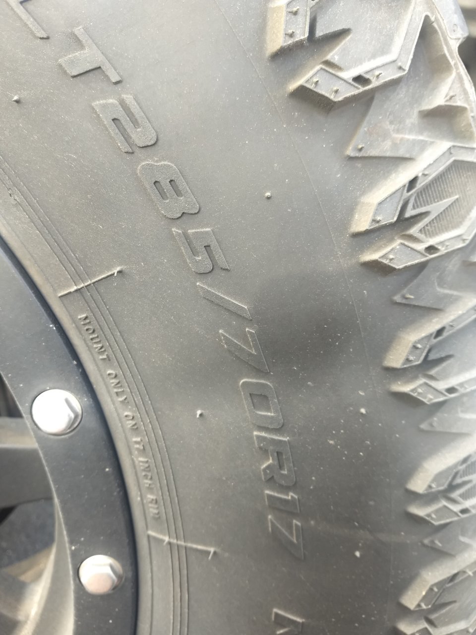

    I just bought this truck and I need to get new tires for it, the tires are 285/70/17 but from my lurking, to run those I need a lift right?
    So I'm trying to figure out what lift I have. I know it has bilsteins in back and possibly a little 1" white block on top of the leaf spring stack.

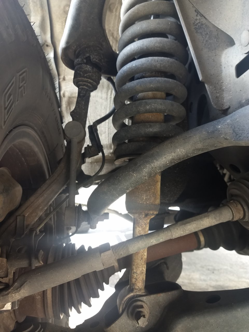

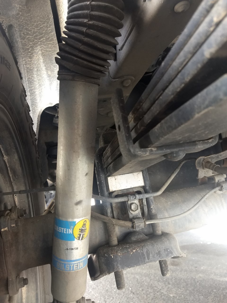

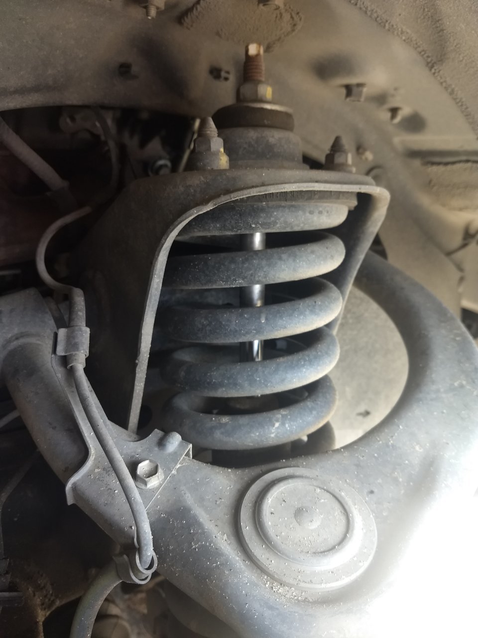

    Here are the clues!

    Looks like youve got 1" blocks out back. Hard to tell what kind of shocks you have up front, maybe 5100s or something with some springs that provide the lift. Truck looks level, so im guessing youve got about 3" of lift up front.
    Something to note, your upper ball joint boot on the passenger side is torn and in very bad shape.. you might take a closer look at these and see how the ball joints look. If theyre in good shape, pack them with grease and reboot them, if they are not in good shape some new ucas might be a good investment

    Was going to mention. That. Looks like 5100 bilsteins around fronts are just to dirty to really tell. Also your leaf pack looks like OEM.

    So 3" lift possibly up front with possibly Billy 5100 all around with a 1" spacer on the leaf pack out back.

    If it is 3" then u have aftermarket coils up front with 5100s as well...5100s alone wont go higher than 2.5

    So then possibly a 2.5 lift in front?
  16. Feb 22, 2019 at 3:08 PM

    Could be 3" with 5100s and ome coils.
    Are there circular paint marks on the coils, like a green on one and a blue or white on the other? If so most likely stock coils.
    Do they have a tag on them? I wanna say ome lift coils do.... But those can be taken off

    Im no expert... Maybe someone can guess better based on u having stock upper control arms and looking at your boot angles

    The shocks look white to me or it's been a really long week.
    Whatever size it is, I would recommend getting some aftermarket UCAs. Anywhere close to approaching 2.5" or higher it is HIGHLY RECOMMENDED that you replace the stock UCAs.

    Looks like the front bilstein 5100s are set on 2nd or 3rd perch.
    Count the rings on the exposed body of the shock below the spring perch
    Also take a center of the hub (wheel) to bottom of fender.

    I'll measure after I get my new tires today, also if I drop my 5100s to the bottom perch would it help the UCA issue?
