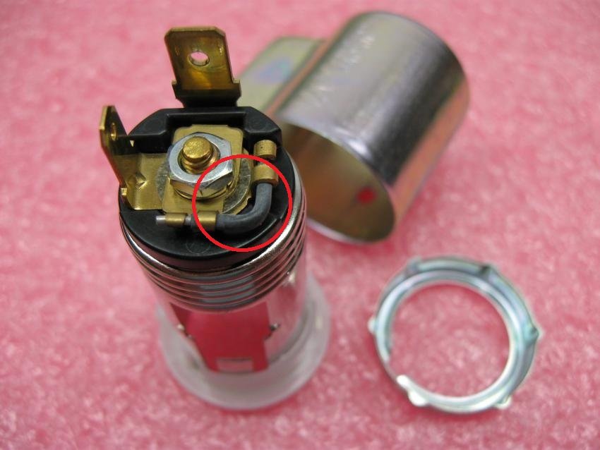

    The cig charger on my dash (just below the ac controls) has stopped working. I'm trying to check the fuse but the labeling on the fuse box is hit or miss. Which one is it???

    Wrong fuse panel. Look at the one inside the cab under the driver's side of the dash. Fuse will be the one labelled something like Aux Power #1 or #2

    Might also be labeled acc power.

    Thanks guys I'll check out the other fuse box!

    If the fuses are good, check power at the connector,f you have power, the outlet is bad. There is a fusible link that blows sometimes and it's part of the outlet.
