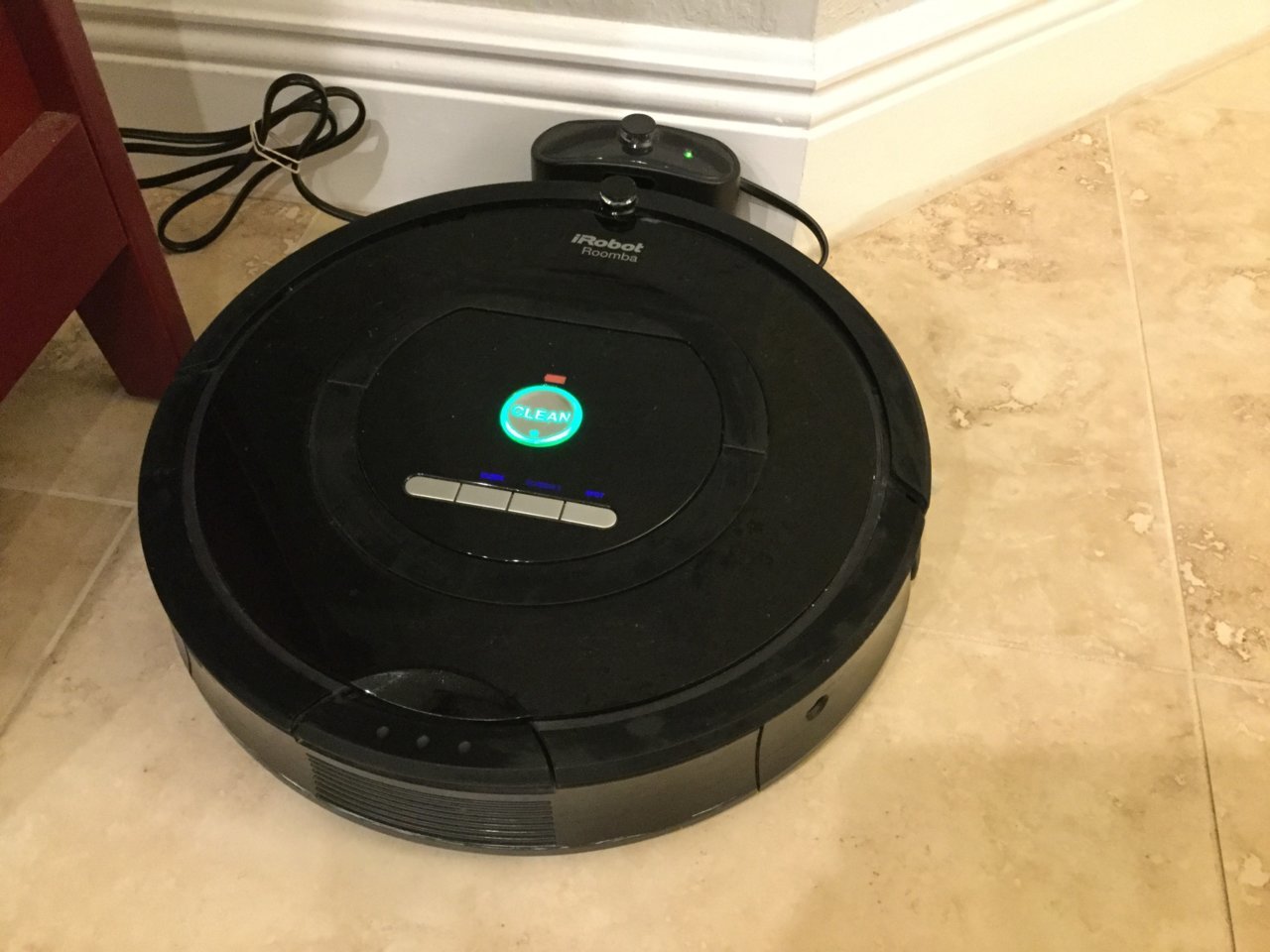

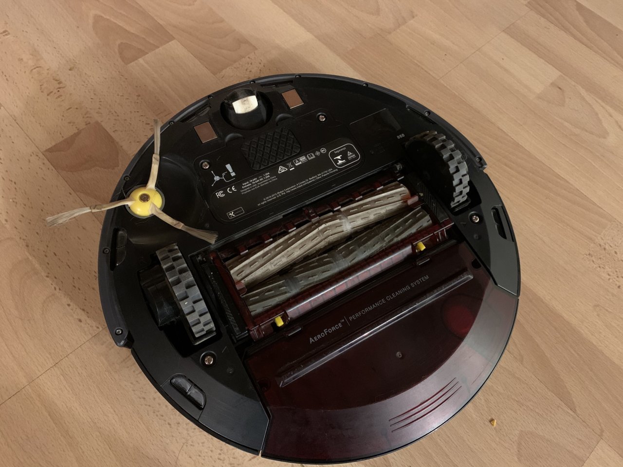

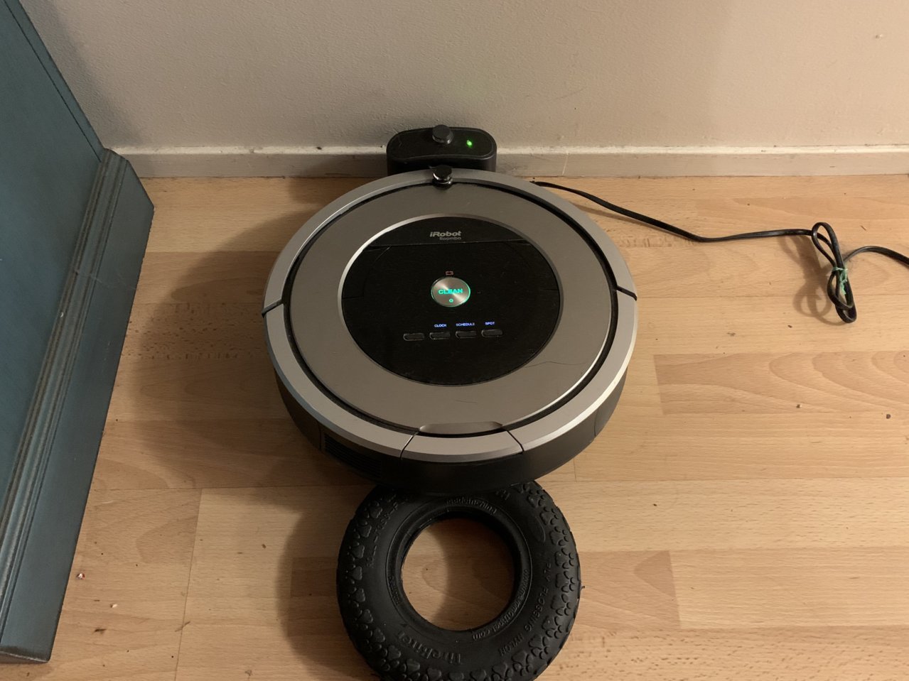

    Bob is our Roomba, and he needs help.
    Bob works, but his problem is the connection points to the charger. We need a lift kit for his butt so the contacts engage with the charging base.
    This is fine if we prop him up with a spare tire, but he can’t go off on his own or return home and charge which basically defeats the purpose of Bob.
    Anyone know how we can fix Bob’s charging issue so he can be the strong independent Bob we know him to be?

    I dont own one, but would adding weight to the back cause it to sit correctly, so you you don't have to prop up with a tire.
    Does it rock back and forth if you push down on it... maybe the wheel bearings or gears have play allowing it to not sit right

    That's a interesting idea. Add some prerunner bro lean to Bob. I can give it a try tonight and see if that works. He doesn't really rock back and forth, but his tires do have a decent amount of droop.

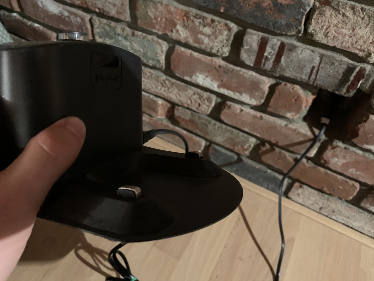

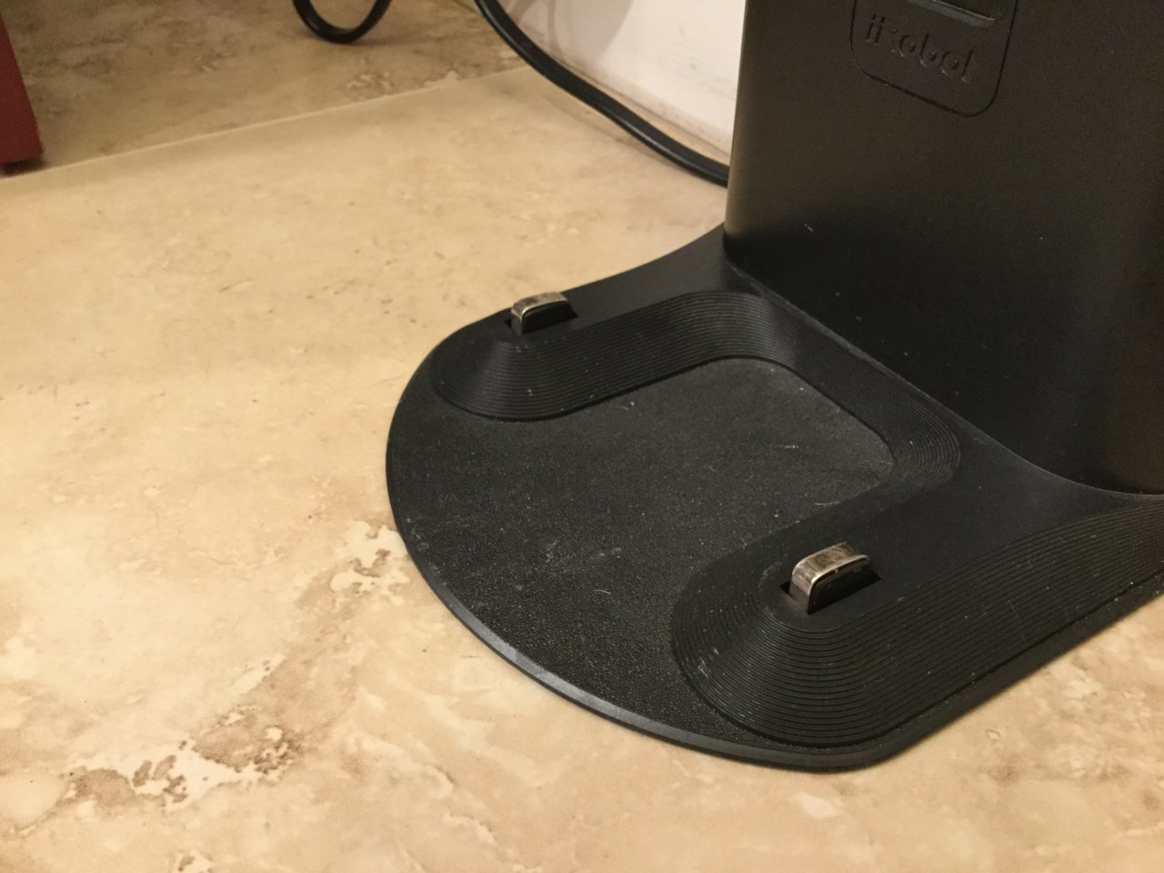

    Can you push the wheel between the charging contacts down any? It's hard to tell from the photo but it may be protruding out more than it should be.
    Also, do you have a photo of just the base station? The contacts on it may be pushed into the plastic. I'll have to look at mine this evening to compare

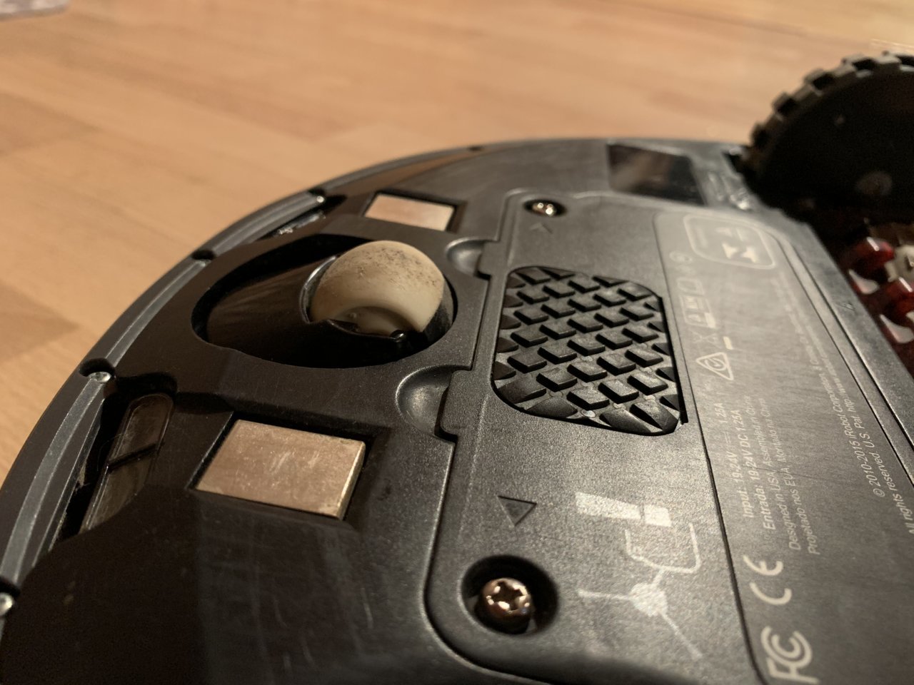

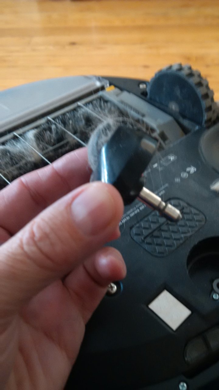

    The center wheel pops out. Pull it out, clean it, and reseat the wheel. Make sure it clicks when you snap it back in.

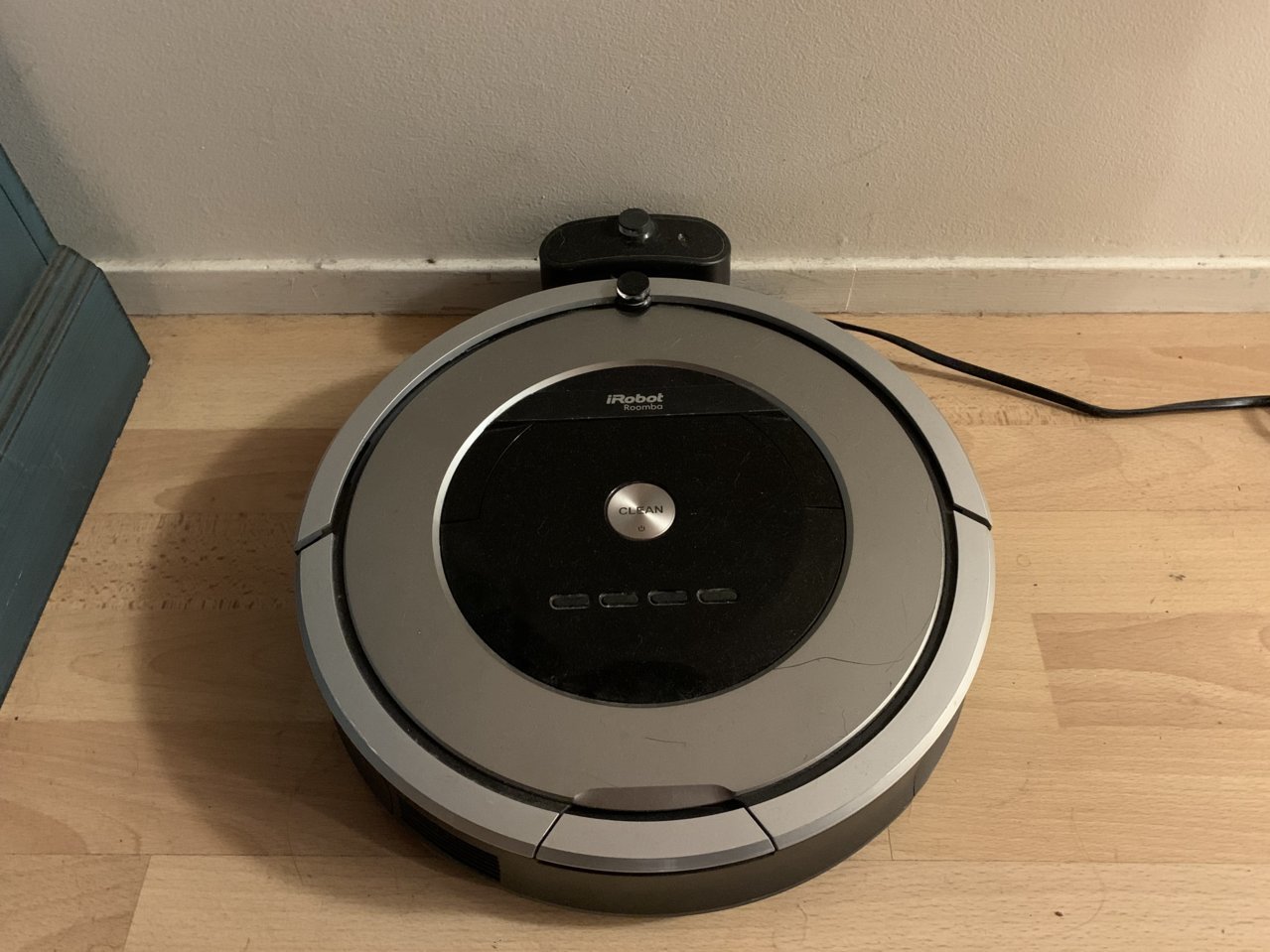

    This is the underbelly of our Mr. Peters
    TeecoTaco and eccracer104[OP] like this.

    Glad to help. You can also push the center wheel outwards of the housing.

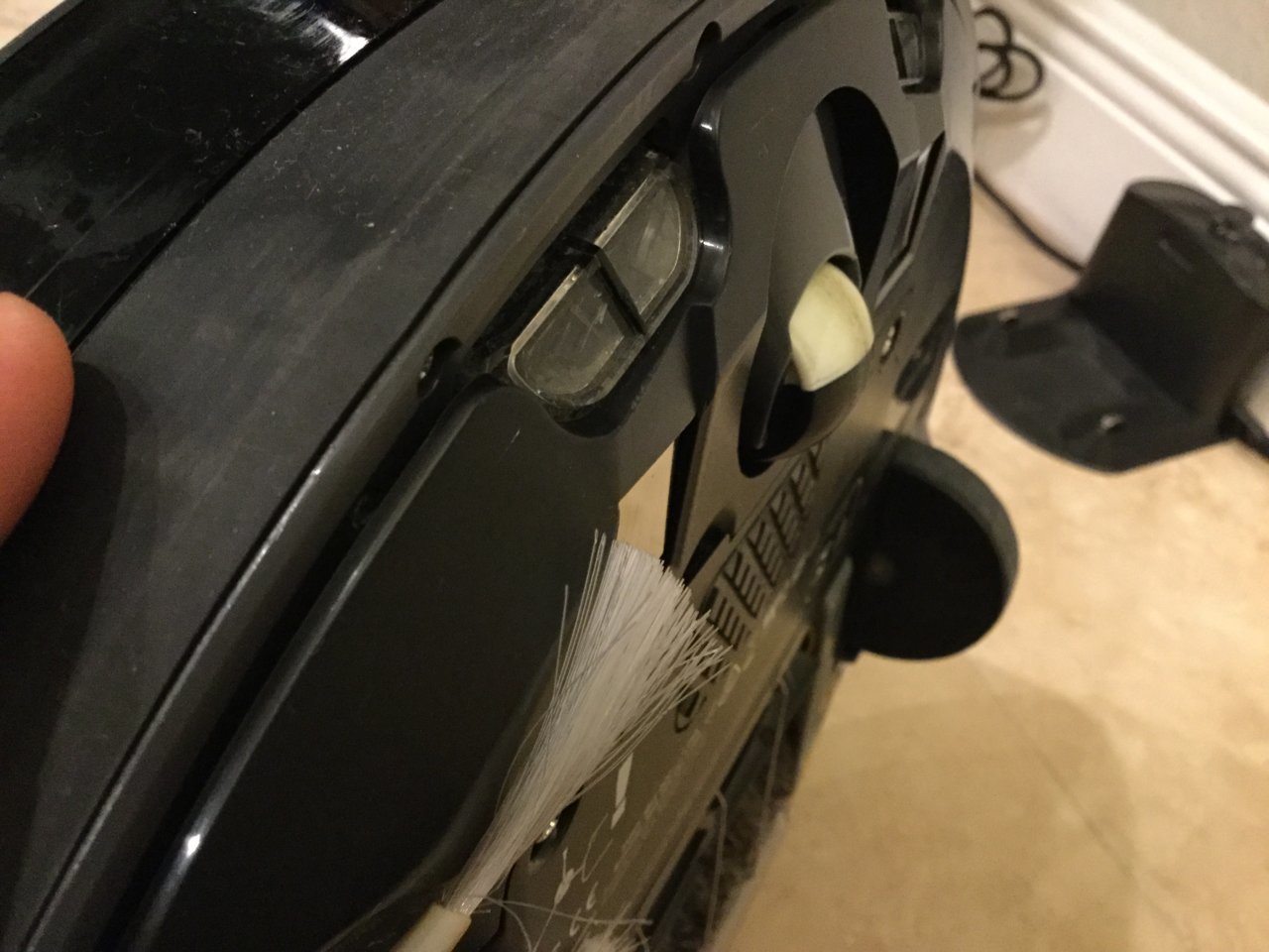

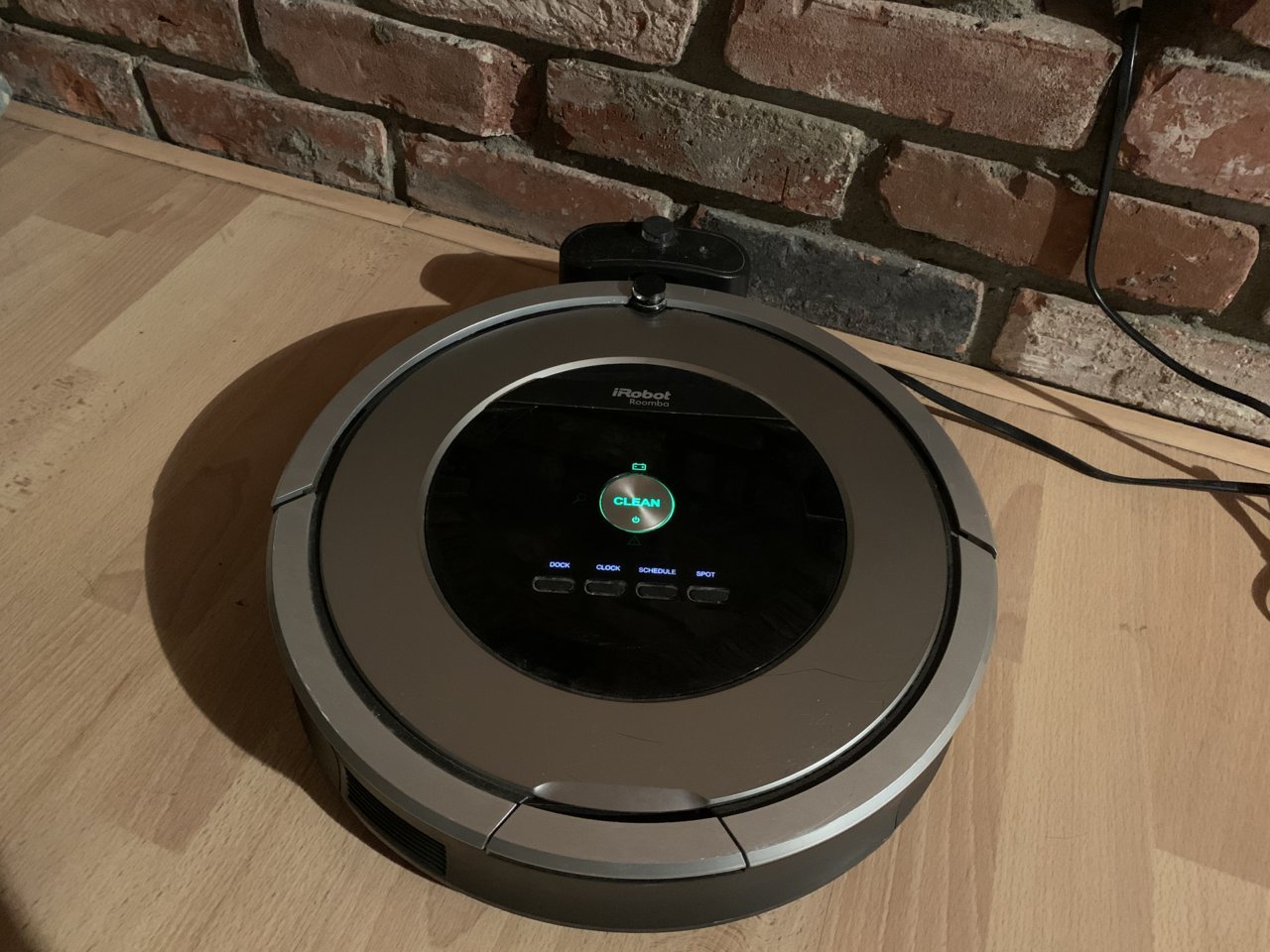

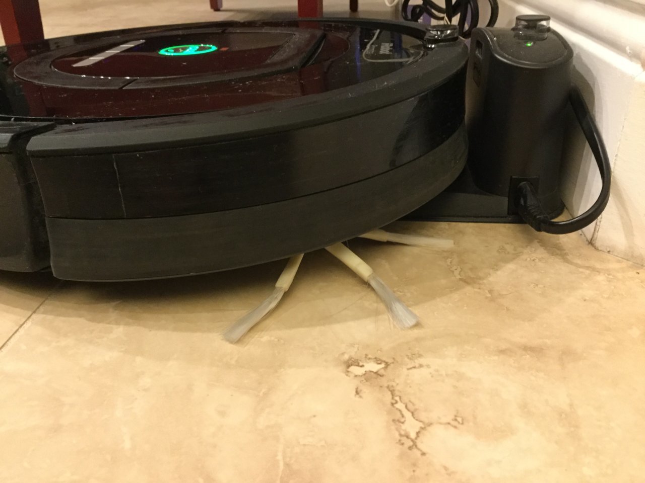

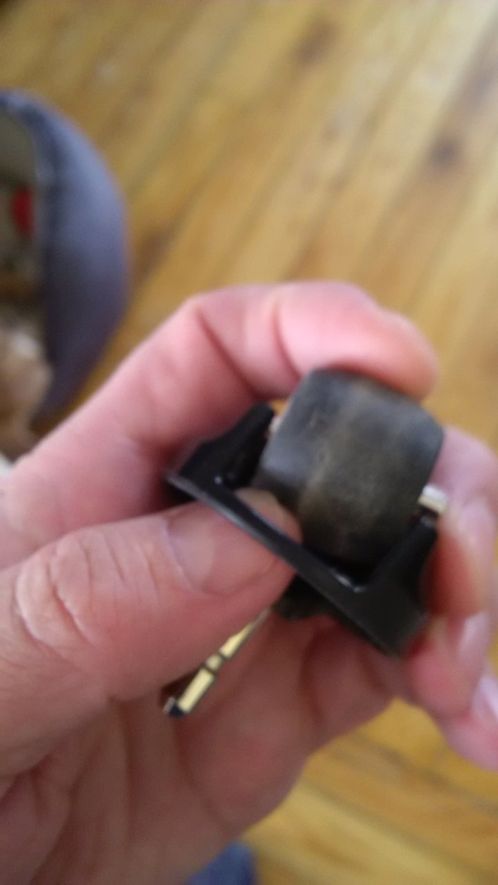

    Robot #770 checking in... here is how he docks. Make sure the single wheel is pushed alllllll the way in and that your charger contacts are popped up (spring loaded).

    Contacts on the base are good, they’re not pushed in or anything.
    Center wheel was wrapped with hair, but nothing under it. Popped it out, cleaned it up, put it back in. Low and behind Bob has no lift kit and is charging!
    Strange to think the center wheel being ever so slightly off could have caused it :rofl:
