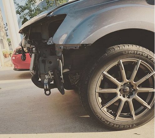

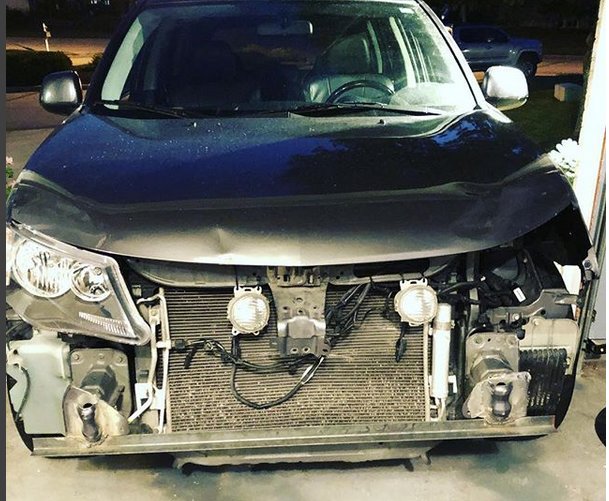

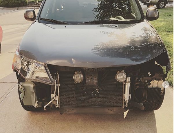

    Just bought up this 08 Mitsubishi Outlander from salvage for 900 bucks. My dad accidentally rear ended someone and totalled it. He ended up denting the radiator, breaking a radiator mount, and bending a ton of other parts. I was able to pull out most of the dented structural pats with a tow strap and my Tacoma, hammer out most of the remaining dents in the hood, and rewire the DRLs, horn, and hoodlatch sensor.
    My question: I have to have a bumper to be street legal right? What would you suggest? I've thought about getting a cheap JK Wrangler bumper and Jerry rigging it to fit.
    (New driver side headlight in the mail.)

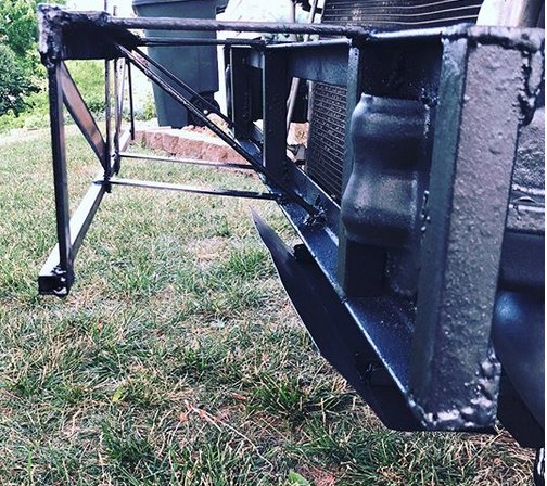

    First attempt at welding (FCAW)... Holding so far. Much more to come.

    Frame of offroad bumper coming together. Possible bobble head idea:

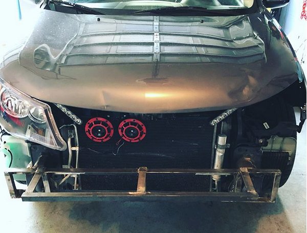

    The bumper sticks out past the headlights now!
    Ive got to add some 45 degree supports on the side and bottom.

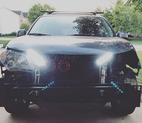

    New day time running lights and Hella Supertones! Woooooo.
    I also welded some steel reinforcements into the upper radiator housing, primed, and painted it.

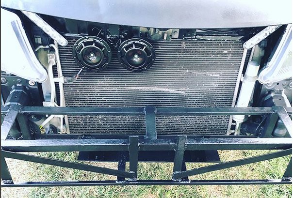

    Bumper is painted and I armored the CVT cooler and washer-fluid reservoir.

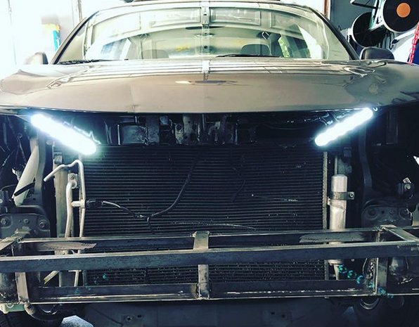

    Just got back from state inspection, I needed to make the front surface area larger. Here's the result:
    Also painted the horns sparkle black. :D

    Is this gonna be a woods bomber?
    Going on the set of the next Mad Max flick?
    I don't think it can go on the road like that.

    Here's the long and short of it. If I went with stock replacement parts:
    $225 for stock bumper reinforcements piece
    $56 for styrofoam
    $275 for front bumper cover
    $40 for front lower bumper cover
    $18 for front bumper end
    $69 for front bumper "skid plate" (plastic)
    $12 front bumper cover support
    $25 for plastic support brackets
    Rather than buy all that plastic crap for a car that only cost me 900 bucks, I opted to weld on my own metal bumper for like 120 bucks. ¯\_(ツ)_/¯

    I fully understand the savings of building your own, I do it as well.
    Is this car going to be a daily driver? I hope so, no one is going to want to buy it like that.
    I'm not being mean, I just am trying to understand why made it this way.
    I like how you are using this car as a learning experience, but I wish you would have asked for some suggestions.
    It just seems that such a nice car could have been fixed up to look closer to what it looked like new.
    You could have spent the extra money for the factory bumper and then ended up with a car that is worth $7000 vs $900. (Which you will have difficulty selling for that much).
    As for that bumper you built, I hope you never hit anything. Those wierd braces are going to be driven into and thru the radiator and possibly into the engine, which would not be good.
