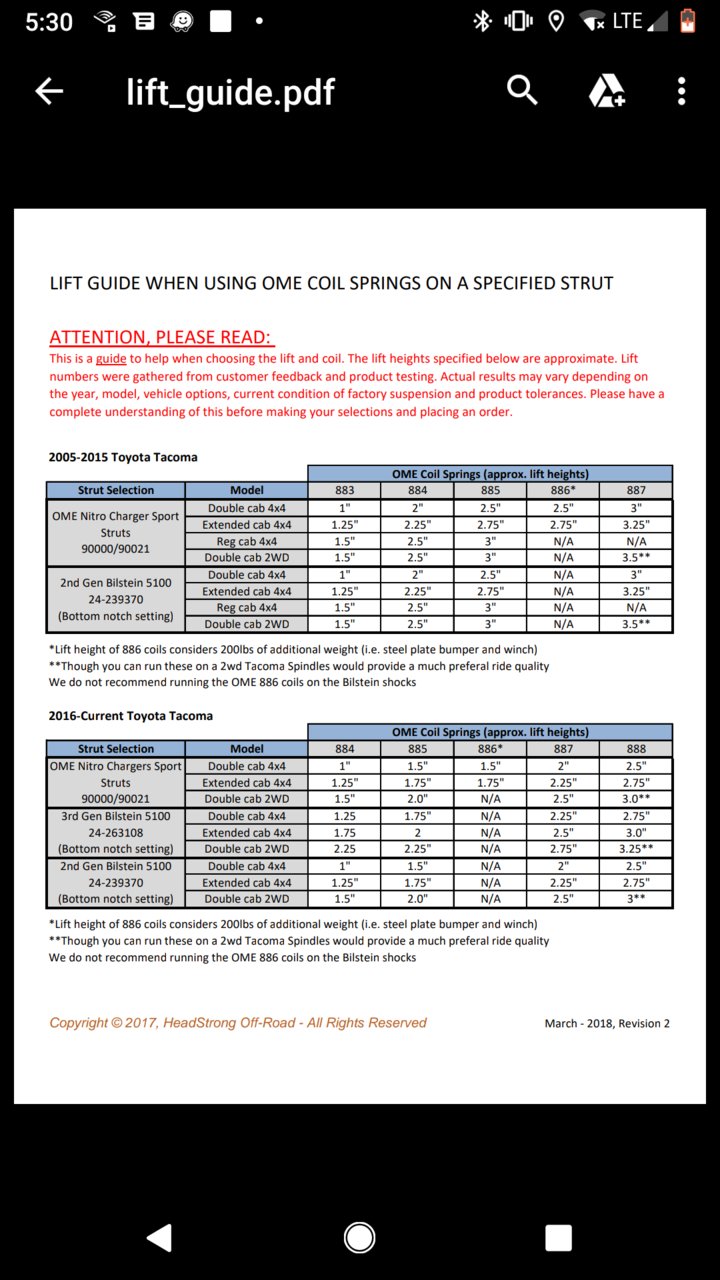

    Have you looked at this guide yet?

    Thanks. So 887 and 885... why would they give the same height. Wouldn't 887 be higher?

    Yes 887 is higher but depending on sag, you might be closer to 2 inches with 885. Every truck is different.
    Do you want level or rake? I wanted rake with a longbed and toolbox so I went with 885, I dont need to be above or below a certain amount like you seem to be at 2 inches.

    I want some rake. So if I go 5100s 887 and a 3AAL (1.5 or 2 inches- still not sure) will that raise everything up evenly?
