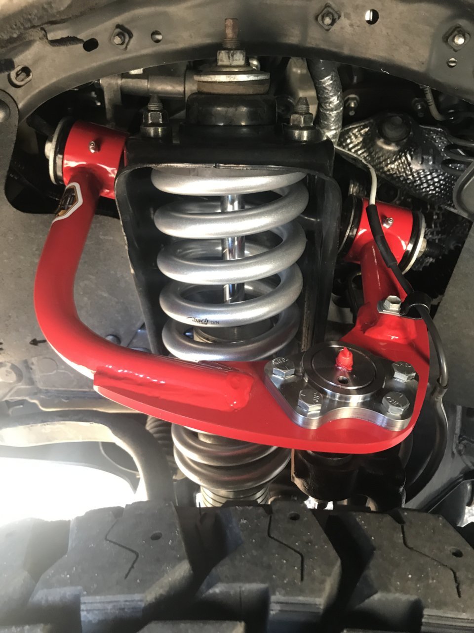

    Bilstein 8112/8100, JBA UCAs, Icon RXT leaf pack, work wheels 17x8.5;-10os, 285/75/17 cooper LTX AT3, Mobtown HC rear bumper and Sliders, SSO front bumper, BAMF greceased grill.

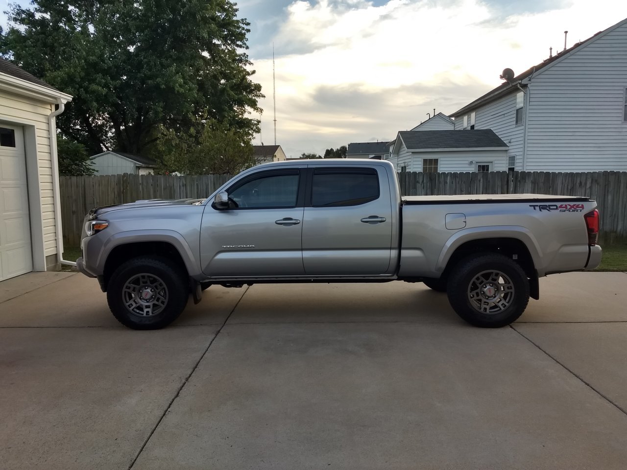

    Unfortunately I don’t have a pic of my cv angles as I’m not at home, but they are fine trust me. They don’t look crazy like some setups I’ve seen. I don’t have a diff drop either just the ECGS upgrade.
    As far as measurement I have them from ground to fender. Front is 38 1/4” in both sides and the rear passenger 39.75” and 39.5” rear driver; with a full tank and about 100ish lbs of gear.

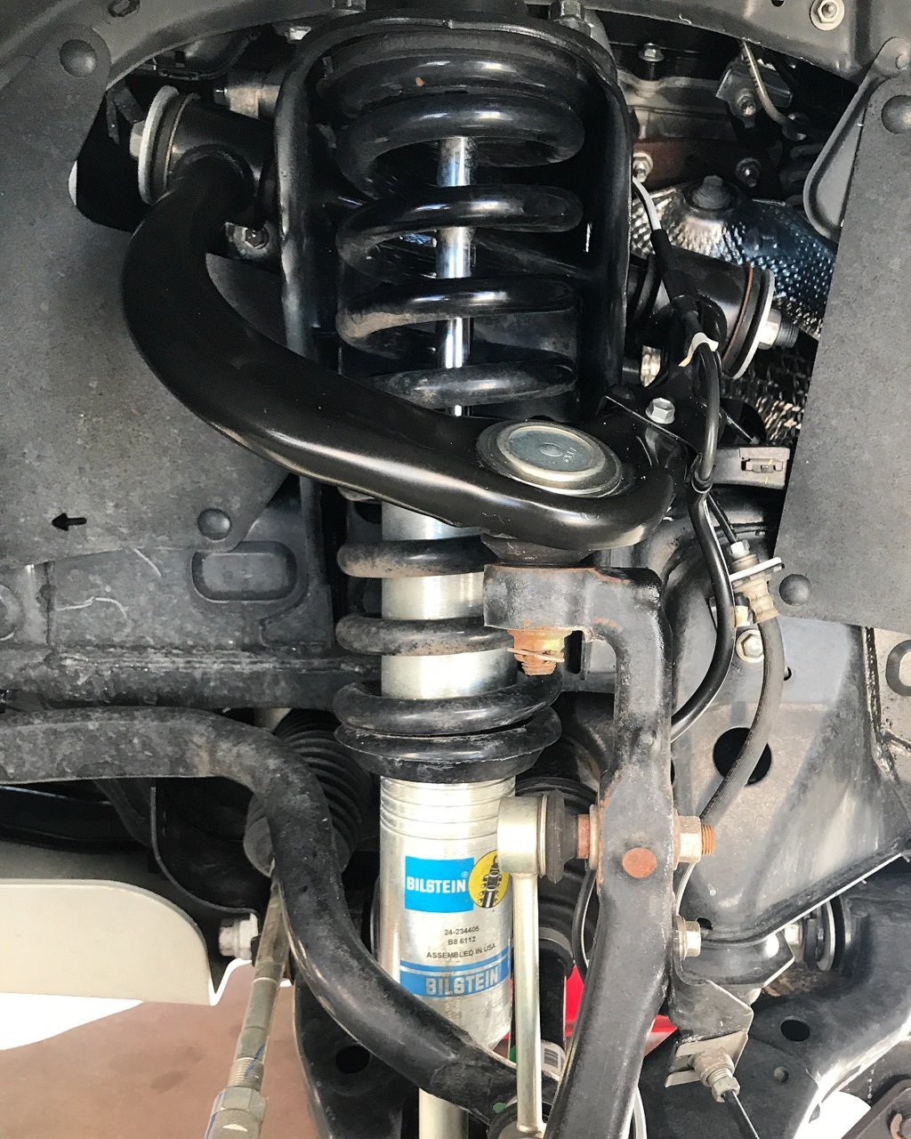

    Bilsteins 5100s on the top setting, 4runner Gray TRD Pro Sema wheels, 285/70/17 Toyo AT3s, Sumo Bump stops, TRD exhaust, ECGS Clamshell bushing, 1/4 shim for the lean and one inch rear block, OEM Pro grill and garnish OEM TRD Skid plate, TRD CAI, Demon Brackets, Rigid Industries Pro fog lights, OEM Trail Rails sidebars, Diode Dynamics LED SL1 high and low beam lights, OEM Roof racks, Clazzio leather heated seats, Remote Start, TRD Pro shift knob, tinted windows, Rockford Fosgate 4 channel amp for the headunit and sub and amp combo, OEM Puddle lights, OEM tailgate lock, OEM bed mat, LED interior lights, OEM blackout kit for letters, JLT catch can, upgraded 27F toyota True Start battery, Vleds led tail light kit with Pro tail lights, OEM Rave4 side mirrors with convex spotters,just to name a few mods.
    IMG_20181009_181855269_HDR.jpg IMG_20181009_175650950_HDR.jpg 5100s here all front and back. Great ride, not stiff at all like the org. Sport suspension. Best move I did was 4th setting on the front and a one inch block in the back. It fits my needs. New tires and wheels, I'm satisfied with it.

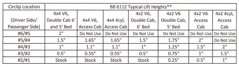

    This is the lift chart for 6112, it says 2 inches expected. Not sure where the other site is getting 2.5 inches
    The different driver / passenger side clip settings are to compensate for Taco Lean.
