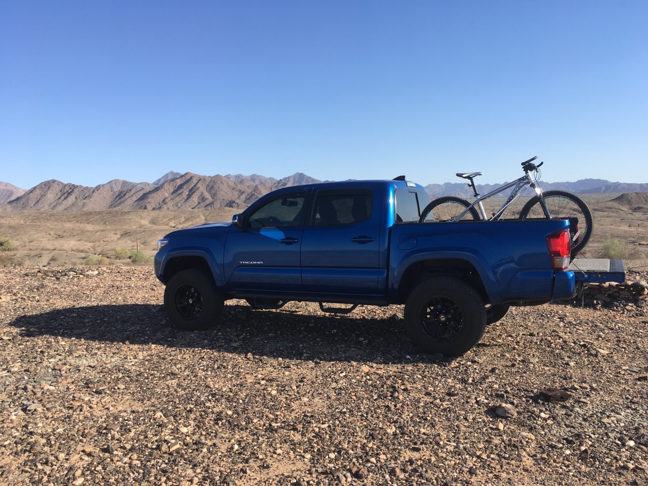

    6767D014-C917-476D-8C45-0AF860F5B4DF.jpg I was out playing in the desert today and I took my Diamondback on some nice trails.
