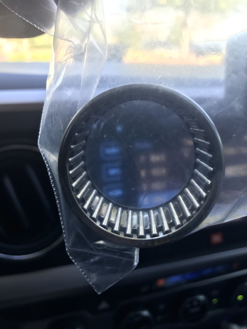

    To give you a better idea what it looks like....the needles inside you see tend to break, the ecgs is smoothed out. Toyota knows this is a faulty part which is the reason why there is a TSB out on them when they break. Toyota redesigned it but still has needles in them. The TSB bushing and diff drop is all bandaids, the true fix is the ECGS bushing.
    Up to you if you wish to get it done. People either plan ahead of time to avoid the issues and others fix things when shit happens. Which one are you....
