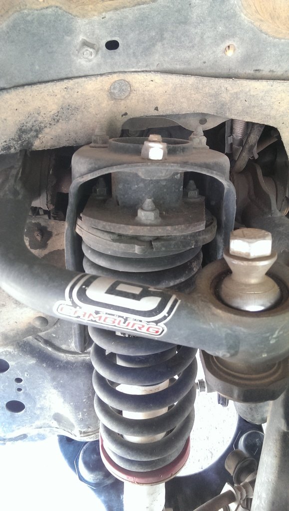

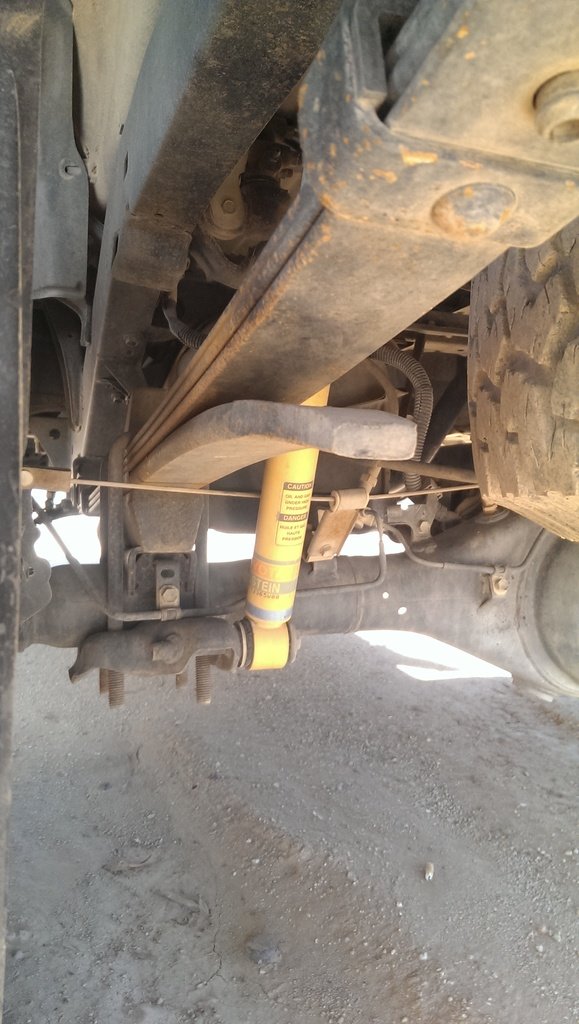

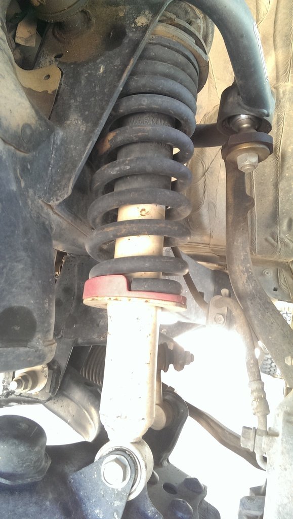

    I'm ready to start delving into this. All my suspension is shot. I've been searching and searching but keep finding mixed opinions and all kinds of different setups, not sure what to go with.
    Here is the current setup:
    2" top plate spacers (and I think poly coil spacers?) with Camburg uca's
    2" blocks in rear
    33x12.5 w/15x10's
    measurements (ground to fender) are about 39.5"
    This is most likely with saggy coils, and certainly flat leafs.
    Mostly daily driving. Occasional offroad. Trail runs. Occasional heavy articulation stuff. Nothing too crazy. She is a prerunner after all. Don't load anything either. Yet. Eventually I want to set it up as an expo type rig. With bed rack and gear and eventually an rtt. But this will be a long ways away. I'd like to future proof myself regarding the rear setup.
    I've got about 2-2.5k to spend.
    I was planning on King ext travel coilovers up front for a mid travel setup. But not sure how much lift I actually have atm and want to at least retain that lift or possibly go a tad higher. Or if it will end up being higher with the kings preset to the ideal preload, than what it is now. Because I keep hearing not to preload them to the max 3". I have slight tire rub on pinch weld at 3/4 full lock with the 33's, when front is compressed a tad. Thats with the pinch weld beat the heck in as far as I can get it, ha. But may have to try it again or go back to 32's later. Just want to be sure I'll be ok with the kings. Or should I go with something else up front for my needs like ome 3"?
    For the rear, I was thinking ome with dakars and nitros for now. Kinda budgeted after the kings. Would I need an aal or lift shackles to retain my lift in the back as well? Or maybe just shackles, then later when I have the need, add in the aal when I get load bearing gear? Or should I just install dakars w/nitros and wait to see if i'll need an aal/lift shackles?
    Then at a later time (but before the expo gear) I'll look into doing the shock relocate for more travel with better shocks.
    So my list is as follows:
    ext kings
    dakars w/nitro
    ubolts
    extended brake lines F&R
    ome greasable shackles, with main eye greasables
    brake prop bracket
    3 degree shims
    Let me know If i'm on the right track, and would be good with this setup.
