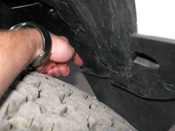

    K, well I have FJ rims, and the only slight issue, under closer examination, is a teeny tiny bit of rubbing on the mud flap, here:
    Not significant enough to need any tinkering in my mind, but I am considering takign the front flaps off just because I like the look better

    i have 285s on aftermarket wheels and they rubbed all the way back to the body mount until i got a good alignment. alignment i had was in spec, but after a new one, no more body mount rubby. with the BS on the stocker rims, they tuck inside closer to the engine compartment when turned and apparently miss most of the mudflap, inner fender, body mount, etc
