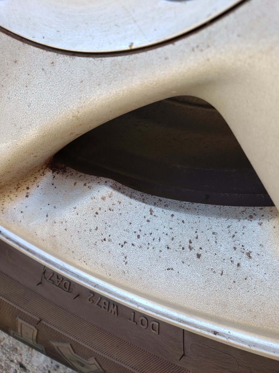

    These are factory wheels from my 2003 Taco. I'm pretty sure it's brake dust that was allowed to sit and bake on by the previous owner. I've tried soap and water and Meguiar's Hot Rims Aluminum wheel cleaner with no difference. I've let the cleaner sit and scrubbed with a stiff brush. No visible difference.20200507_100106.jpg

    I believe you will need iron remover I have purchased CarPro IronX for removing particles from the paint and wheels. Available inn 500ml/1L spray bottles and 4L jugs. You should do normal pre-cleaning with soap and water and degreaser on the wheels first before soaking with IronX. It should dissolve the particles that get embedded in the paint chemically.

    At some point you're well beyond what an iron remover will help with. Usually the stuff that an iron remover will get isn't really visible to begin with. Though I guess you can at least use it on the rest of the paint.

    The IronX is also available in a paste for vertical surfaces. Worst case is refinishing the painted aluminum wheels. I would just get a new set of wheels and re-purpose the old ones.

    I have used oven/ grill cleaner with good results. Its powerful stuff so you may want to test on some inconspicuous areas first.

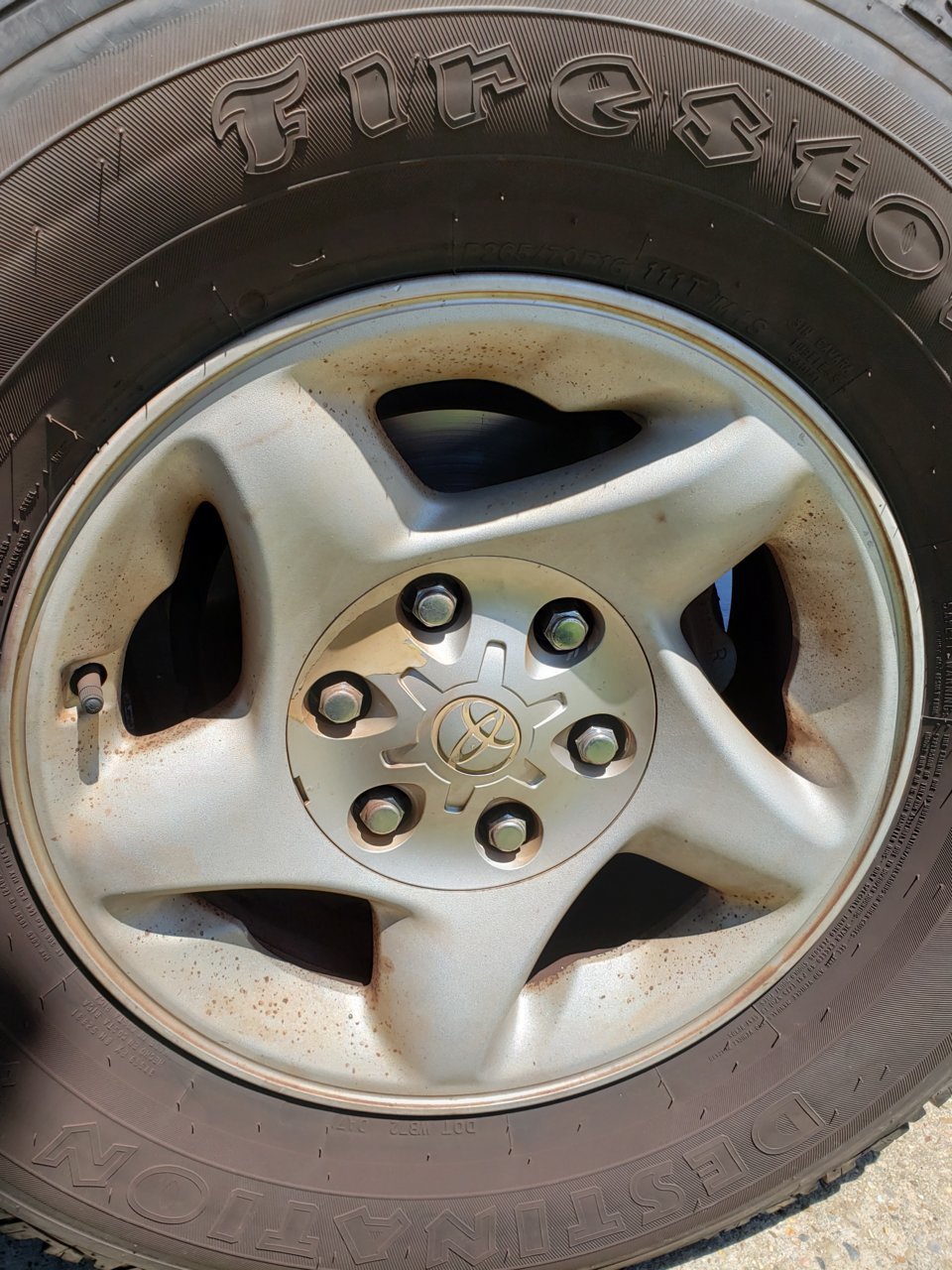

    Pre oven cleaner

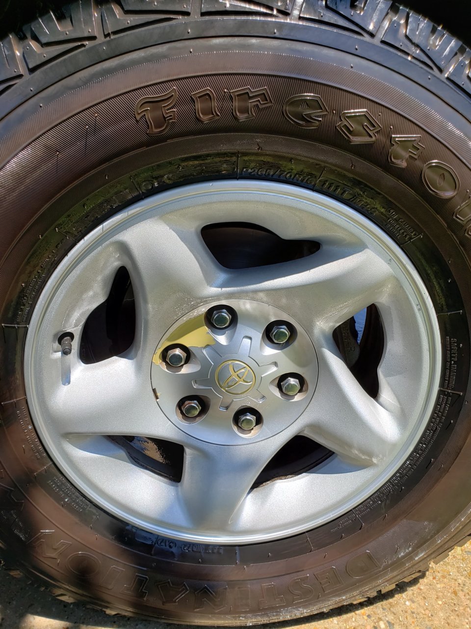

    Post oven cleaner
    Many thanks for the oven cleaner recommendation! I will wax them so this doesn't get so bad. Also switching to ceramic brake pads. I'm going to pull the center caps and repaint. Any way to strip the rest of the paint off them without damaging the plastic?
