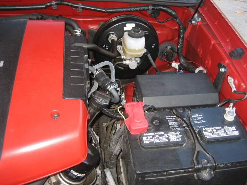

    I'm trying to get the switch to my new aux. lights past the firewall but can't find a good spot.
    It's an 09 DC. Every wire bundle has a really nice gasket around it - I've tried the coat hanger but it's almost too thick to open it. I did manage to put a piece through, but came out through the rubber gasket on the other side, then the wire fell off as it tried to pass through.
    So any good spots to pass wiring through? I'm afraid if I push through a wire bundle I'm just going to start cutting through them with the relatively sharp coat hanger edge.
    Thanks

    The boot for the wiring harness on the drivers side- instead of going through the boot with the rest of the wires, go between the boot and the metal with your coathanger.

    What I do is carefully cut a slit in the boot. It acts kind of like... well, a vagina. Use a coat hanger (or antenna which I don't use) and use really good duct tape and tape the wire(s) to the coat hanger or antenna. It might take a few tries. I did this for my 4 AWG amp wire.

    i stuck a pair of needle nose pliers as far through the grommet as i could and then spread them appard....gave me enough room to fit a battery cable through if i wanted

    I attached the wire to a coat hanger and slide it right through the boot. It made its own hole.
    Red wire for my bed lights. It goes to a switch in my console.

    my boot has a nipple at the bottom that can see if feel around. cut the end off this nipple and use it as a conduit for your wire. I think thats why its there

    Tip for next time. Use the tube body of a BIC pen.

    Exactly what I did. Works perfect. I have to admit though, I stumbled across the nipple and figured that was what it was for.

    Well I thought my problems were solved. Got through the little nipple fine with the coat hanger but every time I try to tape the connectors for the interior switch and pull them through they slide off the hanger. Driving me NUTS!

    So, I'm having the same issue as some of these other folks. Yes, I searched through a bunch of threads. Maybe I'm a moron, but I've been trying the coat hanger method to pull my wire through on my 2013 and I just keep pulling the wires off. I have three wired with connectors (bought the harness for the LED light) that to to the switch. One wire would have pulled right through, but three with the connectors is a bit large. Other than cutting a little slit, can someone post a picture of how they solved this?

    I found the little nipple under the main wire loom opening! Somebody commented on not being able to see it and that's right. Boom! Tomorrow's project.

    Can someone post a pic of this boot with a nipple? I can't seem to find it in my truck
