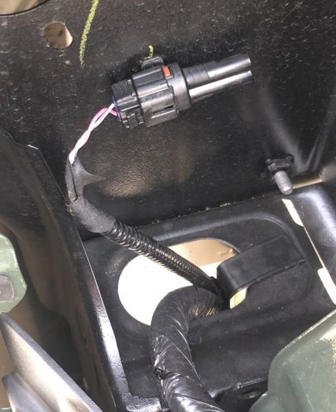

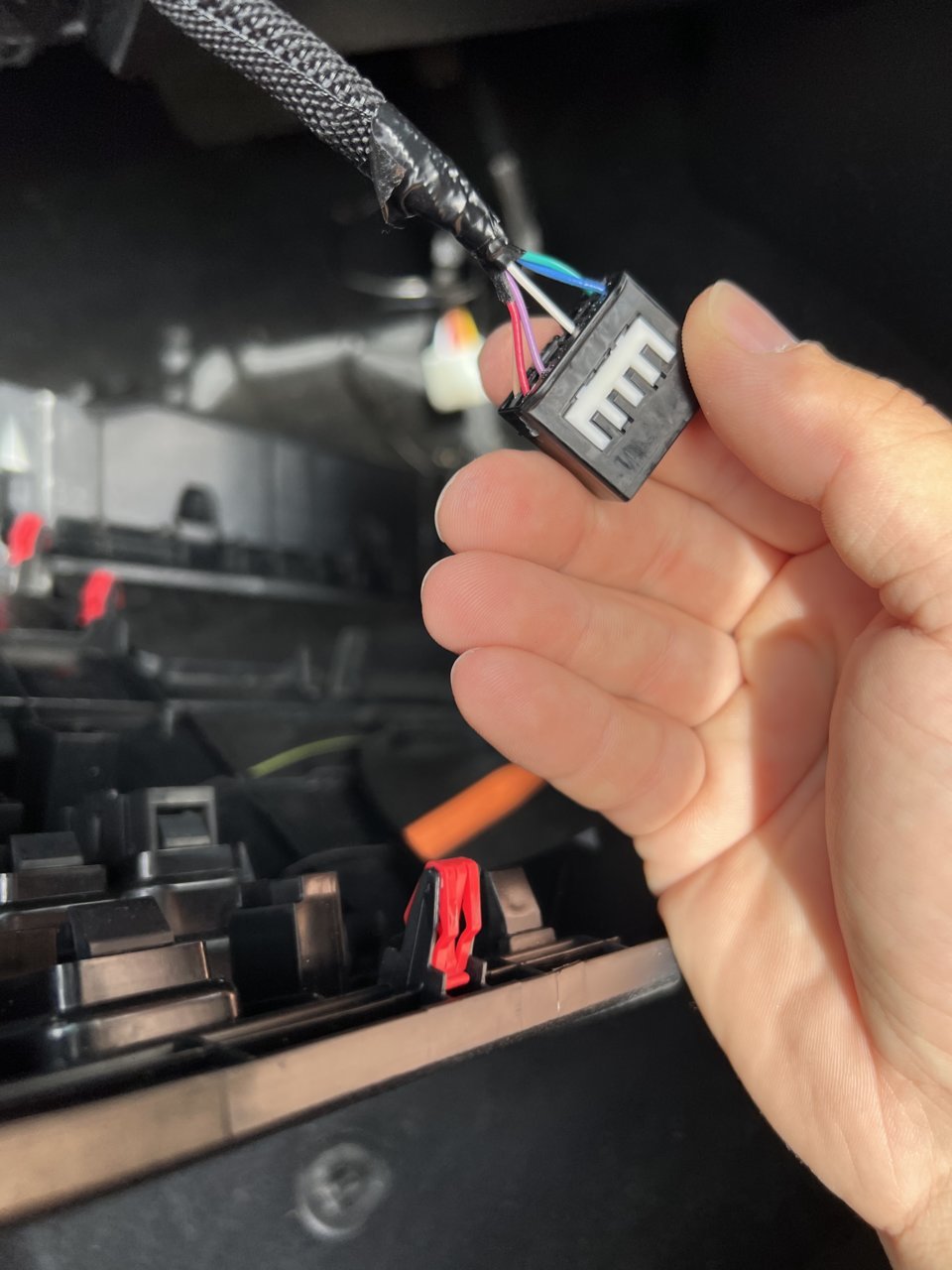

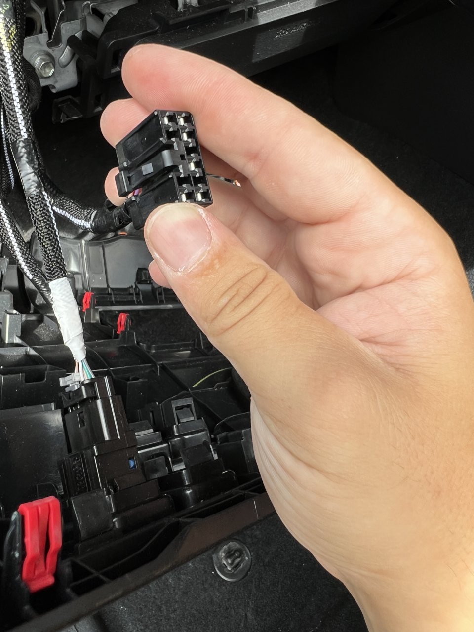

    Had my dash open installing some stuff and noticed this extra plug tied into the factory harness. It was in the automatic high beams area. Just curious how to go about figuring out what it goes to. Trying to find any cheap upgrades for the SR.

    Could be any number of things these days they only really make one wiring harness for all models, could be for the clutch start cancel on a manual TRD Off Road or something.

    Cargo light switch connector. Since you have an access cab you don’t have a cargo light. Toyota supplies it behind the left switch panel anyway.

    Thanks for a super quick response. Good know.

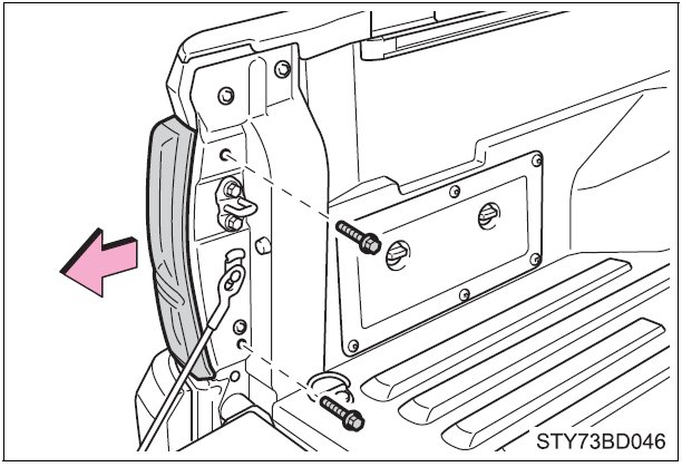

    Do you have these behind the rear lamps?
    2 bolts and a tug to remove and check...

    I just checked and they are there. Thanks for the help people. Might as well throw them in there if the wirings already done.
