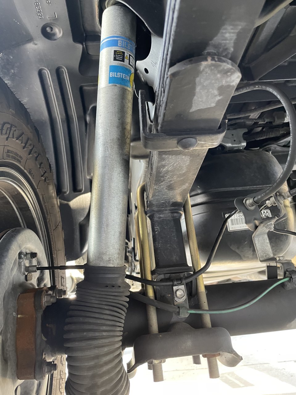

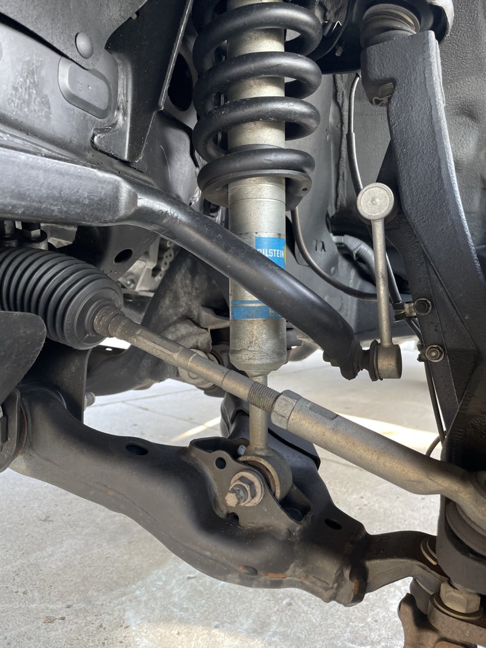

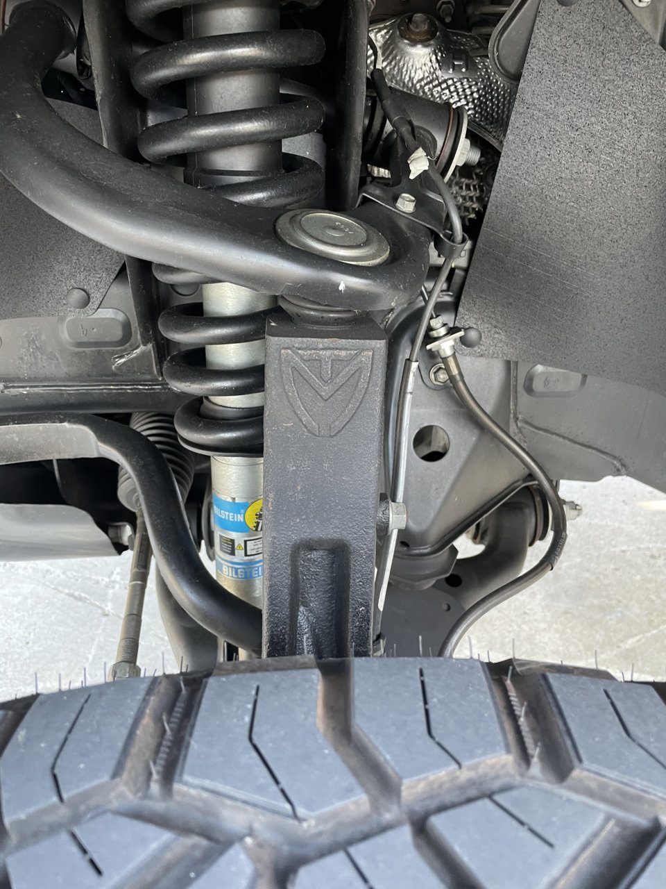

    D1314D2B-EF38-4F7C-B5C9-B0D7A49CBA7A.jpg F025E5BD-746C-4718-AEB0-519B3758747A.jpg 09D85B05-3A4F-435D-ABE7-7FB47B5E7993.jpg 2DA36640-9EFB-4130-A8ED-F452E44FE16F.jpg I recently picked up this 2017 SR5 2wd and it was lifted already.
    What I know/think I know from looking at it and my own research, but thought I would see what the experts have to say.
    Maxtrac spindle lift with Bilstein shocks and a large block in the rear
    The fronts look to be on the highest setting avoiding the needs for any suspension spacer.
    Am I correct? I think this gives the truck a 6” lift, but please let me know if I am right.

    Yea thats pretty much it. Personally the front is set way too high and the 5100 should be set to the 0 or 1 setting.
    Rears is a mega block, you should swap it out for an add-a-leaf and a 1" block rather than the 3-4" block it has.

    Bilstein 5100's set on 3rd clip, with maxtrac 4 inch spindle lift.
    And a 3 inch block in the rear under the leaf springs.

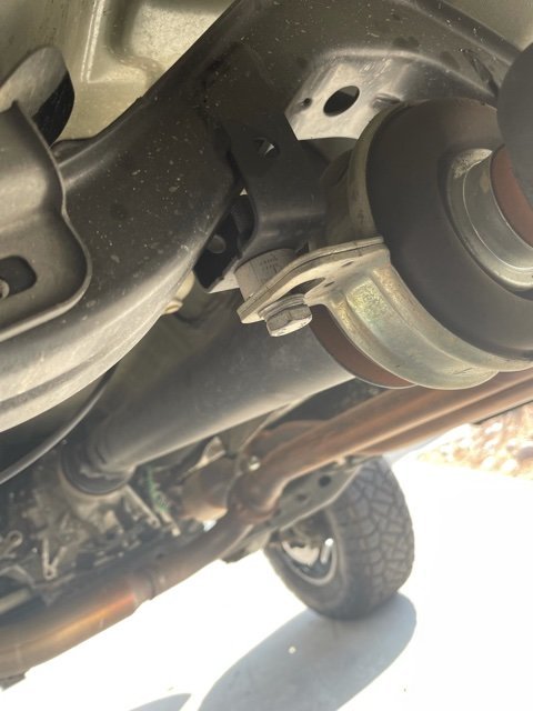

    Is there carrier bearing spacer?
    Shims may be an option on the the rear axle. 1 degree per 1 inch of lift is recommended..

    I do not know what carrier bearing spacers are.

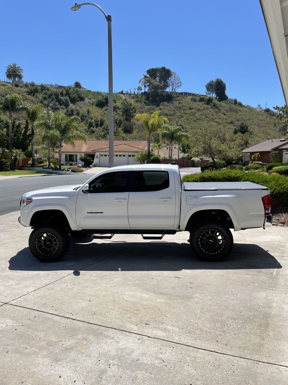

    This truck looks really tall to me, esp in the front. I would consider lowing it a bit
