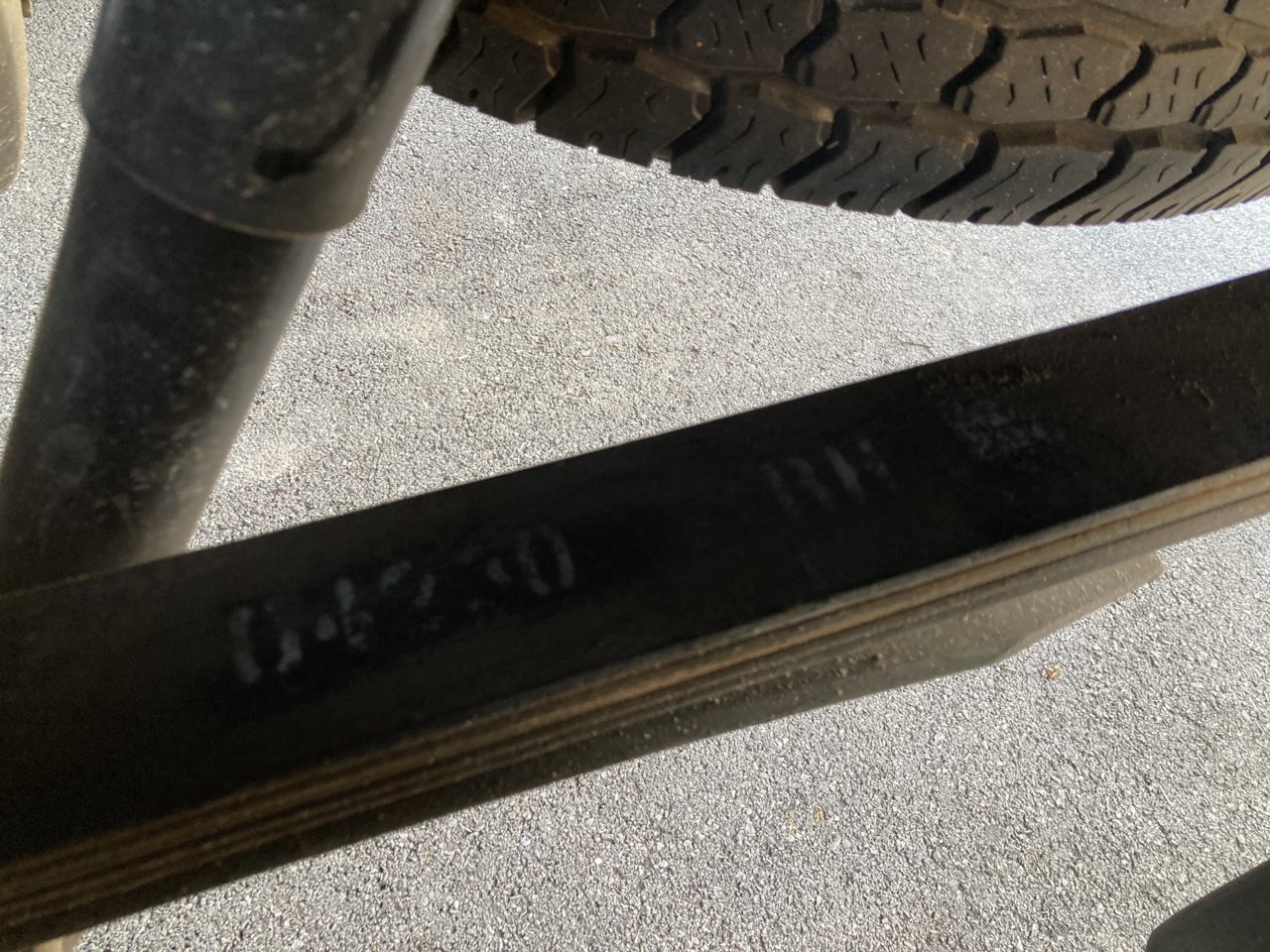

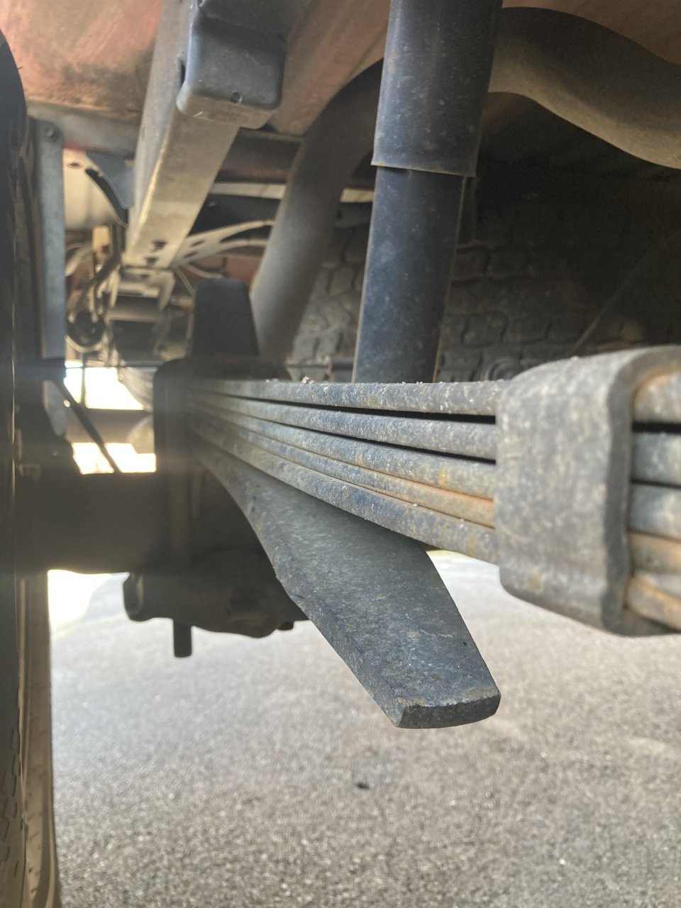

    These non stock/lifted springs were on the truck when I purchased my 99 4x4 ext can Tacoma recently. The driver side sags. I can see one cracked leaf. I want to replace them with with an equivalent to maintain the current rake. The part number appears to be a stock toy #. But nothing I’ve seen under the number has the same number of leaves. Or visually looks the same. I could use some guidance. Thanks Kevin

    They look like Dakars/OME (old man emu). Owned by ARB now.

    Replace the leaf sets on both sides not just one side or one leaf. There is a (one) skinny leaf spring in the picture. It looks like someone customized a leaf pack.

    Yeah. I noticed the thin leaf. I thought odd. I looked up the the OMEs and they are the closest match. I’m going with the OMEs. We’ll see. Thanks so much.

    could been some kind of aal, that would explain the stock p/n.

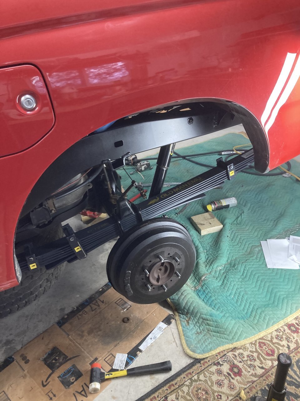

    Springs arrived. Excited! Installing this weekend. Went with OMEs.

    Installed. Thanks for everyone’s help. It drives like a new truck. Best I can explain is “it drives with confidence.
    On to restoring the rims. . !
