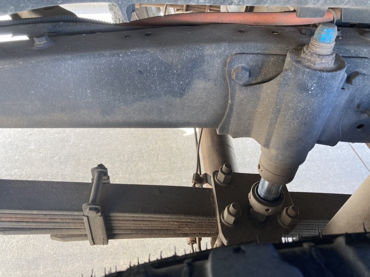

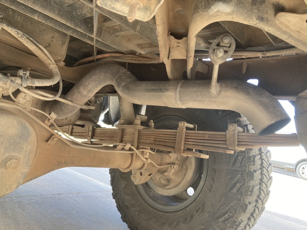

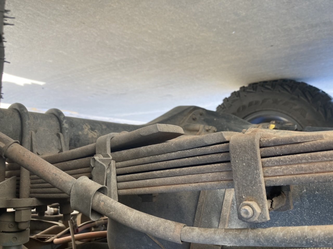

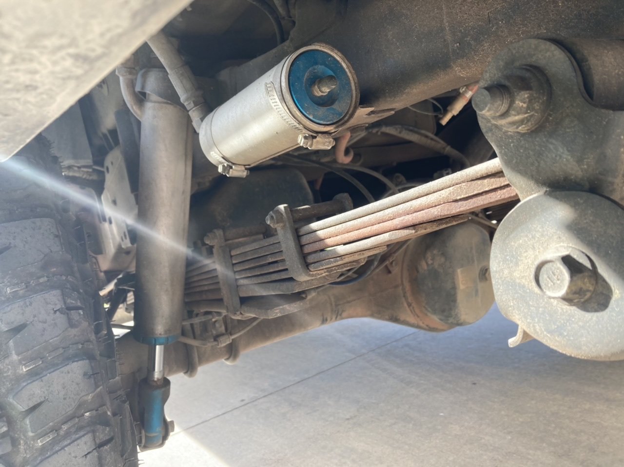

    i would need some help identifying my Dakar springs.
    I bought my truck back in 2018 used and the springs where already installed. Now I added a few more mods and ripcords wedge camper and I think I have to upgrade my leaf springs to accommodate for the higher weight.
    I thought to just add a leaf (AAL) but I need to know which spring I exactly have and unfortunately the stickers on the leafs are not readable anymore.
    So by looking at the pictures, does anyone know which leafs are installed on my truck.
    thanks already

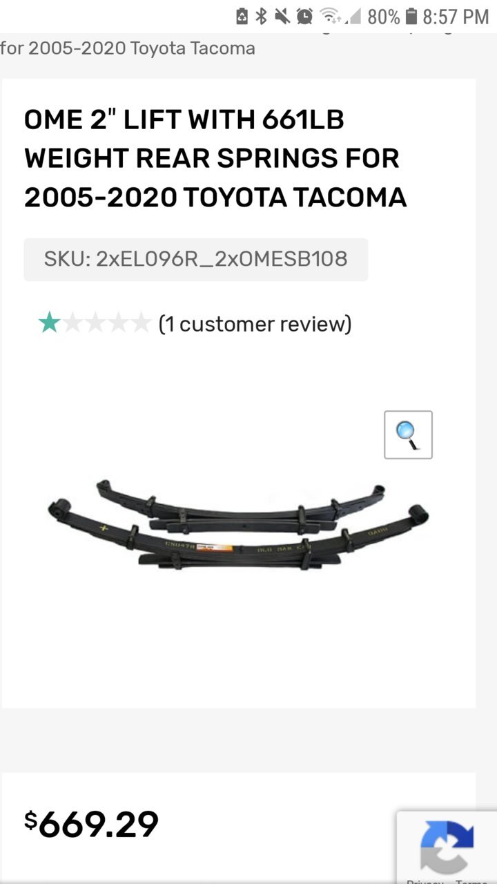

    Looks like the same pack that I put on 2013 and they are the heavy load pack. Same amount of leaves. 096's if I recall correctly.

    Next question would be, if leafs can wear out prematurely when they go off-road a lot (I assume so) and how long do they normally last under normal conditions?
    So do my springs look worn out or just overweight and would AAL fix it?

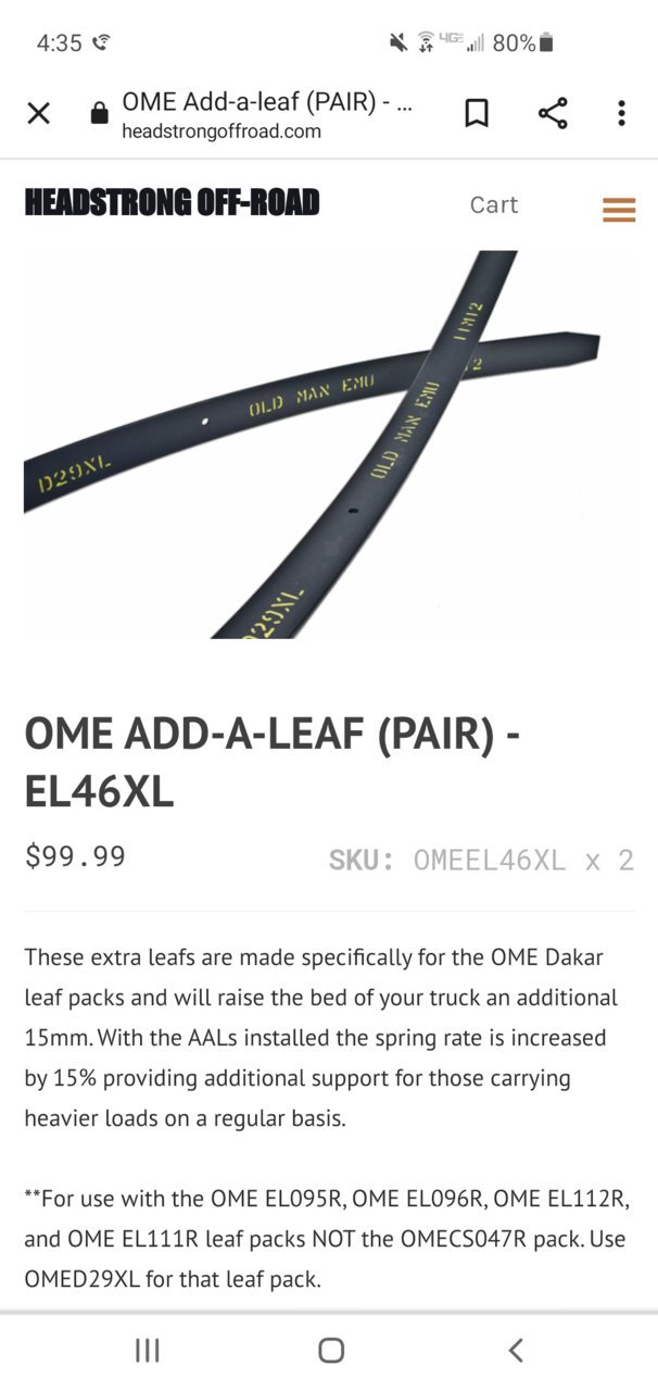

    I believe OME offers an additional leaf that works with the spring pack I posted earlier.
