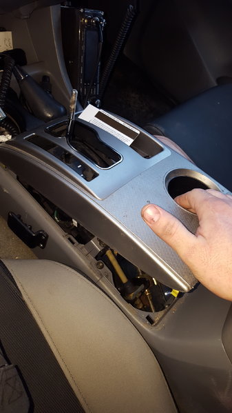

    Unscrewing and removing the shifter knob was easy enough but I don't see the way to remove the plate with the P, R, N, D, etc on it. It seems like it should just pop off but I'm reluctant to get rough with it like taking something to pry it loose. Could you instruct me about removing that plate?

    Here are a couple pics

    Thank you both Yancy and marinetto. I've been able to remove the cover now and with it out of the way my shifter works smoothly. It's really dirty under there so now I'll set about cleaning it good. Then when it's replaced I'm sure the problem will be fixed. Thanks for helping me learn something about my rig!
