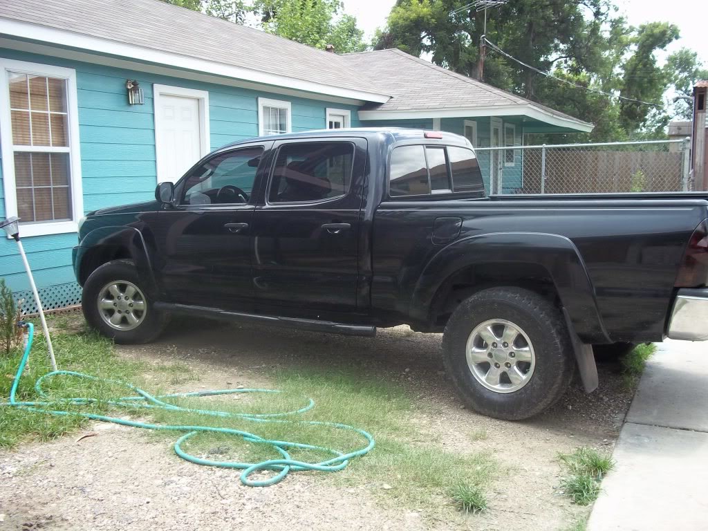

    I've been working and saving all summer to lift my 05 Tacoma DC 2WD Long bed 3 inches. I was pretty sure that the money would make my truck look how I wanted until I came across a thread that showed Long bed lifted Taco's. The thread showed 3',4.5', and 6' lifts. The OP made a comment about how 3' DC Long bed trucks barely looked lifted when having a 3' lift. After viewing pictures he was right. I dont do any off roading, but I did want a versatile lift; that is I like to have the option to be able to do a decent/good trail, but a 6' is too much. I have a 3k Budget, which sounds like a lot but when doing the math its barely enough (Maybe I've been looking in the wrong places?).
    I've been looking at the DB long bed thread religiously, (and I dont want to offend anyone, there are beautiful Taco's there) but I only saw two Taco's that looked the way I wanted them (Sooner021, and DTacoms). I'm pretty sure they had 3' lifts. If it isnt to much to ask could you guys post DC Long beds with 3' lifts, the brands/equipment, and how much you all spent (if you all do not mind). I just want to make sure when its all done my Taco looks the way I want.
    What I planned:
    OME 3' lift-$700
    UCA's-$500
    AT 285/70/17's-$1k
    Konig Countersteers-~$700
    Equals ~$2,900
    0012_b5571aebdd41874baf7500daf19fc87435c84c27.jpg ^ My Taco, if it helps.
    TL/DR: Can you guys please post Long Bed with 3' lifts, how much you all spent, and what brands/equipment you used to lift them.
    All help appreciated, and thank you in advance.

    Since you're a prerunner, you could go with 4'' lift spindles instead. That would eliminate the need for spending 500 on ucas. You'd still have to get rear lift options, which are relatively inexpensive, and extended brake lines and such, but you'd end up at about the same price you are now but with more lift.

    No actually it's the opposite. Spindles are a preferred lift for Prerunners because they keep the stock geometry (or so I've been told) and don't require new springs/shocks/UCA's. They are a great way to achieve 4 inches of lift or more, depending on how much you want. Spindles would look great on your truck. If you got the OME kit with the spindles, you'd have 7 inches of lift, which I don't think you want.
    You can get just the spindles/wheels/tires and be at 4" of lift with nothing else, but then you'd need something for the rear.

    I agree with the 4" or even a 6". The "problem" with the DCLBs is that a 3" lift isn't near as impressive (looks wise) on that long of a truck. A 3" on a regular cab looks pretty big, whereas a 3" on mine (Access cab) is just noticeable from stock, and IMO a 3" on a DCLB still looks like stock height as far as the tires/height in proportion to the body.
    It's like those guys with DCLB full-size trucks, anything less than a 6-8" lift is barely detectable and 35" tires look tiny, but a Suzuki Samurai on 35" tires looks like a little monster truck.
    When looks are the main goal, proportionate (tire size to body size) is the goal IMO; and you need a big enough lift to fit those proportionate tires.

    I agree, but 6' is just to much height and money for me. I'm 5'5'. I'm already jumping in the truck at stock height haha. 4' spindles it is, with 2' AAL's. 285' tiress might not look big enough, but these trucks are not economical as it is, and the big tires doesnt help. That's why I'm somewhat limited to what I want to do.
