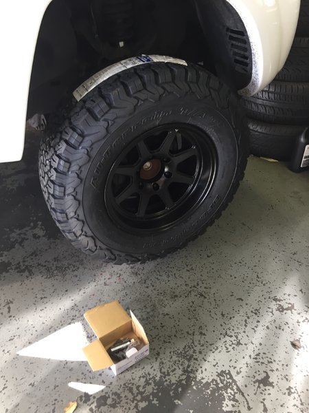

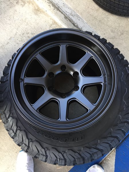

  9. Nov 7, 2016 at 9:54 PM
    #29
    Larmo63
    Larmo63 Well-Known Member
    Nov 4, 2016
    #201559
    438
    SoCal
    2019 Tacoma Access Cab TRD Sport
    I just mounted these today. KMC XD wheels with 285/70 - 17s BFG KO2s. Trimmed the front inner wheel trim at the tire store, still needs a bit more. No lift yet, great ride on brand new 5100 Bilsteins. I'd like to level it. IMG_4684.jpg

  10. Nov 7, 2016 at 9:55 PM
    #30
    MonkeyWrench462
    MonkeyWrench462 [OP] Well-Known Member
    Jan 18, 2016
    #175273
    84
    Christopher
    Minnesota
    2013 Tacoma TRD
    K&N Air Filter, Supreme Suspension 3" Lift, Daughters First Pair of vans from Mirror
    I noticed that on mine too!! Have got a brand in mind?

  12. Nov 7, 2016 at 9:55 PM
    #32
    Larmo63
    Nov 4, 2016
    #201559
    438
    SoCal
    Pretty exciting to get new stuff mounted....!!

  14. Nov 7, 2016 at 9:56 PM
    #34
    Larmo63
    Nov 4, 2016
    #201559
    438
    SoCal
