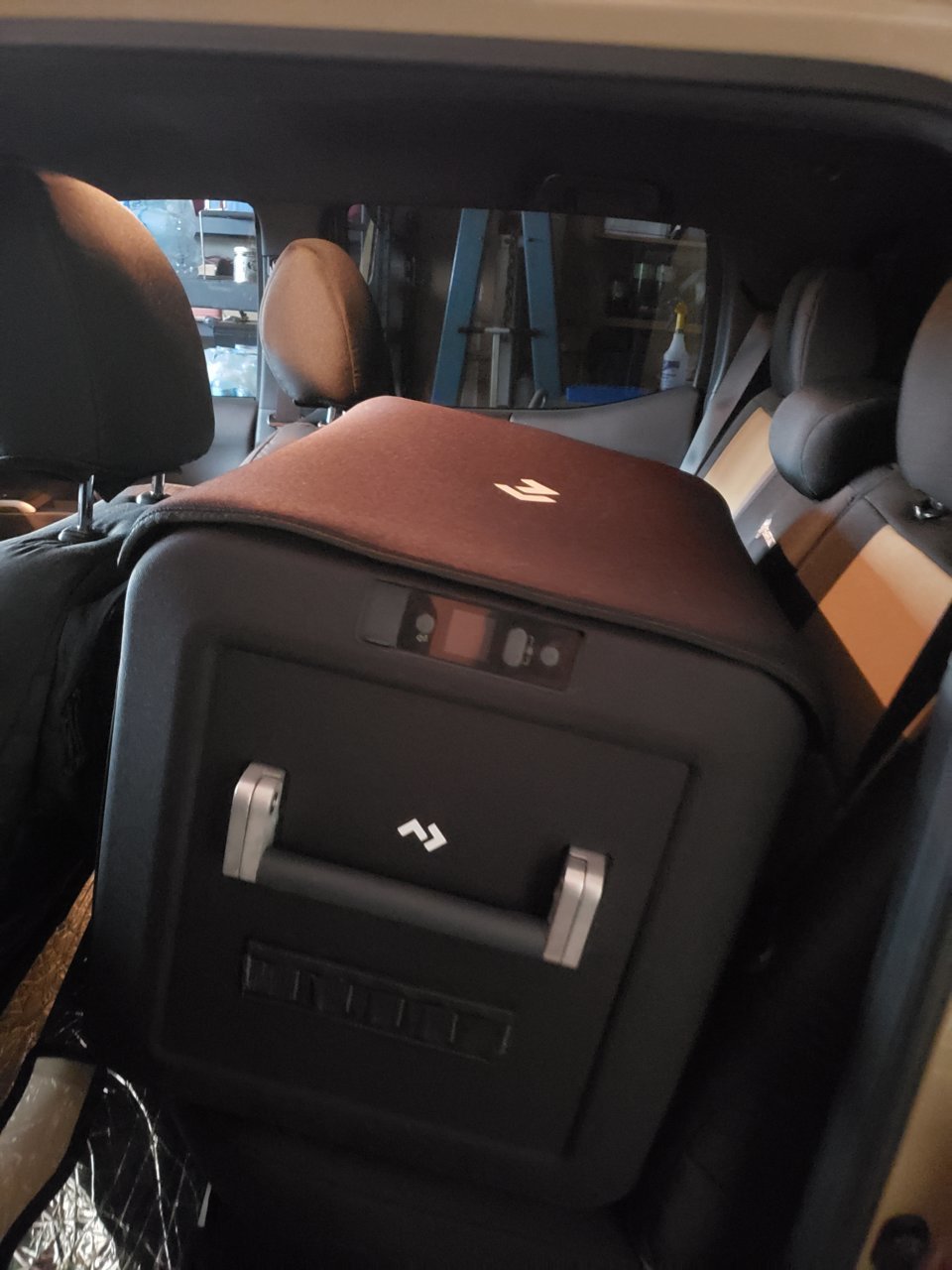

    A 55im in the back seat of my truck. I got it when it was on sale with free shipping.
  18. Jul 14, 2020 at 9:27 AM
    #18
    Newlife
    Newlife Well-Known Member
    Jun 22, 2013
    #106845
    8,570
    Adam
    Knoxville TN
    2020 t4r orp
    Bone f’n stock for now
    :drool::drool::drool::drool:
