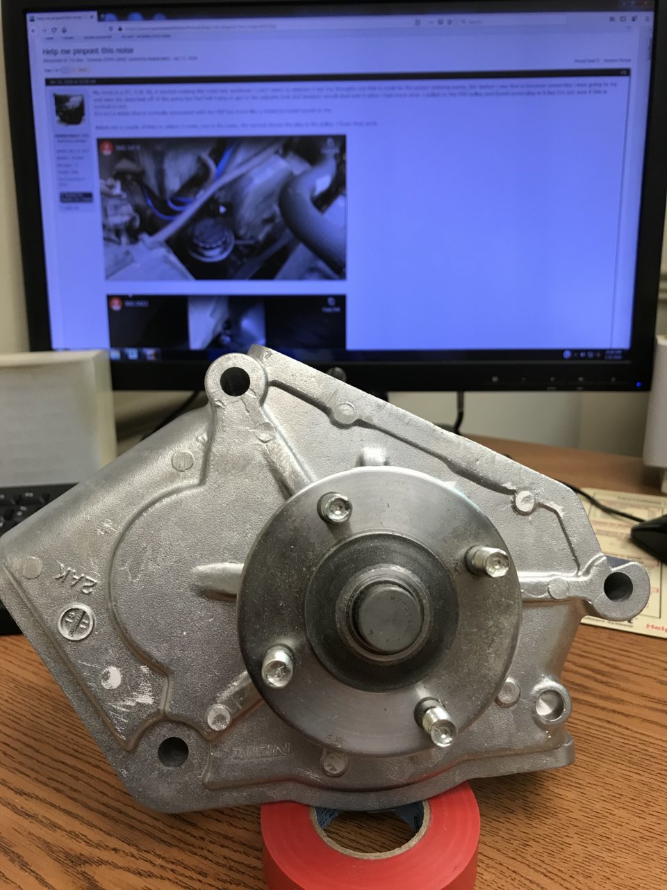

    Oh believe me, I've read enough to now the Aisin is the way to go on this part. Thanks

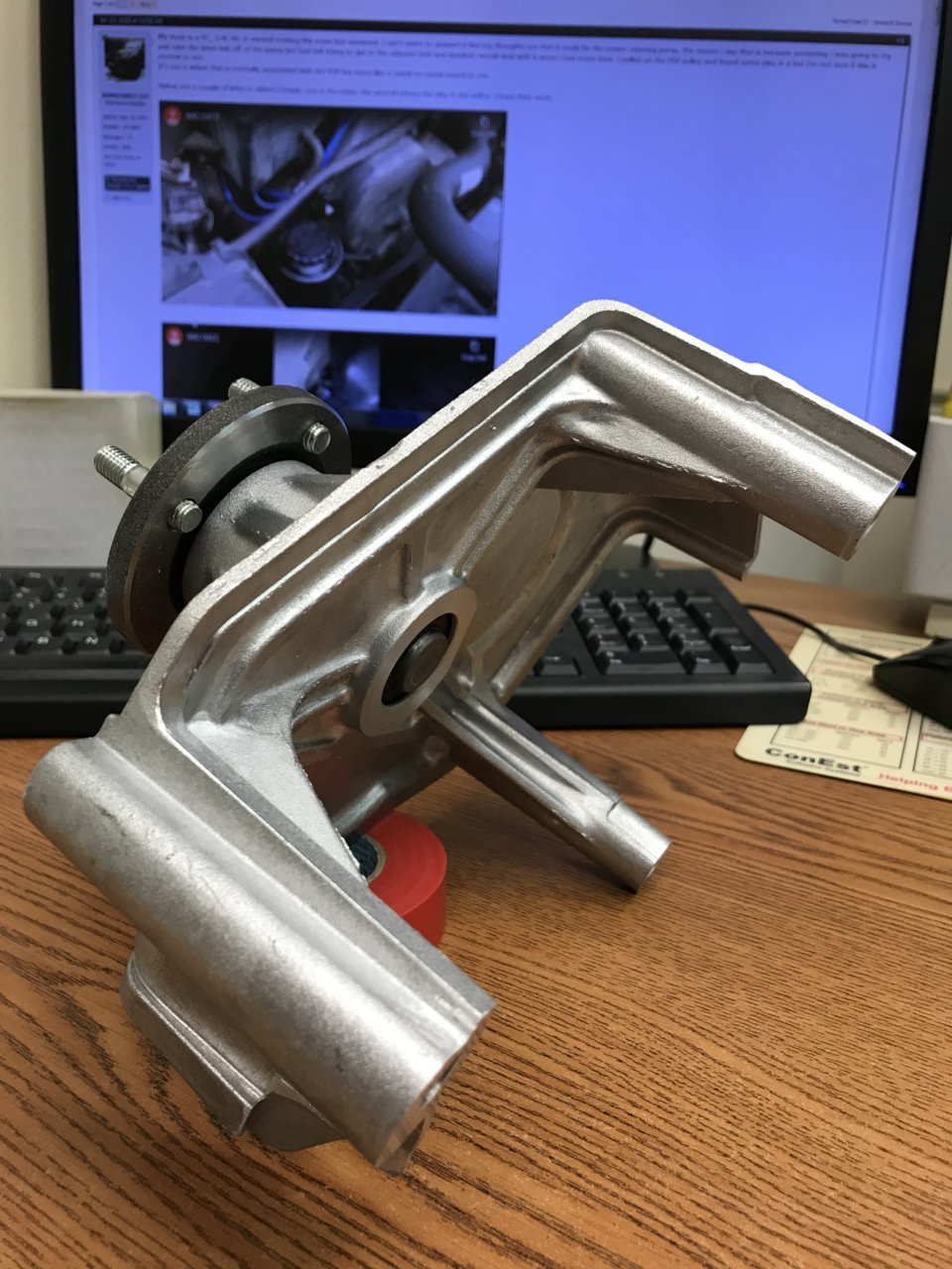

    The Aisin fan pulley bracket was just delivered, I'll get this bad boy installed in the next couple of days and hopefully that will resolve my issues. I've got some sick days that never get used so I might have to come down with a stomach bug before the end of the week and take care of this.

    So, I swapped out the old fan pulley bracket for the new Aisin bracket from Rockauto. As i stated Earlier in the thread, I pulled the belts individually trying to diagnose the problem, even bought a stethoscope to help, after using the scope and removing the last belt(alt.) the noise went away.
    This lead me to believe the sound was coming from the fan pulley bracket, well, after installing the new bracket yesterday and staring up the truck the noise came back, still intermittent but still there.
    Is there a chance that the alternator pulley may be going bad, it’s the only thing I can come up with at this point.
