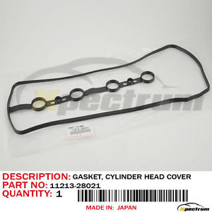

    I'm not familiar with the 4 cylinder in the Tacoma, but there should be an inner valve cover gasket that goes around the spark plug cylinders. If that leaks it can cause your issue.
    For reference.

    The leak is likely so little that you'll notice no oil consumption. The coil packs would only have oil on them if the leak was significant. Those o rings that seal the spark plug wells are almost certainly your issue.
    If the leak was significant, those wells would start to fill with oil and cause misfires.

    At this point it's not really hurting anything other than making a bit of a mess on the spark plugs. If you don't want to change them now, I would just keep an eye on it. When it gets worse go ahead and change it. Reason being, like I said, once it does start making contact with the coils it will short out and cause problems. When you change them, change the regular valve cover gasket also. They should be done as a set.

    2009 DCSB SR5 TRD Sport 145k miles
