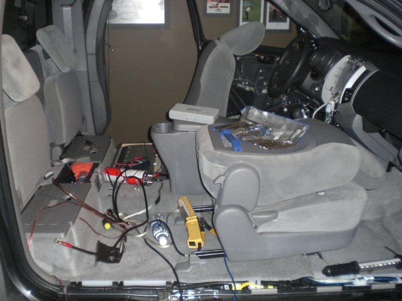

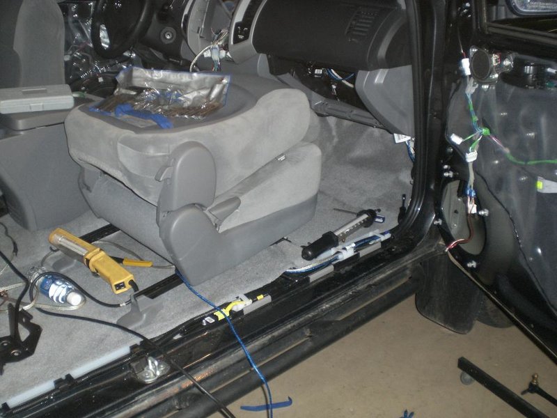

    those are all good ideas. thats kinda what i did but instead of a zip tie i used a electrition snake. woked awesome its stiff but flexible and long as you need it. the sill plate works real well also i ran mine under the carpet under the seat for my amp wires. here are a few pics if it helps. good luck.
