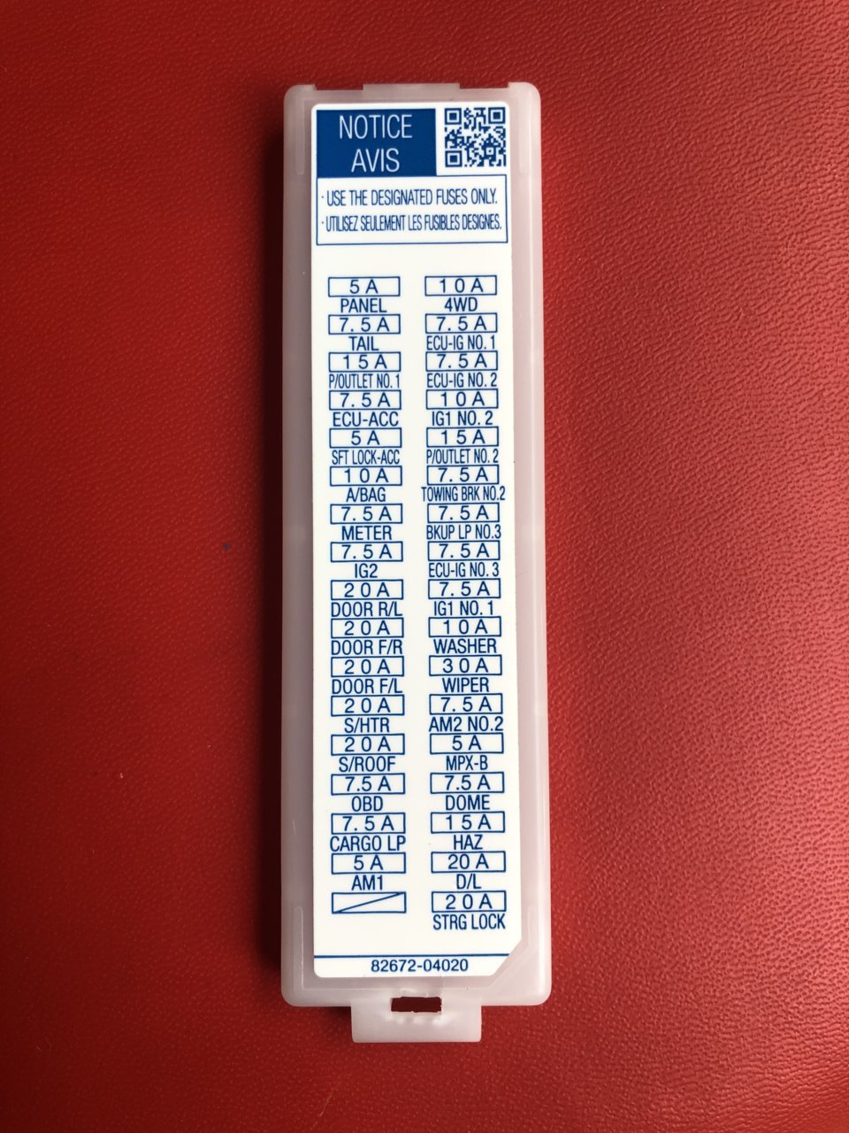

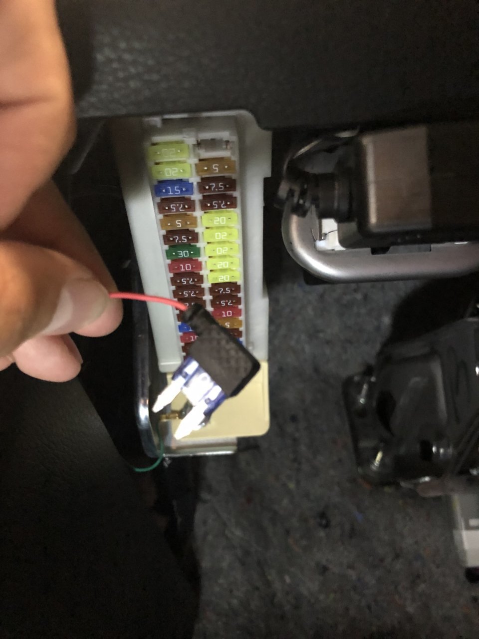

    I have read all the post and not sure what fuse connection was used for dash cam. Did you use "S/ROOF" 7.5 A ???
    Not sure if I should use a add-a-fuse or plug my Rexing hardwire directly in?

    S/Roof is 20A You have the numbers mixed up. Dash cam you want constant hot and the S/Roof would work. Your add a fuse is the wrong size.
    This is the right fuse tap
    https://www.amazon.com/gp/product/B00EO571Z4/ref=ppx_yo_dt_b_asin_title_o07_s00?ie=UTF8&psc=1

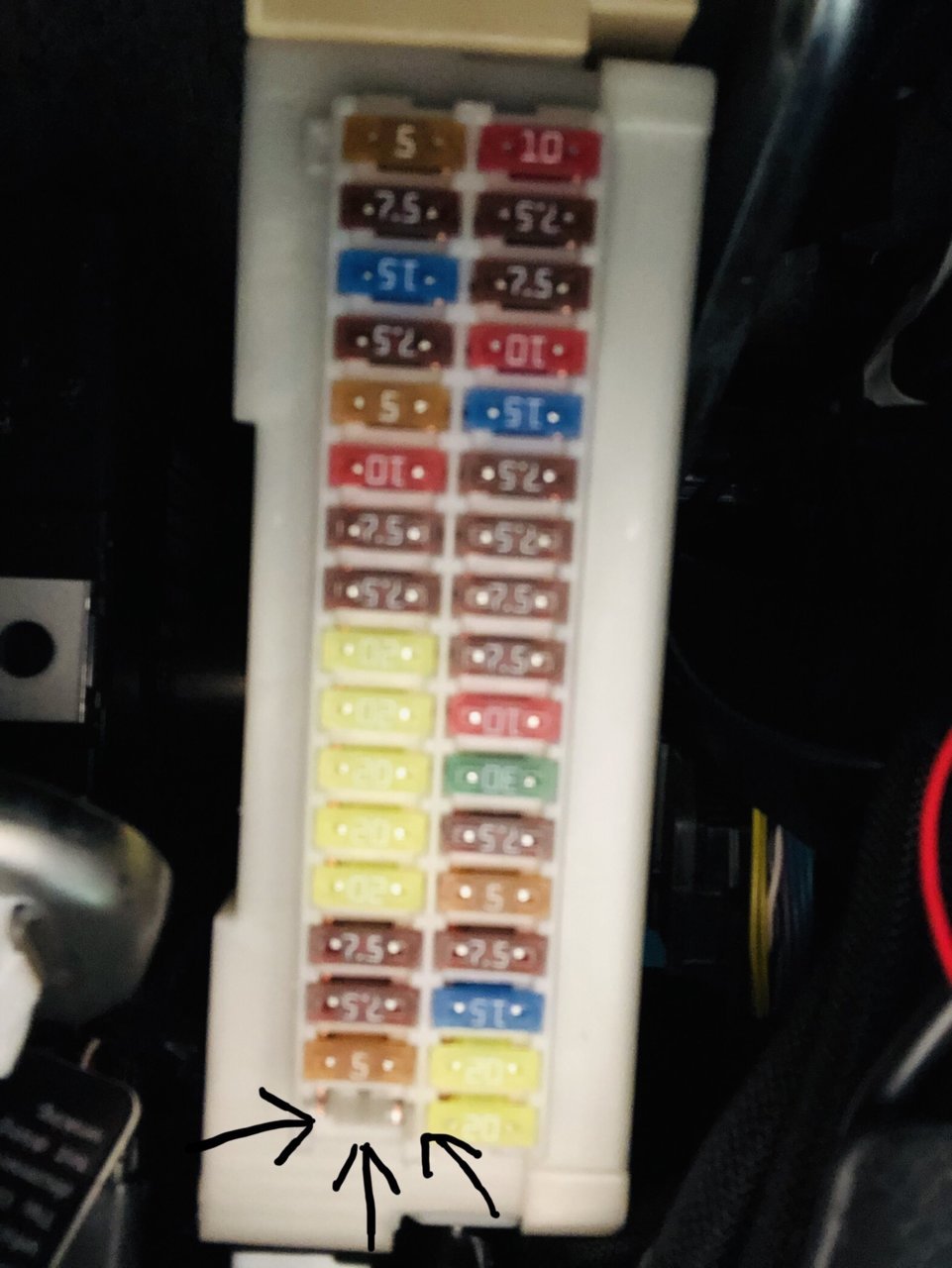

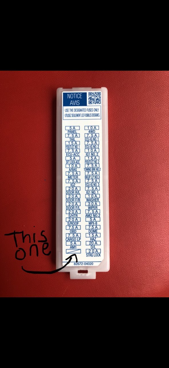

    Thanks for the info. Does it matter if I don't have a sunroof, can I still use the fuse 20A?
    I was able to get constant power from the bottom left open fuse. I have no idea why fuse port is empty/open.

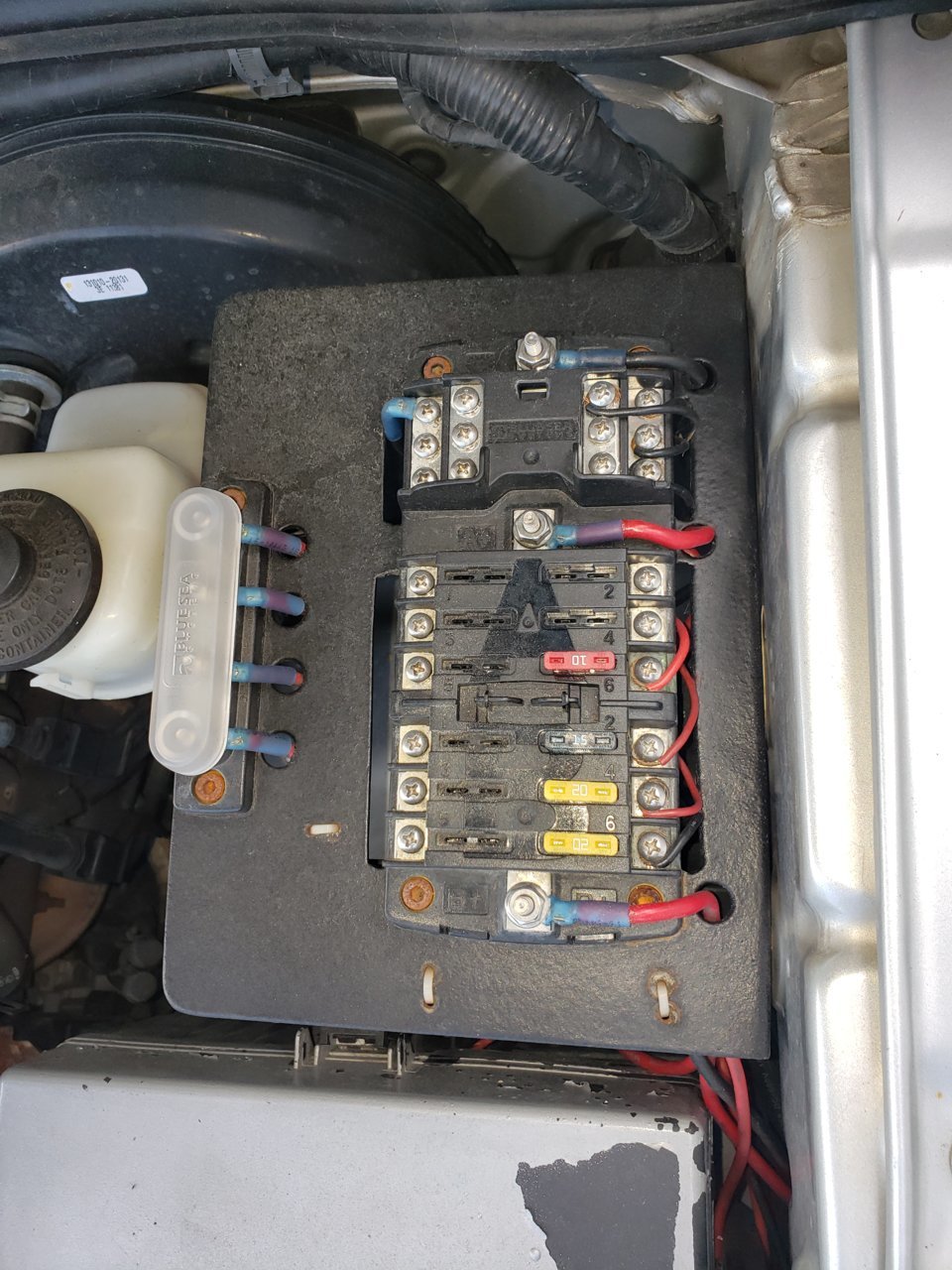

    Here is a pic of it with the wires set up and a few of the circuits in use.
    (One day I will replace the bolts I bought that rusted)
    The 2 units bolted to the metal support(I made that as well) are the fuse block and a 4 position bus bar.
    1 spot on the bar is attached to the battery +, as I didn't want to stack a bunch of wires on the battery.
    1 spot goes to the always hot connection on the fuse block.
    1 spot is for the switched circuit. That wire goes to a relay. Then the wire continues onto the proper connection on the fuse block.
    The last connection is for my large spot lights on the truck. The wires in the harness were pretty big and the end didn't fit in the fuse block very well. (Down wire it has a fuse and relay)
    The relay that controls the switched circuits has a wire attached to a switched circuit in the trucks oem fuse box using a add-a-cicuit.
    I did not want any more wires hooked up to the Tacoma's electronics then necessary, so just the 2.
    Not as fancy as some of the setups I have seen on here, but this fit my needs, budget, and it feels good to design and build something yourself.
