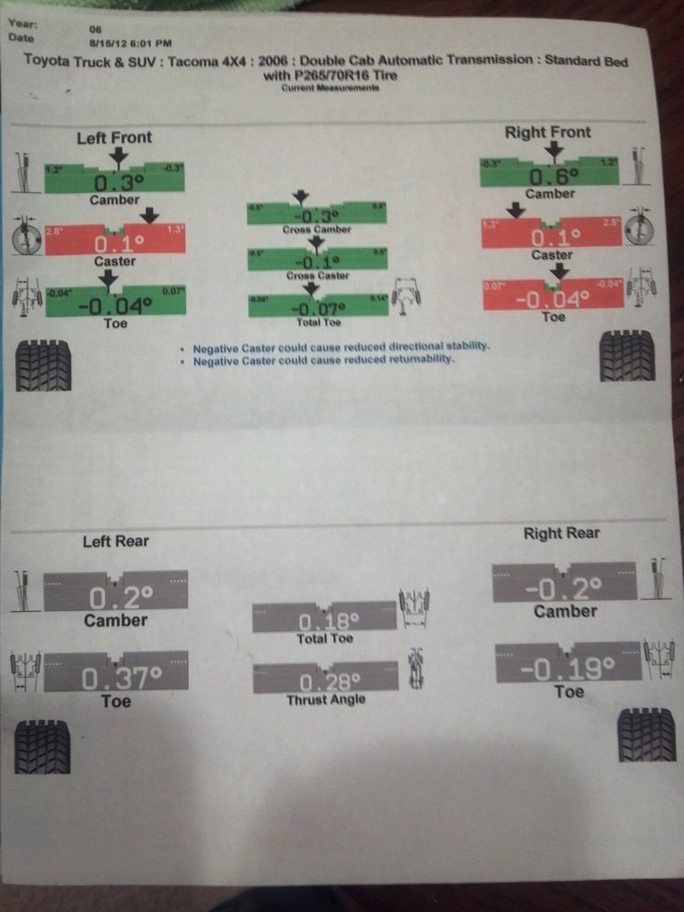

    I've lifted my truck, OME 3". The UCAs and LCAs are both factory, can I get better specs out of this setup.

    yes u should be able to a little.... that shop didnt even get ur right toe in???? wtf?

    Good setup:
    Toe 0.0
    Caster L +2.4
    Caster R +2.8
    Camber L 0.0
    Camber R 0.0

    I don't see how you'll get better than that. I can't do better than that at 1.75 lift. They should be able to get your toe straight though
