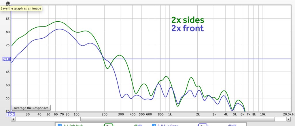

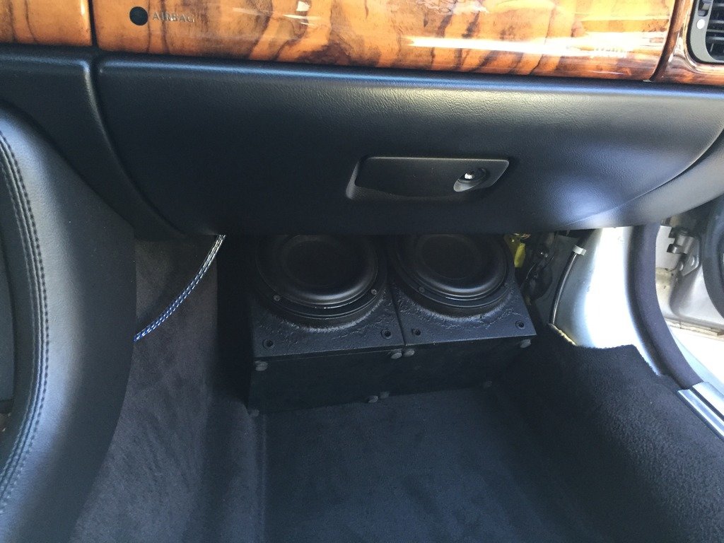

    I've been looking into the feasibility of small subwoofers in the rear speaker locations in my 1st gen...specifically the Tang Band W6-1139SIF 6.5 inch subwoofer.
    This is in the floorboard of a convertible and again toward the rear side panels
    I imagine given the transfer function of these trucks, these could be something special.
