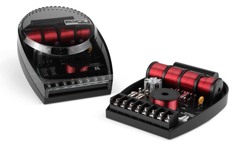

    You do realize you can route frequencies without additional crossovers, right? Passive crossovers are evil. They're a compromise.

    anyways, the sort of external crossovers that come with quality component speaker systems are really quite good.

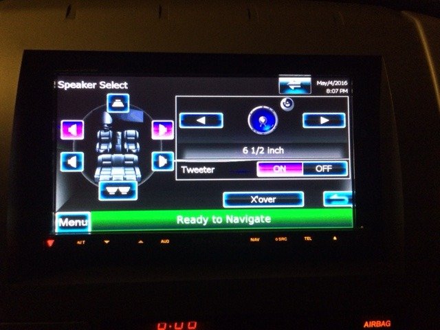

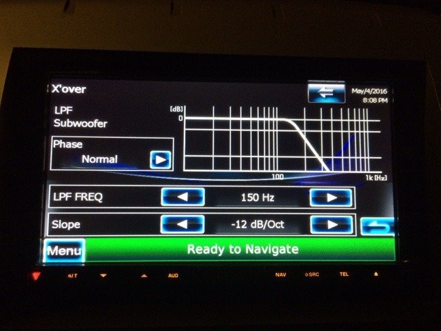

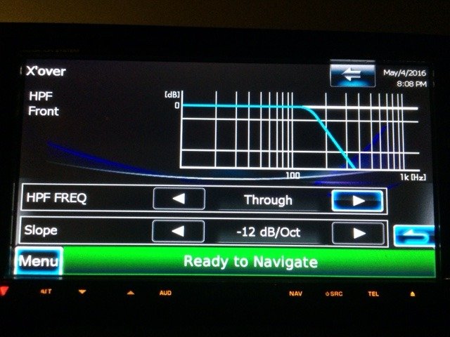

    I got a hold of some bad information earlier Primer. Your head unit won't do the active thing after all. I just got done going through the owner's manual and although you have lots of control with that thing, you only have high or low pass filters. So you'd need a passive 2-way system if staying with head unit power (something efficient). You'd need in-amp or external processing to do the active thing. You can do the passive with an amp too.

    This is a test
    I don't love the Kenwood UI for this. But here goes. The HU has the option to set crossovers for a front center, two front doors, two rear doors, and a sub.
    This is what it looks like:

    These are the screens for changing the crossover frequencies:
