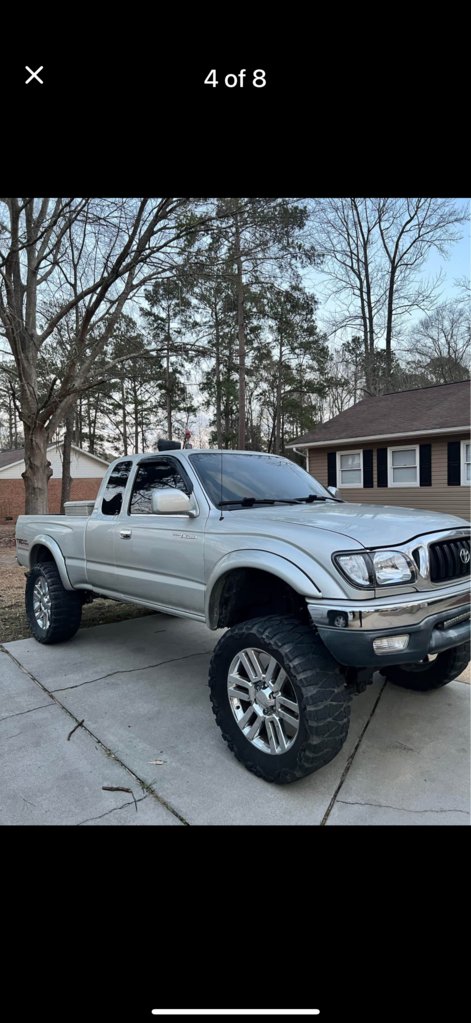

    I recently bought this ‘03 Tacoma for $9500. He wanted $12000 but I was able to get it for less. It’s a very clean truck, it’s been a South Carolina truck its entire life and not even a hint of rust anywhere. I don’t like the 6” rough country lift or the way it sits, is there any way I can level it out or maybe take it off and out on a 2.5” lift? The mud grapplers are decent, I’d never order another set but they honestly don’t ride as bad as you’d think. They have about 10,000-15,000 left in them. Only thing majorly wrong with the truck is it’s going to need brakes soon, slight play in the steering but truck doesn’t wander all over the road, and honestly that’s about all I can say bad about it. It has 248,000 miles on it and I’m taking it in to the shop for an oil change Friday and get them to give me a quote on the brakes and coolant flush. Any suggestions or questions would be welcome!

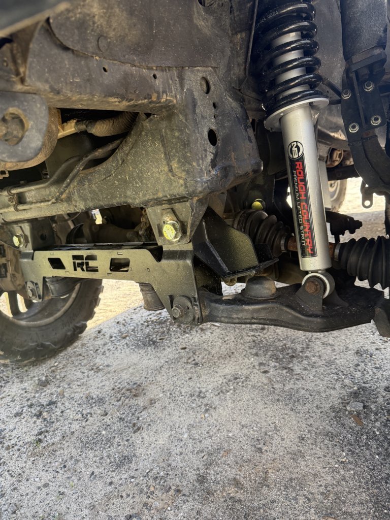

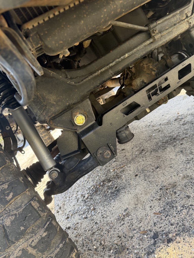

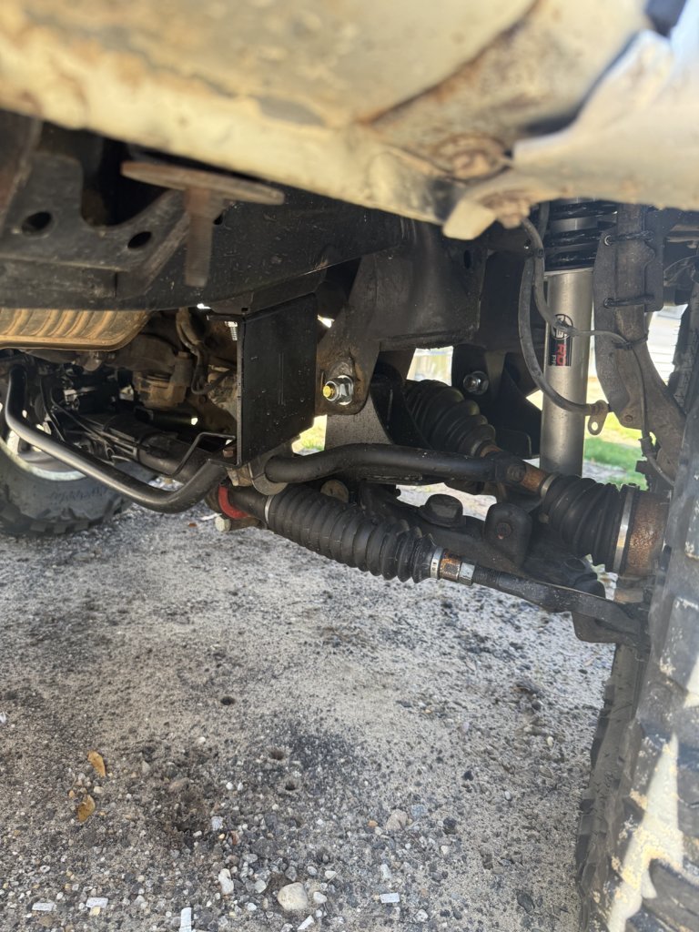

    Haha, I was just messing with you. But yeah I'd bet they cut the frame. Snap a few pics of that drop bracket and the area around it, and upload them, so we can see and hwlp you determine if thats the case. Maybe you'll get lucky and find it was bolted in, but that's typically not the case

    Here’s some pics of the lift.

    Yes, cross member is cut in place of the drop bracket
    Option 1 - find a donor and cut it off to weld it to your truck. Been done before.
    Option 2 - solid axle swap your truck

    That truck will need to go to a bodyshop and see what can be done. Your going to need a frame technician to see what he thinks. It can be done.

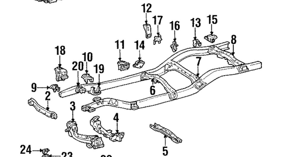

    Well, Im in the business. The crossmember you posted is incorrect. I believe its #3 in the diagram below. That part is $1009.13, plus labor. $2500 ish depending on frame rates where you are?

    Thank you for giving me the right info. Yeah, I’m definitely not going to sink that kind of money into it. I might just drive it for a year, do the basic maintenance and send it down the road.lol

    If you got to the Rough Country website you can download the PDF for the install. It will show you the portion of the rear crossmember and frame that were cut for the install and would need to be repaired.
    I think it is part #4. The front looks stock.
