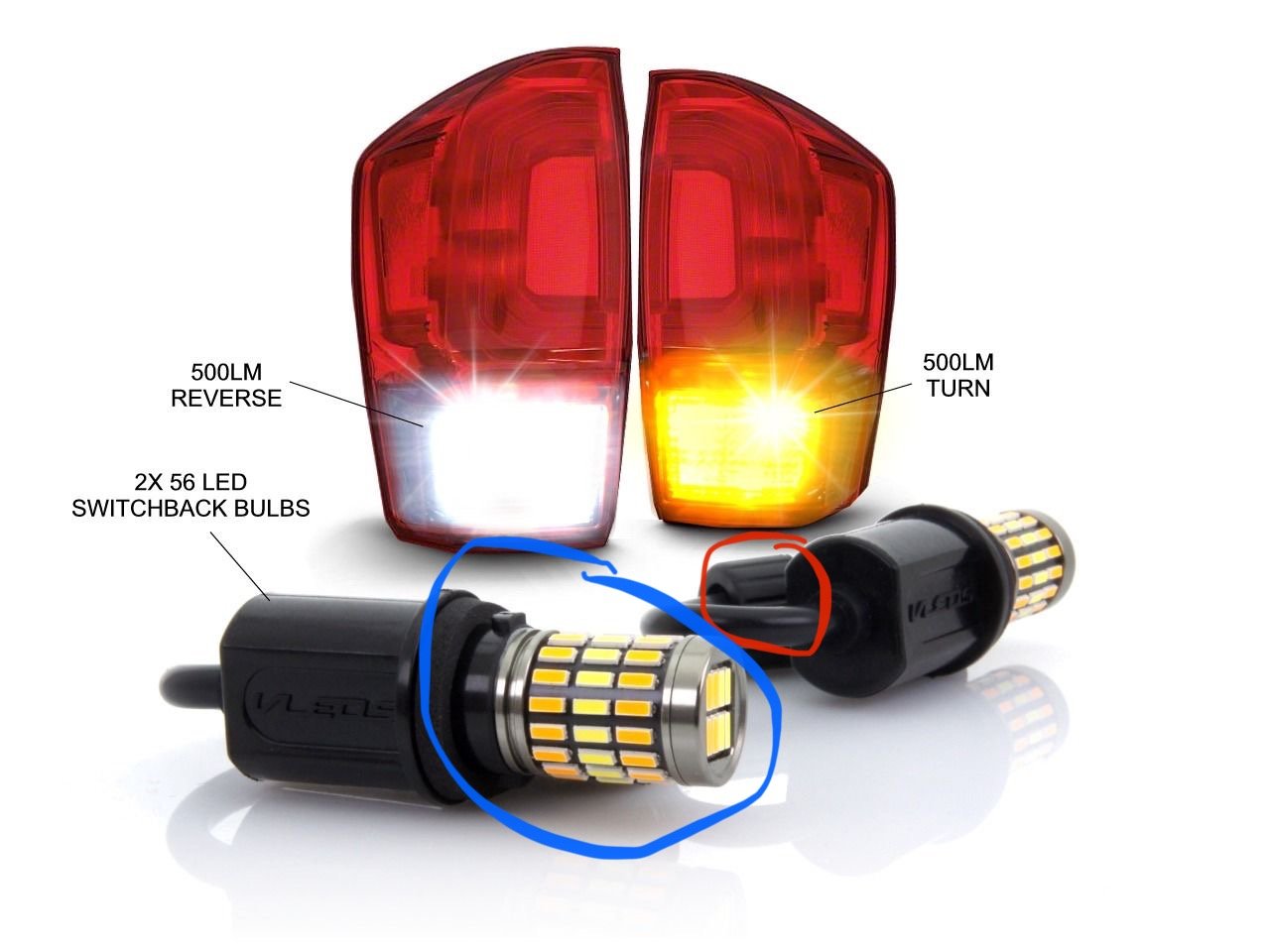

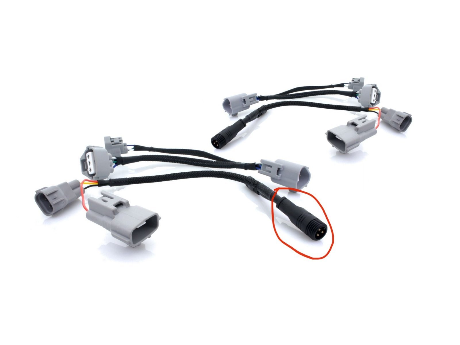

    I’m gonna ask again…..what are we rotating here….the bulb (the part putting out light - blue circle) is fixed to the housing it’s in. The cable is attached to the housing. The end of the cable connector (red circle in both pics) is keyed. You can not flip anything, it can only go together one way.
    The gray connectors that go to the truck can also only go one way. How is anybody going to flip anything?
    This is not a bulb that goes in a socket….

    That harness only plugs in one way - would need to depin to flip the wires. Harness definitely could have just been made wrong which is why I suggest testing by moving the harnesses from side to side to see if the problem stays or moves.
    Definitely can’t do anything at the bulb at all.
