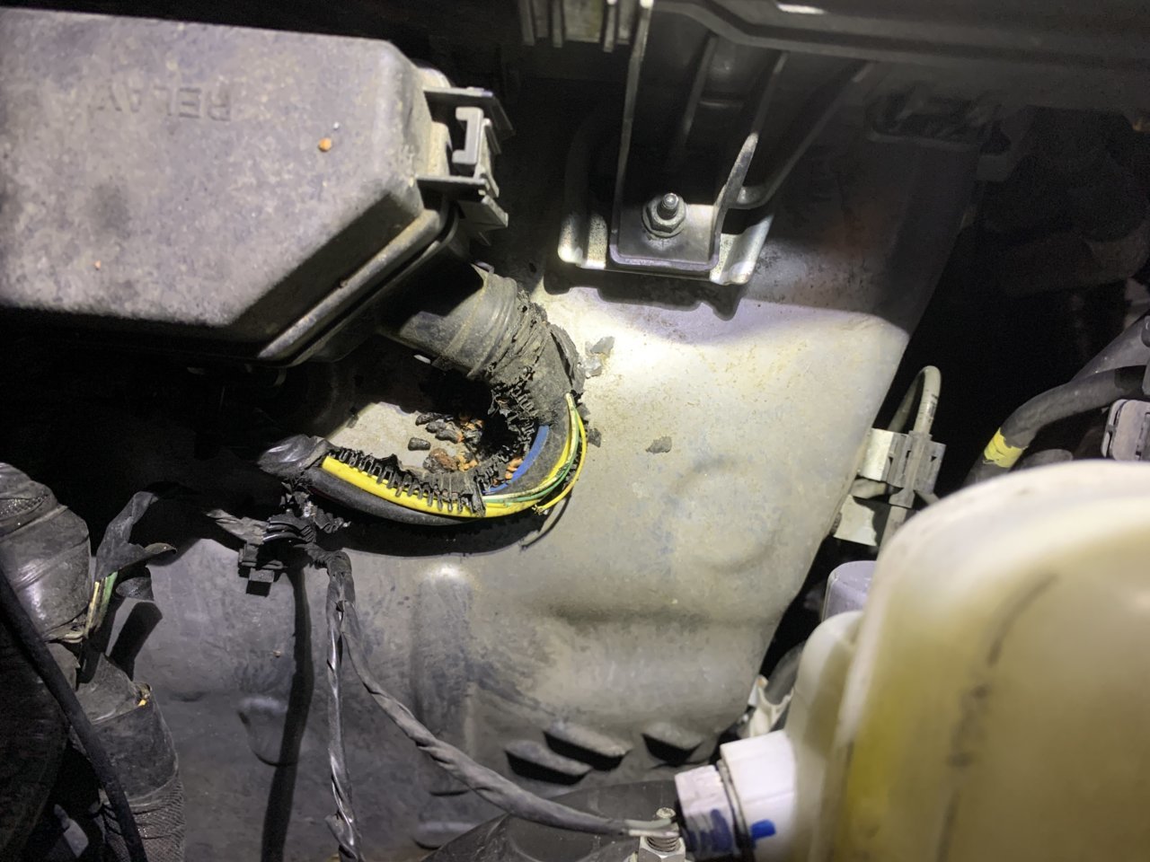

    History: I haven't driven it for around a month. went to drive it the other day and it had bad misfiring. I had to turn around. The only thing I can think of since then was that we've had a decent amount of rain in norcal and I have a hole in the right rear taillight, i noticed the taillight was full of water covering the reverse light bulb. drilled a hole at the bottom and it's drained now.
    Anyway, pulled codes and main issues are random misfire, cyl 3 misfire, cyl 5 misfire, and a few more codes that could be related or not relevant. I'd be surprised if it's as simple as 2 spark plugs failing at the same time. I'm thinking worst case is it's electrical due to the taillight. Could also be squirrel damage since we've had them recently. Just looking for some advice before i start busting things open. Any help appreciated
    Full code list below:

  2. Feb 9, 2021 at 5:43 PM
    auskip07
    auskip07 Well-Known Member
    Jan 1, 2019
    #277665
    4,375
    Skip
    Atlanta, Ga
    2019 TACOMA SR V6 SC , 4X4, AUTO, 4.88, 265/75 r16
    might want to check for chewed wires.
    BigWhiteTRD and tacotoe like this.

  8. Feb 9, 2021 at 6:16 PM
    crzycav86
    crzycav86 [OP] Well-Known Member
    Sep 4, 2015
    #163411
    51
    Houston
    you guys are some wizards. i found one yellow wire cut all the way through. some damage on one of the wires next to it. (this is the wire harness underneath the brake fluid reservoir). i stripped and reconnected and i'm resetting the battery to see if it'll fix. I'll also check under the plastic covers tomorrow like someone else mentioned

  13. Feb 10, 2021 at 6:32 PM
    crzycav86
    Sep 4, 2015
    #163411
    51
    Houston
    repaired the harness and reinstalled. seems to be working fine now. CEL is gone... i'm going to drive it around a bit tomorrow
