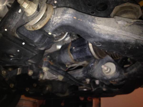

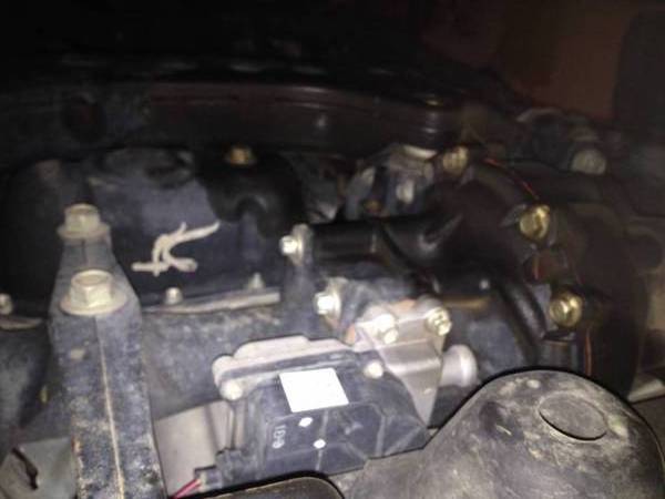

    That went pretty smoothly, but as I was crawling around under my truck, it just didn't look right under the engine. I think I am missing a skid plate that protects the under parts of the engine. Does it look like one is missing in these photos? I can't say for sure, but I don't remember the bottom of the engine being so exposed.
    view from front of truck.
    View from passenger side behind tire.
    Does this look right?
    The dealer did an oil change (unathorized) but they shouldn't remove a plate to do that.

    looks right, you should only have the 1 factory plate in the front for stock.

    Uhh, I beg to differ. Even the non trd trucks carry a protection plate to cover the underside of the motor. It's not a skid plate per se, but nonetheless its still a plate and visible underneath the motor. I don't see it in those photos.

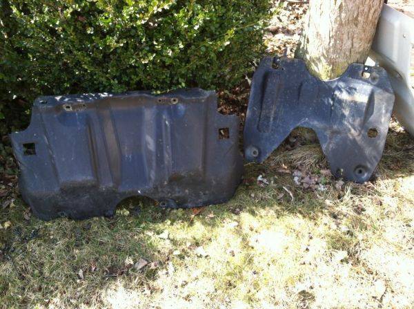

    Yes
    I have mine off right now. You should have two.

    I believe you are correct. My off road had the two "skids" as pictured above, but a friend with a sport only had the front skid. I ended up giving him the smaller one when I removed it. They are both 2010 models so things may be different for other model years, not sure.

    I can confirm that I have an 08 prerunner SR5 and even it has both of the black skids in the pic above and you do have to remove the back one (smaller one in pic above) for easy access to the oil drain plug. Go back to the dealer and demand they up one because they left it off after they changed the oil. Who cares if it was even really there to begin with or what year model trucks are different.....the dumbasses don't know they left it off so they won't know whether it had one to begin either. All they will know is that it is not there when you show them and that they changed your oil. 1 + 1 = they left it off. Make them put one back. All 6 lug trucks should have 2. If they don't then either the fuctory forget it or dealership oil change stooges left it off at some point. Haphazard non-ISO assembly quality control practices are outside the owners responsibility and should cost the company.

    OK, I pulled my 2007 brochure and the TRD Off road lists an engine skid plate and fuel tank protector, but that is not listed for the TRD Sport.
    So I don't think I ever had one, just wasn't sure since dealer screwed everything else up.

    Look at the threads where it bolts up and see if they are shiny. If they are, you had one. And the one we are talking about is not a fuel tank skid.
