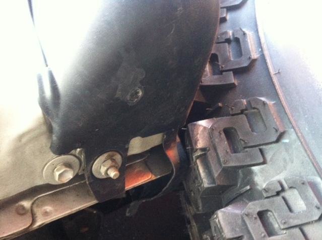

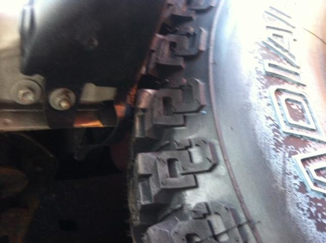

    I just bought a set of Dick Cepek FC-II's and they are 285/75/16s. I put my front wheel on first to verify they would fit and when I turn the wheel to the extreme it rubs on the inner fender. I have a 3" OME lift. I was expecting no problems. What do I do??? :eek: :eek: :confused: :confused:
    Help a fellow Tacoma lover out!!

    you clearly did zero research if you thought you could run 285's and not rub without trimming.
    Bust out the hammer and sawzall and go for it. Also, you are rubbing at normal ride height. You probably should get the suspension fully stuffed and check again with the wheels turned. You'll probably have more to trim.

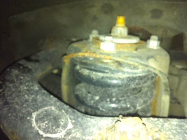

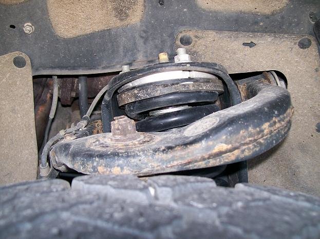

    881's ALONE will not net you 3" of lift. If you ADD a top plate spacer to the coil over you will get another .5-1.0" of lift.
    The silver disc above the coil spring in the picture below.
    82839d1278373424-1999-4runner-ome-881-89_7a0c7c8a42752dcec10f0db134f11b4b45a263ba.jpg.
    Do you currently have a top plate spacer on your truck

    It's looks like I might not have it.

    3" Toytec spacers, Bilstein 5100s in the back with add a leaf and overloads removed.
    I had a 2 or 2.5 inch spacer in mine with 285s and only rubbed on the frame at full lock.

    OME 881 1/4" top plate spacer OME Dakars OME Nitrochargers Light Racing UCA
    I'm running a 33x10.5x15 with 881 and top plate spacers. My tires clear with plenty of room. I also realize my 33" is slightly skinnier than your 285.
